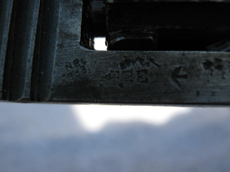

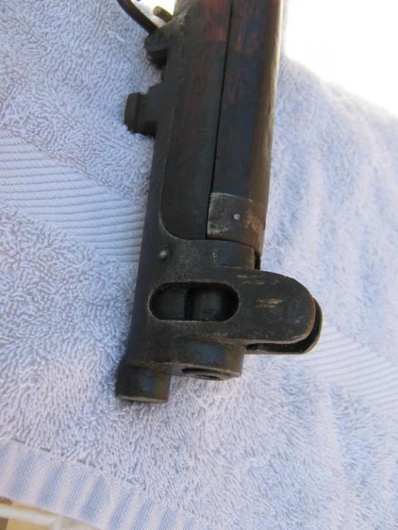

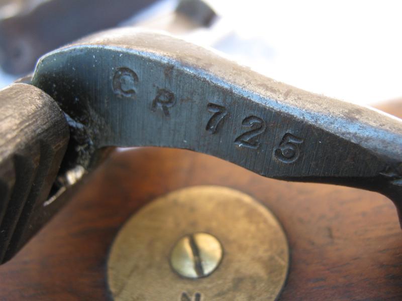

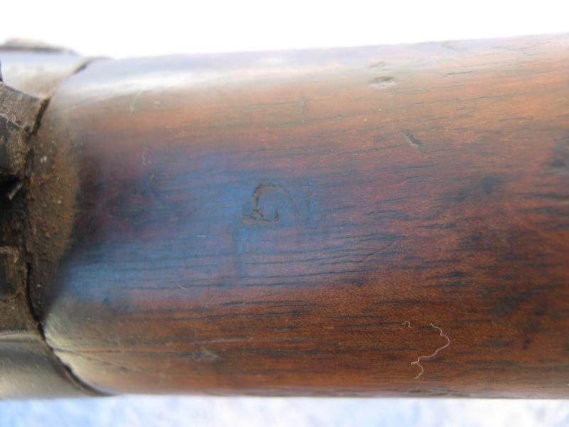

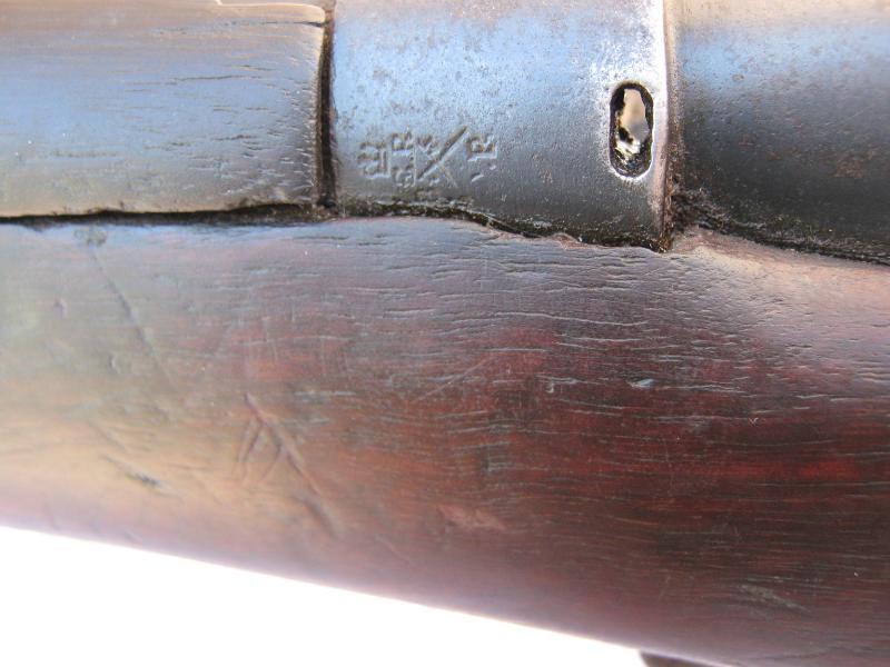

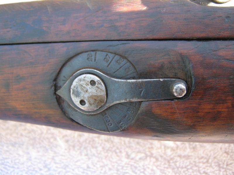

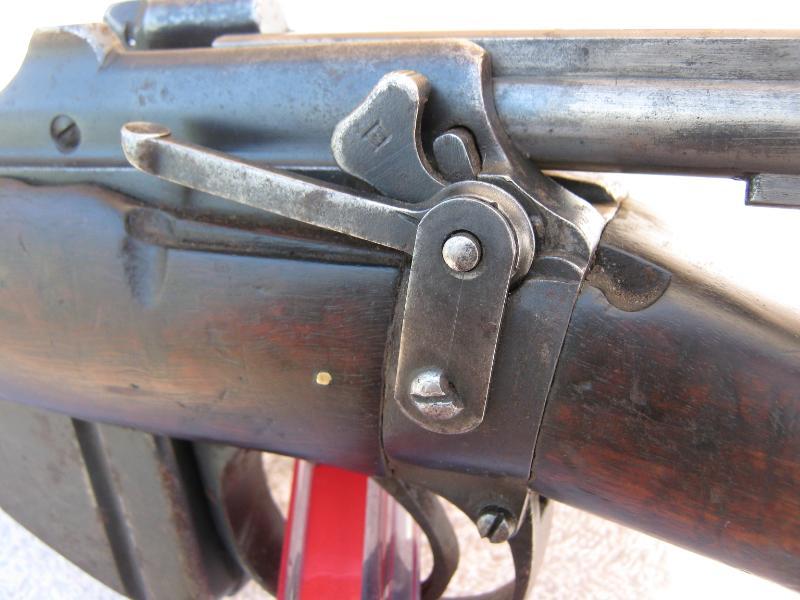

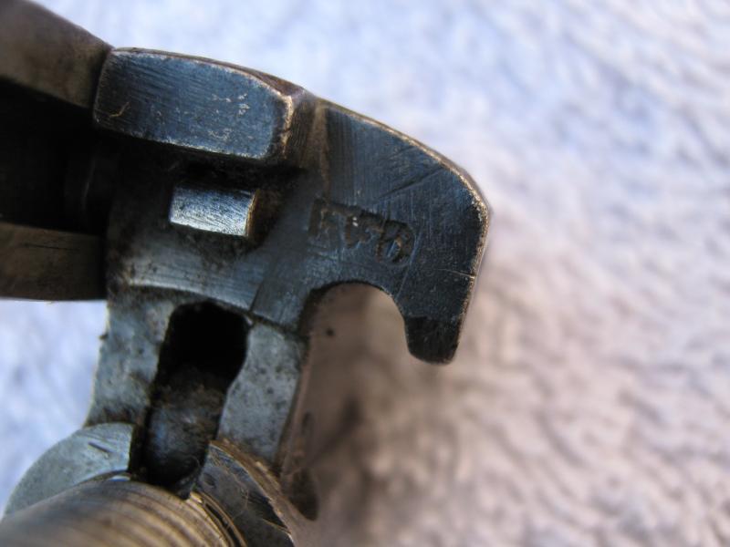

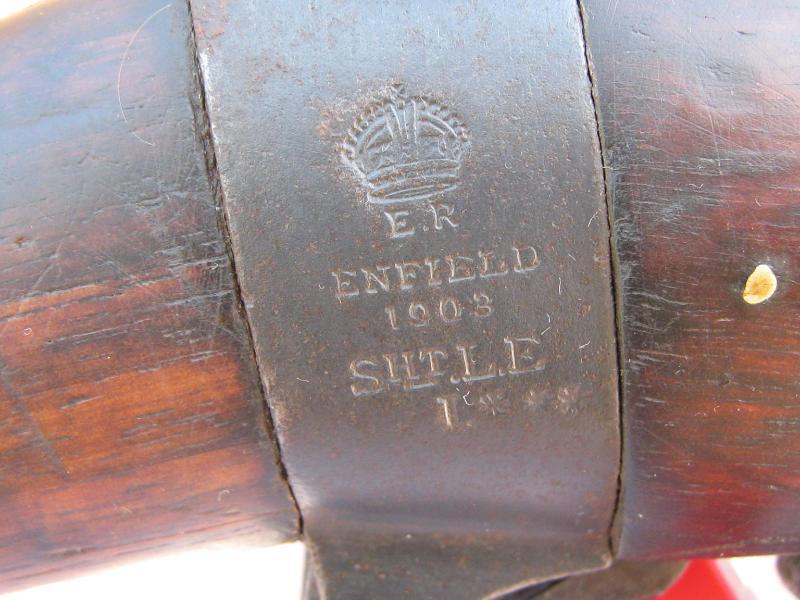

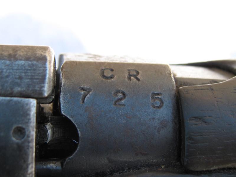

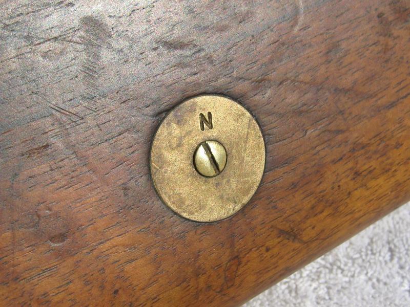

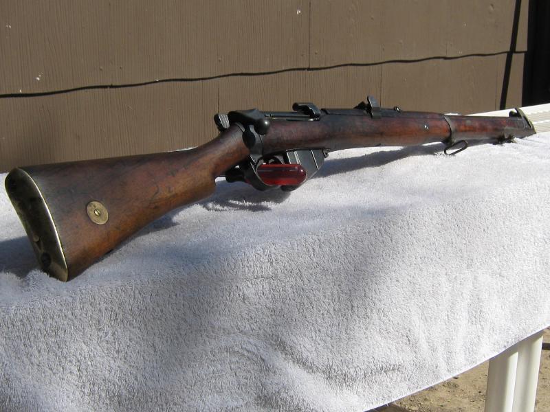

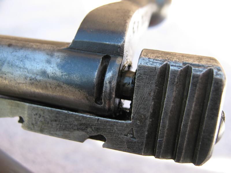

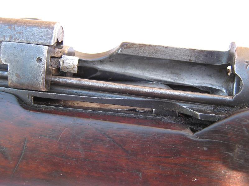

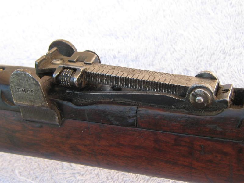

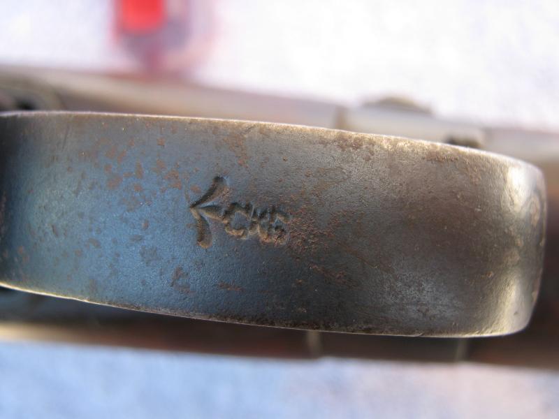

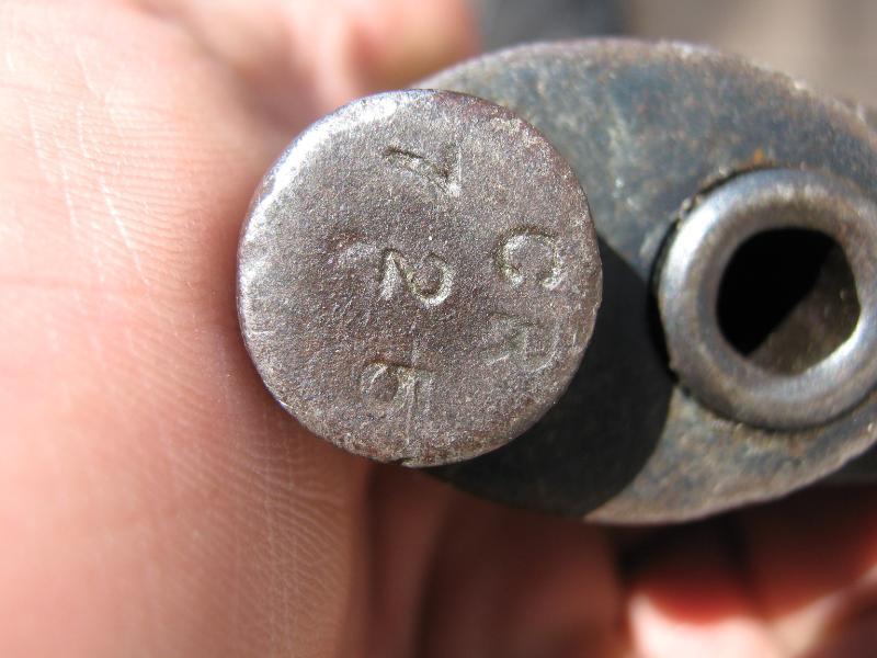

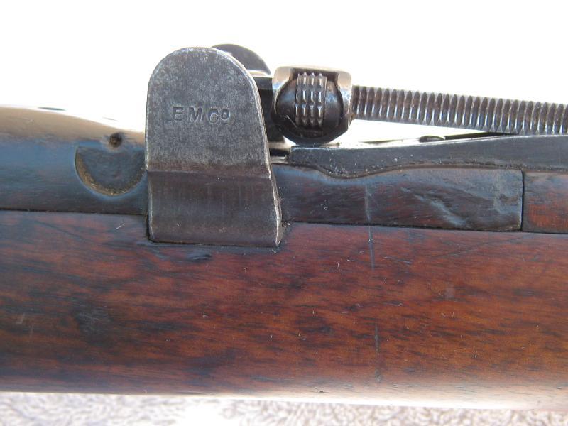

    I bought this rifle yesterday at a gun show for $135. I have a No.5 Mk1 and a Savage made No.4 Mk1 but I am just starting to gather knowledge on the early ShtLe rifles.
    I have photographed all the stamps I could find but of course I do not know what they are all about except for the maybe the Britishicon proofs. The rifle is of course dirty and looks like it will clean up okay and the bore has strong rifleing but is dark and pitted. I still think it will shoot. Has the butt plate been replaced? The buttstock is loose in the socket and I haven't been able to get the butt plate screws loose so I can tighten it up, they are stuck good.
    I worked a couple of the rustier spots with 0000 steel wool and oil and they did clean up fine.

    I'd say that you have a bit of a bargain there.

    Irish SMLE MK I***
    4015 of them were Imported by Interarms in February of 1961 directly from ireland. That is the only known import of these rifles into the US of A.
    CR indicates the rifle has the MK III sight protector added, as well as having the rear sight assembly replaced with that of a SMLE MK III*.
    I have a database of these rifles (~125 to date )and about 40 percent come up as CR rifles, the rest are ER and G marked.
    The N on the blank stock disc is a naval marking, or so I am lead to believe, this is seen on many of these rifles. Your bolt is a recycled MLE bolt, not all that common to see on these rifles.
    The WWII stamped safety spring is also seen on these rifles, many unserviceable rifles were reworked and issued during the great "emergency"in Ireland between 1939 and 1945. A large spares order from the UKicon in late 1941/early 1942 allowed this.
    Very good deal and a nice example of this type of rifle.

    Thanks for the great information fellas. Which of the marks denotes it was Irish issued?

    markings
    Most of them will have the old serial number lined out and the new serial number with the prefix of CR or ER being the Irish issue. Not sure on the G marked, photo shows a Enfield 1904 with both original serial and Irish serial lined out with the new serial G 839 (bolt is G 837). Check your barrel to find the date could still be original

    How come the rifle I have only has one serial # and no line outs?

    Your original serial number was scrubbed or removed during the rebuild
