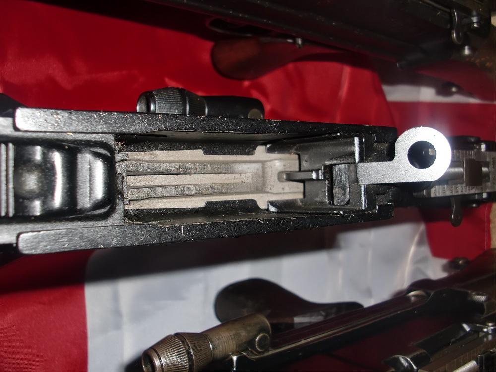

    Since this is a re-weld, I am curious as to how well the ejector block should seat. Here is my progress so far. Just curious how much more material to the receiver I should add to make a good clean fit.

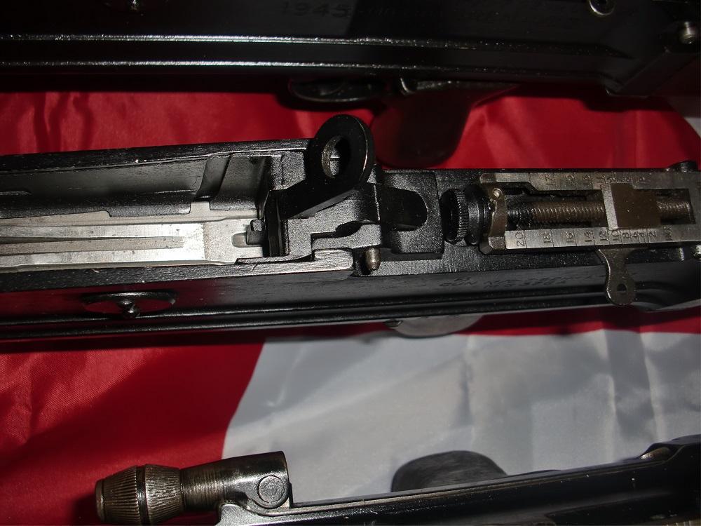

    Here are the areas of concern
    Today @ 07:16 AM
    16,523
    05-26-2024
    12:46 PM
    If the new ejector block sits on the original ledge, pulls back so as to align with the original transverse locating hole of the retaining pin, then all should be well. All of the ejectors seemed to be a 'generous' fit in the bodies, with a bit of slop.

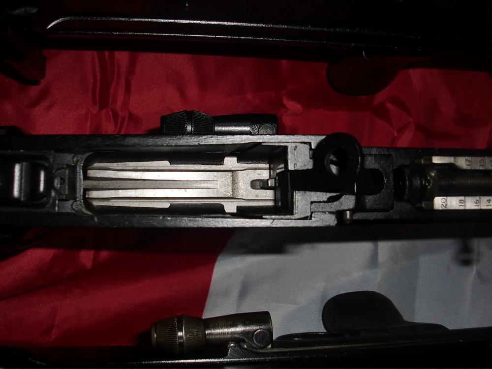

    Progress so far. Now if I can just get some reference pics for the tough part
    Today @ 07:16 AM
    16,523
    05-26-2024
    12:46 PM
    The magazine opening cover isn't right! It should slide further back and click shut on the same stop line as the old Bren. I seemk to remember that the L4A2 m.o. cover had an insert brazed in place. I only remember this because occasionally the insert used to fall out rendering the m.o.cover useless.
    It's going to be a nightmare to describe the front portion of the magazine well. I'll try by quoting a few passages of my book BUT I'd suggest that you make an appointment with someone who has an A2 onwards gun and study it in depth

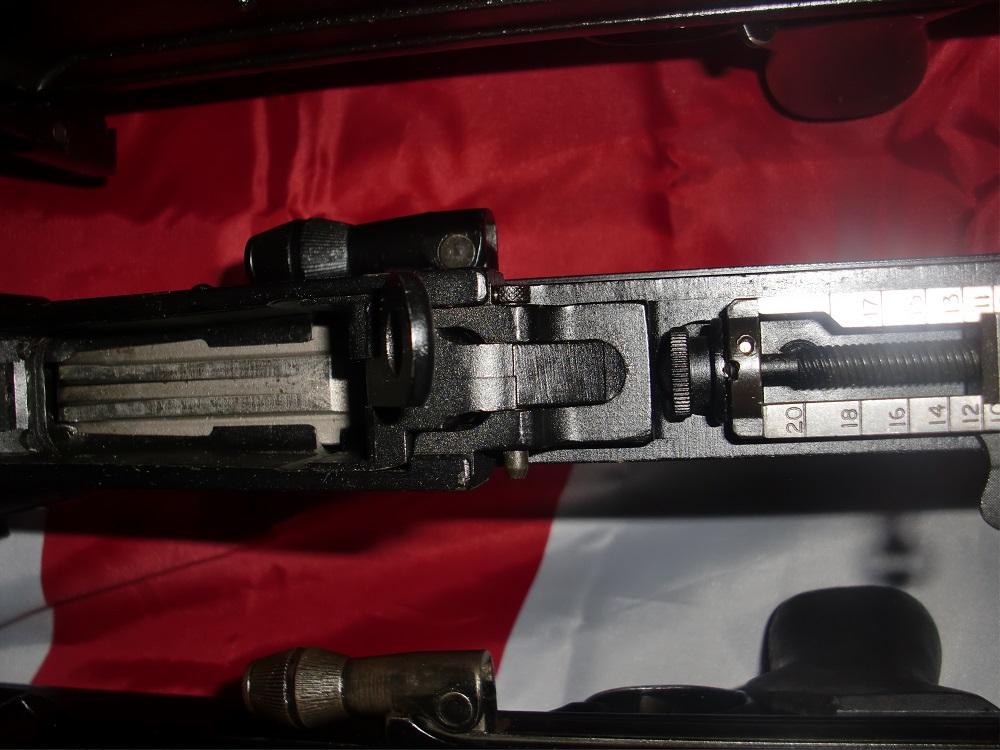

    I dont know if you will find these of any use
