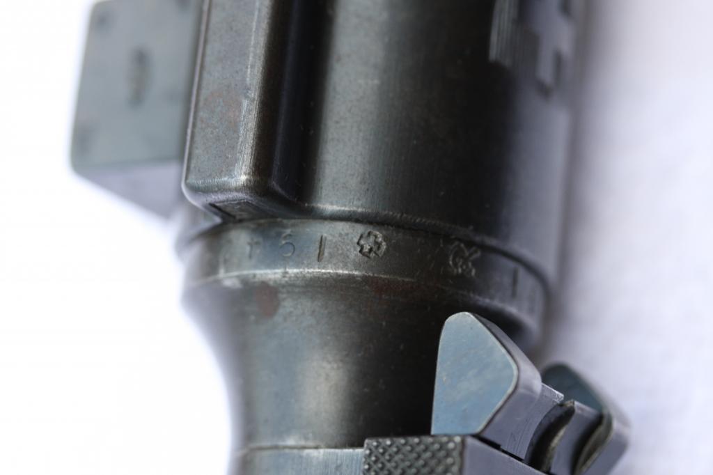

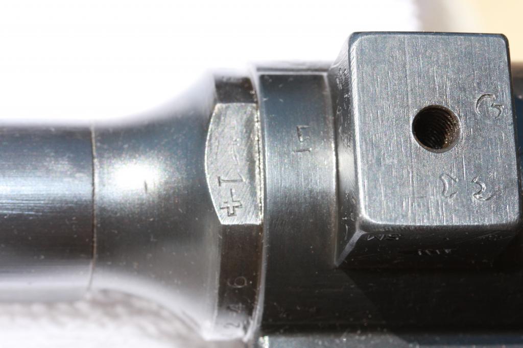

    1. The barrel and the bolt cap are dated 1942. Is this the manufacturing date because of
    a refurb or is this a manufacturing code? My guess is its a refurb barrel and bolt from
    1942.

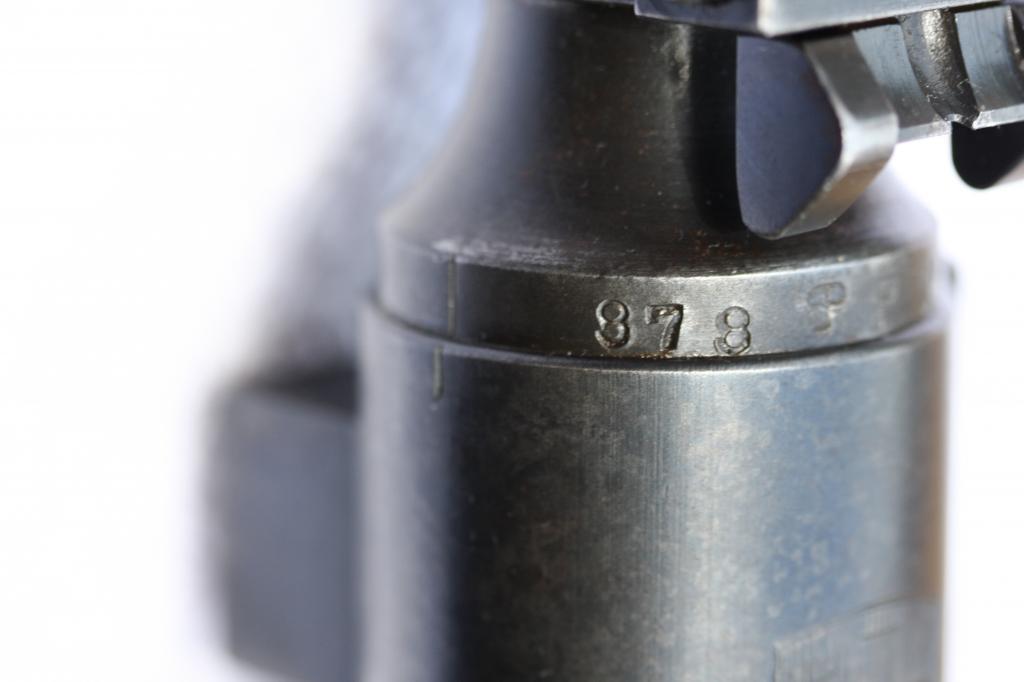

    3. There is a "P" stamped on the barrel, is this a private sale marking or just a contractors
    mark?

    Stocks are usually about a year earlier than the receivers. They have a drying time. That's not a date on the barrel. Most of the others are inspection marks. That is a date on the bolt and since your bolt serial matches is probably original to the rifle. The P typically does indicate private sale but I believe they put that in front of the serial number, not on the barrel where it is. But, that could be what it is. It matches no inspection marks I can find.

    I agree with your thoughts on the stock and rifle build dates as I posted this just for everyone's information. The markings on the barrel of 1942 just seamed odd that it matched the bolt cap. Glad you could share some incite on what this means, I feel better now knowing the barrel markings are not a date. I agree with you 100% on the location of the "P" marking I just could not find any inspectors marks that should be in that location either.
