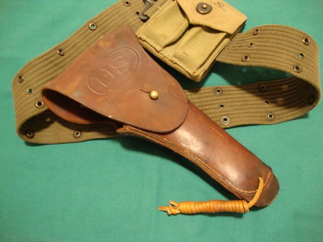

    I use Obenauf's Leather Care which has worked extremely well for me, like on this holster which was dry and starting to crack where the flap 'hinges'. Does not permanently darken or leave a greasy feel. Does not soften either so the object retains its shape. I would put it on a leather bayonet handle with no hesitation.
