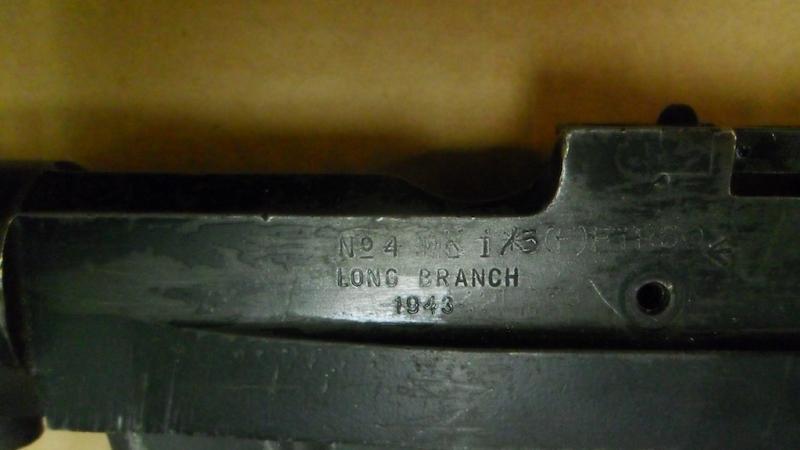

    Can you post some screenshots? especially left side of receiver where it says LongBranch , wrist stampings with its number eg nnLxxxx, bolt stamping/numbers should match the nnLxxxx on the receiver.

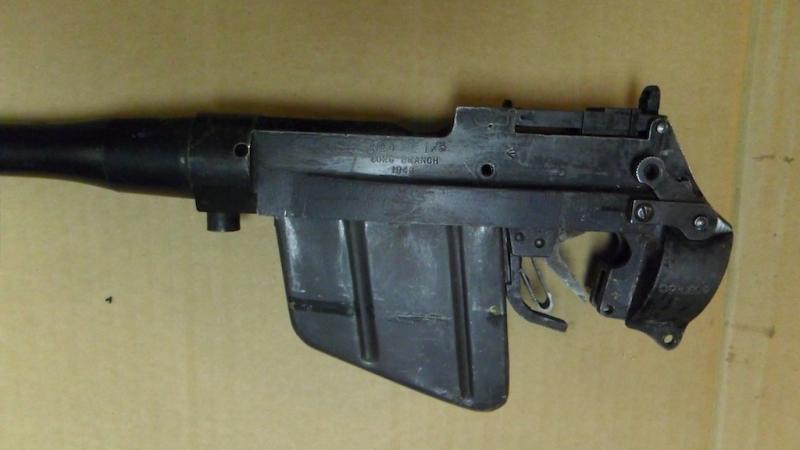

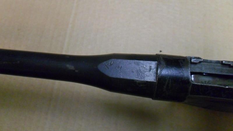

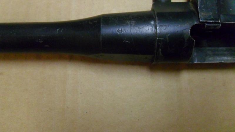

    ssj: Here are some photos of the receiver and barrel. The bolt is present, and matches the serial number of the receiver.

    maybe it is actually a no4 mk1/3? which is rarer.
    And there we have it...a Mk 1/3...

    Not only is is a Mk1/3, but it's a totally knackered Mk1/3. The bolt head guide ribs are totally ripped away forward and rear wards of the slot. Beyond repair in my opinion and ZF.
    We used to repair them with welding and I have detailed the epair method here some time ago. BUT only if they were chomped away at the corners or maybe a tad more, but that is the worst one I have ever seen.
    Fit only for scrap

    Well, that's a real disappointment! I had hoped to put this rifle back together and shoot it.Would the rifle be unsafe, or is it a cosmetic issue?
    Pardon my ignorance, but what are the bolt head guide ribs? Does anyone have a picture of what they SHOULD look like?

    If you look through the pics on here, you'll find Long Branch receivers in various poses and can gather what the guide rib should look like. It's supposed to be square and just big enough for the bolt head to fit down in.

    I don't suppose it would be unsafe as such but it's a tad more that cosmetic. The bolt head tripping out of the track on its way forward will damage the track and breech opening even more and rearwards, well......., it's already totally knackered*
