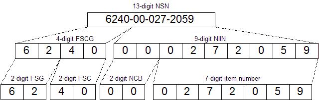

    A slightly different to the norm Bren mag tin which I acquired recently has the stencilled identification markings on the back of the tin and not on the front as is usual. The tin has a dispersal code of M/202 with Broad Arrow acceptance markings stamped on the front of the tin and so is of Britishicon wartime origin. The black stencilled markings reads thus: A500-00-06094 with just BOX BREN below. This tin takes the standard .303 mag and I'm guessing that the number is a Nato number but I am not sure?
  13. #8
    Dec 2015
    02-07-2022 @ 11:09 AM
    Edmonton, AB, Canada
    1,057
    Darren
    06-01-2024
    07:29 PM
    That isn't quite the right format for Nato Stock Numbers, might be one of the older stocking systems though.
