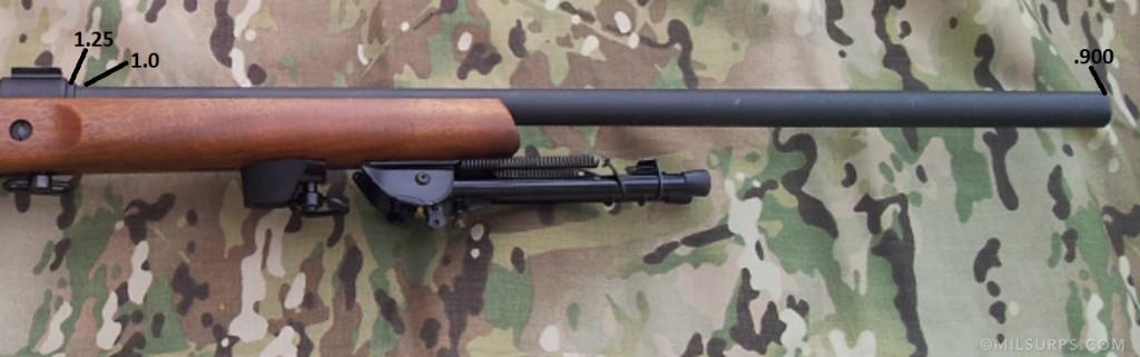

    Thanks for the quick response. I'm going to go with a 26" 1:10 barrel then. With respect to the barrel contour, is the contour in the attached pic close enough?

    Quote Originally Posted by Bladerunner View Post
    Cheers.
    https://www.milsurps.com/vbpgimage.p...7&d=1474678074
    The c3a1 barrel I measured was. 955" at the torque shoulder tapering to. 900"

    Thanks. That's a pretty insignificant taper over 26".
    Interestingly I've been told that one c3a1 barrel measured recently was swamped, ie) tapered to about the mid section, and then reverse tapered to the muzzle.
