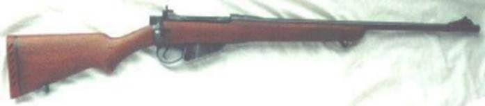

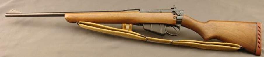

In the mid- to late-1950s, an interesting variant of the No. 4 Mk I* was produced in Canada by the firm of Essential Agencies Limited (E.A.L.) of Toronto. Several thousand were manufactured, and at least 1000 were purchased by the Canadian government and issued to the Royal Canadian Air Force for use as a survival rifle, and to the Canadian Northern Rangers for use as a standard longarm. This variant is a "sporter" version of the Long Branch military rifle, but it is NOT a "sporterized" No. 4 Mk I*--it is a newly-manufactured rifle! This variant of the No. 4 rifle is generally referred to as the "E.A.L. Rifle."
Within the past five years, 19 E.A.L. Rifles have been shipped to military repair depots, all coming from Ranger units in the Northwest Territories. In addition, quite a few E.A.L. Rifles have turned up here and there and have been snapped up by collectors. It is not clear how many E.A.L. Rifles are still in existence.

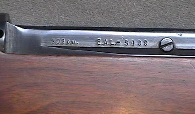

The major distinguishing features of the E.A.L. Rifle are a full-pistol-grip buttstock with a rubber recoil pad, a shortened and slimmed down fore-end with a Schnabel tip, a shortened barrel, and a heavily modified action body. The charger bridge and most of the top portions of the action body are milled away, leaving only the base for the backsight axis pin. The action body and other metal parts are polished and blued rather than oil-blackened. The E.A.L. Rifle is also distinguished by its action body markings. A second style of marking has been observed, having no caliber designation and no periods after the letters: "EAL 2580".

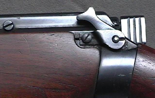

The E.A.L. Rifle is found in both civilian and military models. The civilian models are serial numbered in the range of 2000 to 5000, while the military models are numbered in the 6000 to 6999 range. The civilian models have 10-round magazines and military Mk II (two-position flip-type) rear sights, while the military models have 5-round magazines and an express-type rear sight with two folding blades. Also, the civilian models have ramp-type front sights with bead-type blades, while the military models have standard military front sights. Military models have been observed with holes drilled and tapped for Parker Hale scope mounts, and at least one military model exists mounted with a Tasco 4x scope. The wrists of the military model buttstocks bear military acceptance proofs.

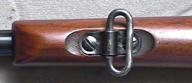

Front Sling Swivel - Stamped style sling swivel recessed into the fore-end.

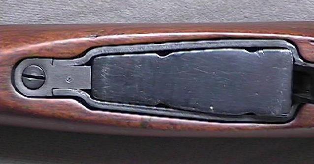

Magazine and Trigger Guard - Unique to the E.A.L. Rifle, the breach cover loop has been omitted. This particular rifle is fitted with a military pattern 5 round magazine.

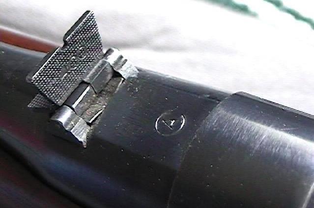

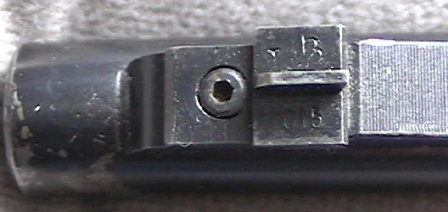

Rear Sight - The express type two position rear sight mounted to the barrel at the knox form indicates that this rifle was built for the Canadian military. Note the clear CA (Canadian Arsenals) stamping on the knox form.
Receiver Markings - Notice the shortened receiver wall.

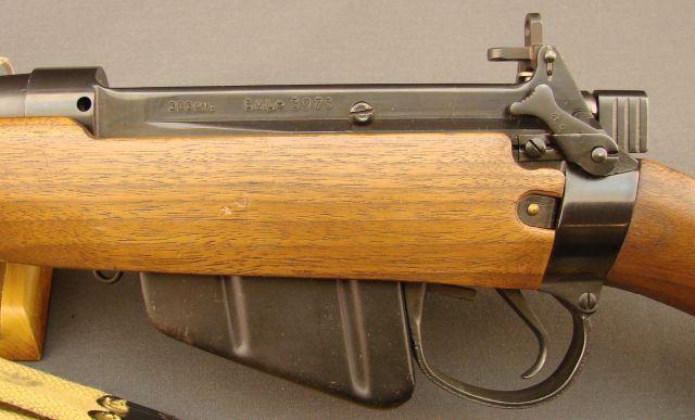

Commercial Variant - The commercial version of the EAL Rifle was produced using the standard military MkII backsight (two position flip) and a standard 10 round magazine.
Close-up of the Mark II rear sight and 10 round magazine.
