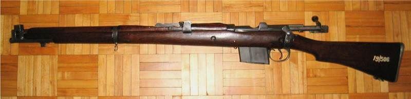

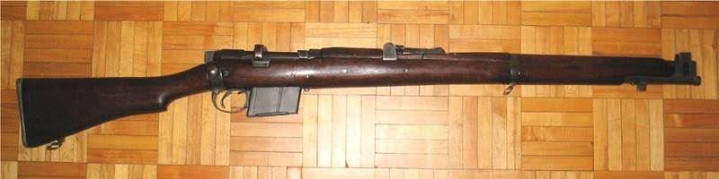

1969 Ishapore Rifle Factory (India) 2A1. Images courtesy of Deborah Peel
India, one of the last countries to retain the Lee-Enfield as a front line service rifle, discovered in the early 60's that the bolt action rifle was no match for modern self-loading assault rifles. With this in mind India set out to replace the aging SMLE with the more modern 7.62 x 51mm FN FAL, designated by India as the 1A rifle. Cost conscious, India resolved to issue the new 1A rifle to its front line troops while retaining the No1 for its reserve forces, the Territorial Army. Understanding supply and logistics, what was desired was to re-chamber the No1 for the 7.62mm round, unfortunately chamber pressures for the 7.62mm was beyond the acceptable limits of the No1 receiver.
In the interest of economy the Indian government decided to retain the production facilities for the No1 rifle located at the Ishapore plant and embark on an ingenious program of re-vitalizing the No1 design. Using high-grade steel and advanced heat treating, brand new receivers and barrels were manufactured capable of safely chambering and firing the 7.62mm round. Changes were also made to the magazine; bolthead extractor; ejector and buttstock, all combined to produce a brand new rifle. Officially designated the 2A Rifle and quickly followed by the 2A1 Rifle which incorporated only a change in the range scale of its rear sight with no other alterations. The Ishapore 2A and 2A1 was never intended as a front line service rifle but as a reserve and training weapon, the training part suggests any found on the surplus market may well have indeed been well used.
