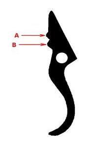

TRIGGER PULL
The Lee being a typical military rifle, it has the standard 2-stage trigger pull. This trigger pull was implemented mostly for an added safety feature, in the rough and tumble atmosphere of the battlefield one does not want a "hair-trigger". You dodn't want to knock your rifle while "going-to-ground" and inadvertently shoot your section mate, yet the tactical situation did not make applying the safety, a smart idea either. Conversely, while in a defensive position, under strict "open fire policy" you didn't want the thing going off when you threw it up on the trench ledge. However when the time came to loose off a round, adrenaline reduced both trigger pull and let-off to a mere caress, or so it felt. Because we do our shooting on the range under controlled conditions and the most menacing thing that may occur is the odd hot spent casing rolling next to our forearm, trigger pull is a little more noticeable. Here are the instructions to adjust this to more accuracy friendly levels. The standard Lee-Enfield has a very noticeable "first" and "second" stage pull. These pulls cannot be completely eliminated but they may be adjusted. It is up to the shooters own preference, which he/she would prefer, a long first stage or a long second stage or reduce both in length. The length of these pulls are adjusted by altering (filing) the height of the trigger ribs. See figure 1A & B. During alteration the shape of these ribs should be maintained and for any testing of the trigger pulls, the rifle should be fully assembled ensuring that the triggerguard is correctly installed and tightened into place. NOTE: this procedure should only be attempted AFTER the fore end has been correctly bedded to the receiver and barrel, because the position of the triggerguard depends on the fit of the fore end. The only exception to this is on the Mk2 rifle where the trigger is pinned to the receiver proper. By decreasing the height of Rib A the length of the first pull is increased. By decreasing the height of Rib B the length of the second pull is increased. I would strongly recommend that, if you wish to experiment with these pull lengths, you purchase a second trigger for your Lee. Reason being, once the ribs have been filed down, there is no putting it back. One should approach this modification with patience and only reduce amounts slowly. Take the time to re-assemble the fore end and triggerguard often to check your progress. Once you have a trigger pull that suits your needs a final polishing of the ribs using fine grade emery cloth and crocus cloth will smooth it out nicely.
Figure 1
TRIGGER PULL WEIGHT or LET-OFF
Perhaps the most important of the aspect of fine tuning any rifle is the pull weight of it's trigger. The army technical orders dictates that the Lee trigger be adjusted to provide a 3 to4 lb first stage and a 5 to 7 lb pull on the second stage. Once again this is fine for a stock infantrymans rifle, but lacks a little when it comes down to precision placement of rounds. So following here is the instructions to lighten those trigger pulls. IMPORTANT: The act of adjusting this trigger involves removing metal, it cannot be replaced, so go slow. Also, because the sear bent is being altered (stoned down).f Adjusting the let-off on the Lee is accomplished by altering the angle of the cocking piece bent. See figure 2a. To decrease the amount of pull weight, the angle of the sear bent is increased and conversely, to increase the weight the angle is decreased. This job is best done with the bolt disassembled, but can be accomplished while the bolt is intact if the individual is careful. It will take a steady hand, patience and a honing stone. If the job is done with the bolt assembled, rap the body of the bolt with some duct tape (to prevent scratching when the stone is drawn across the sear bent) and secure the bolt in a bench vise, use some hardwood pads for the jaws. Then carefully draw the stone across the sear bent, angled slightly to alter the bent angle. Stop often and assemble the bolt in the rifle and using a fish scale check the pull-off weight. Patience is a virtue when tackling this job. Once a let-off weight that suits the shooter has been achieved, draw the stone in the direction of the sear travel to smooth the trigger operation and finish with a light polish some crocus cloth.
Figure 2
