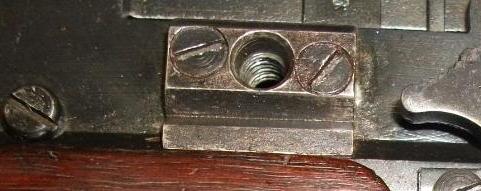

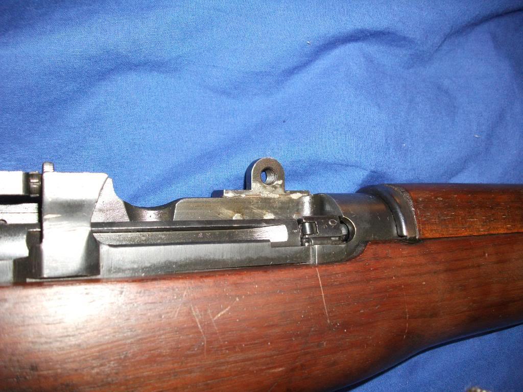

    Another LB:
    Haven't got much else detail photo'd in these areas, yet.
    The funny thing is that there is a S/N list for these rifles. Just not published. Hopefully one day!
