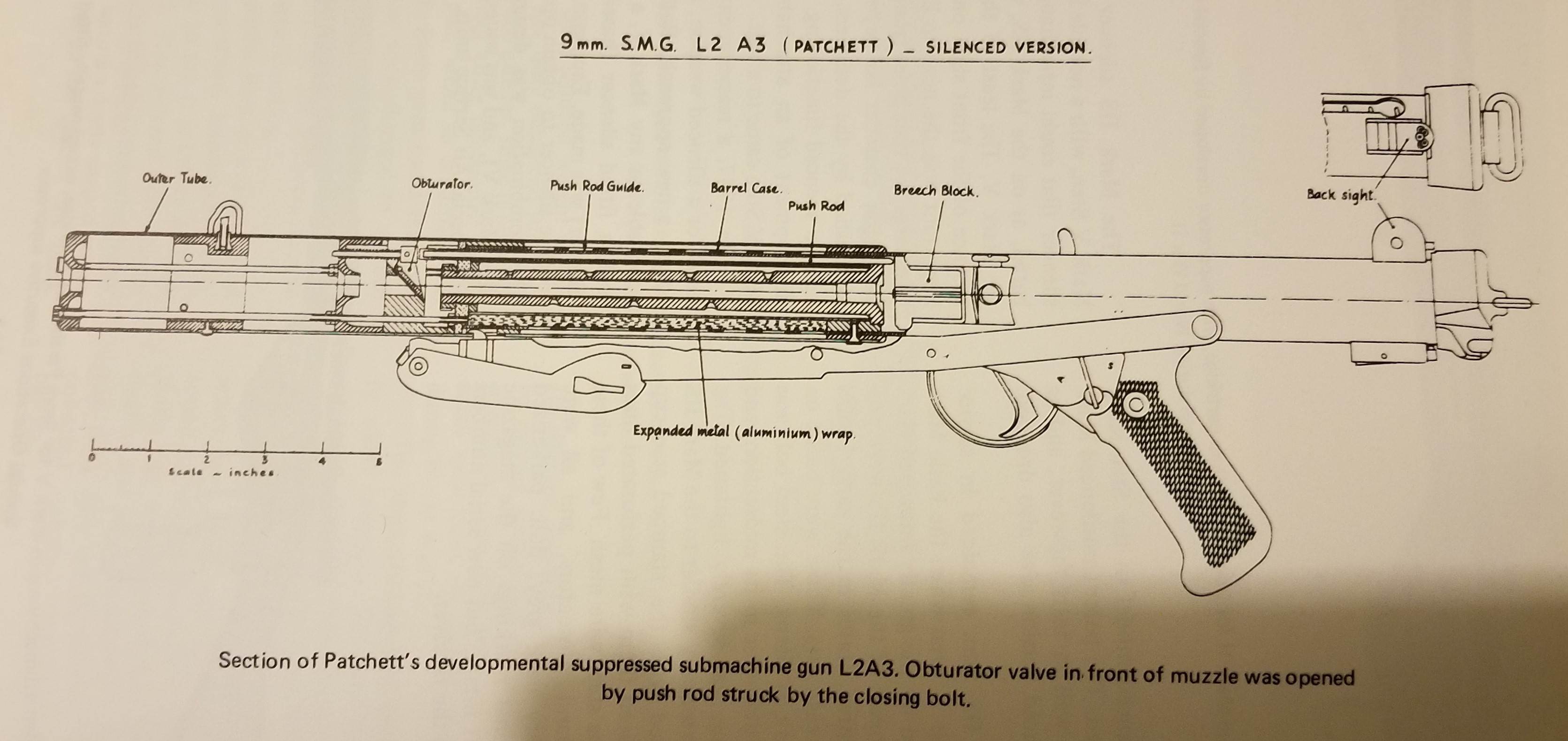

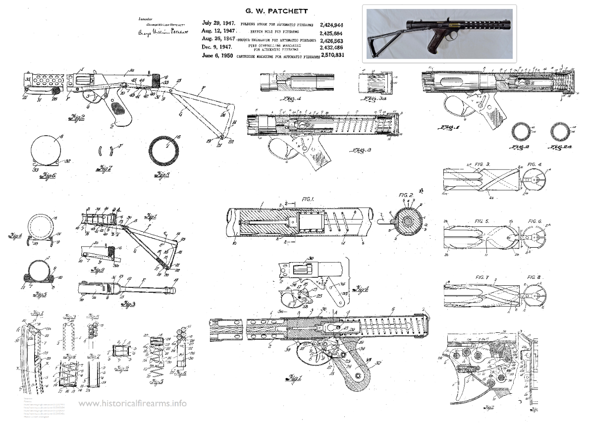

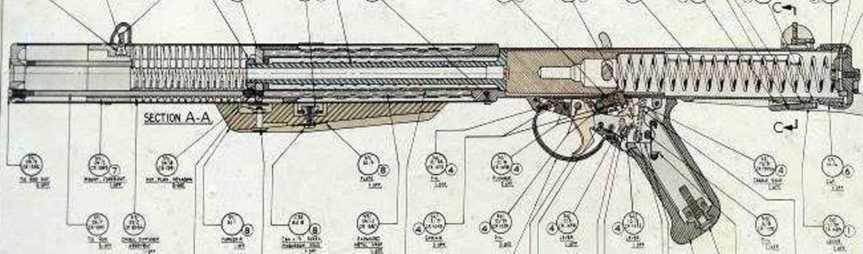

    Quote Originally Posted by Vincent View Post
    Yes, it would be nice to see the suppressor internals.
    Did you see the Mk5
    Did you see the Mk5
    Centrefire automatic silenced submachine gun - Sterling Patchett Mk.5 (L34A1), skeleton (about 1967-1993) - Royal Armouries collections
    There is a line drawing in c. 1978 Small Arms of the World which is also in Nelson & Lockhoven IIRC, it shows the ["current" baffle stack e.t.a This is wrong from review of the drawings] with a piston passing thru the top of the baffle stack and flapper (presumably located where the screws on either side of the casing below the front sight).
    Pachett L2A3 Silenced Version
    Sterling L34A1 / Mk5
    So the pictures in Small Arms of the World are of the L34 type baffle system. The line drawings of both are in "the World's Machine pistols and Submachine Guns" by Nelson and Musgrave. printed 1980 and still one of the best reference books available. The whole series (starting in 1963) is highly recommended.
    Attachment 95544
    It appears to only have a single reflex type baffle, similar in concept to the end cap. The space between the baffle and the front sight housing appears to have space for several more baffles.
    Attachment 95545
    Attachment 95547
    Attachment 95546

    The push-rod actuator system shown above was doomed to failure from the word go. Within a few rounds the rod and its mechanism would/will foul up with carbon. The muzzle cap designed by Patchett is also an important feature of the L34/Mk5. Can I presume that everyone knows about this important feature before I say it again?
    The short one, not sanctioned by Patchett for audible reasons didn't leave space.volume for a mathematical formula to operate effectively so was never(?) an available option. But there are reports that some were '.....supplied'
