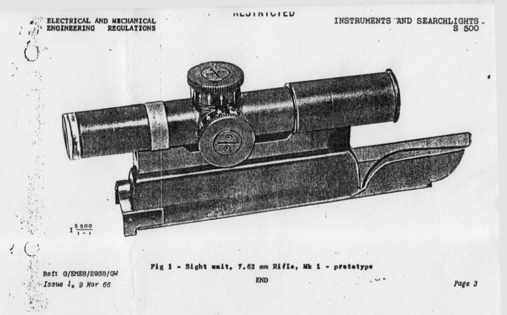

    Morning Gil, Pete pointed out that one of the issues was the typical one regarding optics and mounts spot welded to the cover.
    Basically the mount would inevitably detach before long as the spot welds failed under recoil.
    I would imagine two things put paid to the No74 MK1, first and most obvious, the rifle isn't capable of the accuracy required in a dedicated Sniper rifle, second, the mounting system was funimentally flawed.
    The second issue could have been avoided if they manufactured a top cover with a slightly raised ( so avoiding the reciprocating bolt group) flat platform formed into it, allowing it to be screwd or bolted through. The downside here, is it would mean the scope mounted even higher......
    The No74 itself is a really nice,well thought out little scope though.

    It's funny how you don't immediately see what's staring you in the face....
    Looking at the image of the prototype No74 scope, it's obvious that the mounting system discussed earlier is exactly what they originally envisioned.
    It's not possible to see how this has been constructed dur the limitations of the image, but it appears to be much more robust mounting base.
    Perhaps a separate prototype dust cover?
    I assume the bean counters got involved and insisted on a mount assembled to a standard top cover, probably dooming it to failure...
    That dust cover resembles the one issued for our AN PVS 502. It was a huge hollow affair with two holes at top for screws to attach the rail. Not much better than spot welds.
    The prototype illustrated appears to be mounted on a modified X8E2 (Ex2) unit sight top cover.
    https://www.forgottenweapons.com/x8e1-x8e2-slr-manual/
    The extended scope base, addition of the locking tabs to the rear and deletion of the front locating pin.
