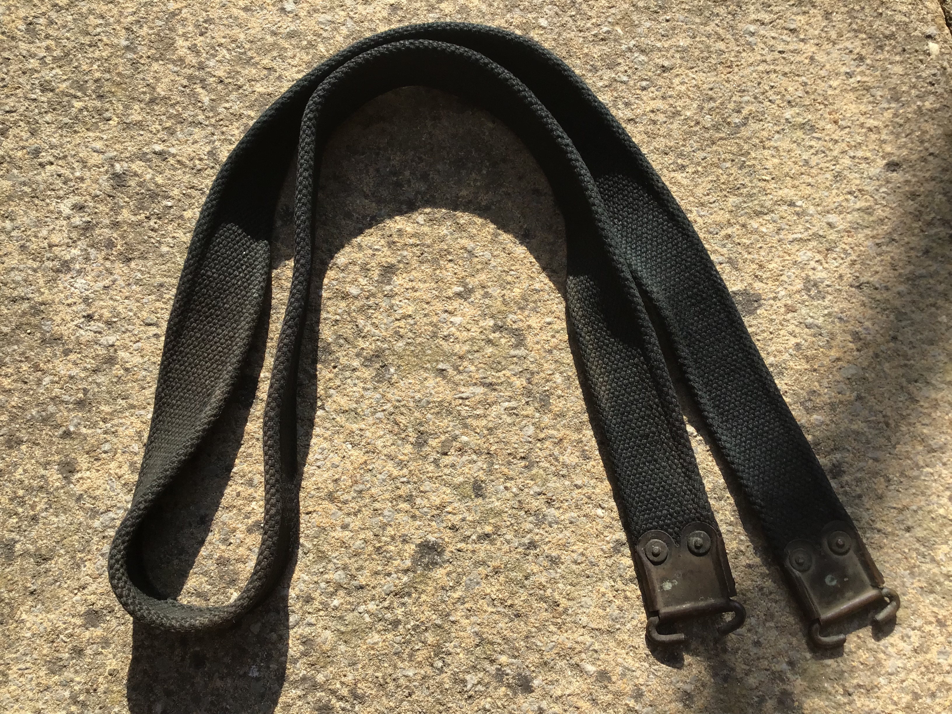

    Thanks. This is how it started and I think that helped bring the price down.
    I’ve done the same thing in the past with other dyed black Britishicon webbing such as a 1908 Pattern haversack, a 1908 Pattern bayonet frog and a 1919 Pattern cutlass frog.

    I have successfully removed paint from webbing in the past by blasting it at point blank range with a pressure washer.
    BUT it’s not a cost free exercise. It also strips out the khaki dye on the surface leaving it very pale necessitating a recolour with khaki blanco. I did this on two 1937 Pattern ammunition pouches and the end result was a great improvement, but it didn’t return them to their exact original unpainted appearance.
    The webbing also needs to be strong and undamaged to cope with the pressure. I also attempted to take some white paint off a 1908 Pattern frog and it basically blasted apart when the water jet hit a patch of rotted webbing under the paint…

    Just finished working on 15 slings I bought as a bit of a pig in a poke. About half were dyed or painted and about a third are longer, presumably Bren slings. All unmarked on the brass.
    I tried a bath of Rit Color Remover and it took some of the color out, but not nearly enough. My blue/black slings are mainly still blue/black though one looks like it has a disease of some kind as it's a bit blotchier now.
    Working on the rust stains next........
    On entering boys service in 1966 we were all issued with new 37 Pattern webbing (except rifle slings which were kept in the armoury) the next step was to dye them black with a commercial dye; the smell has stayed with me to this day!
    Once dyed black we then used Kiwi boot polish to give the webbing a deeper shiny black, those of us lucky enough to find we had been issued with webbing that contained black metal buckles were then told to exchange them for brass buckled webbing and repeat the dye and boot polish regime.
    Garandy, is it any wonder the black is difficult to remove!
    It all depends on what was applied to the webbing in the first place as to what can be removed now. Sometimes all that is required is water and a nailbrush.
    I do have several tins of what I believe was marketed as an alternative to blanco and which I believe had the consistency similar to boot polish. I've not opened the tins but I think once it was applied to webbing it was on there for good.
