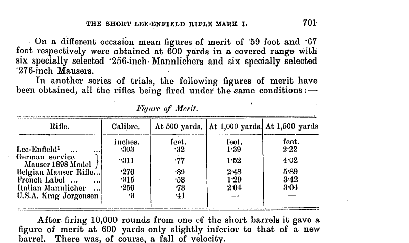

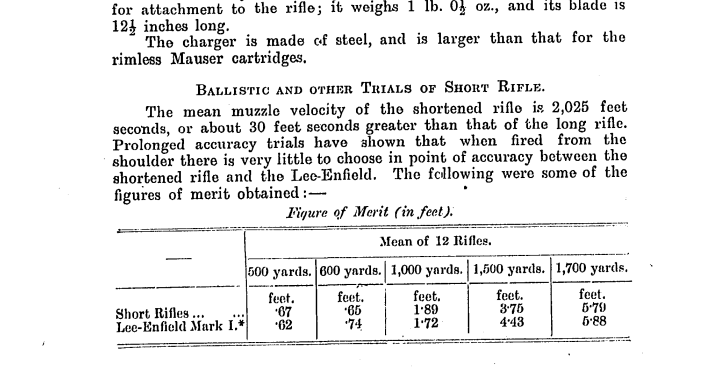

    It is interesting to see the comparison of the FoM for the "Long Rifle" rifle compared with the SMLE which were recorded in 1904 during the SMLE trials.
    Comparisons were also taken with rifles used by other countries.
Name:	Screenshot (2289).png‎
ID:	139169   Click image for larger version
Name:	Screenshot (2859).png‎
