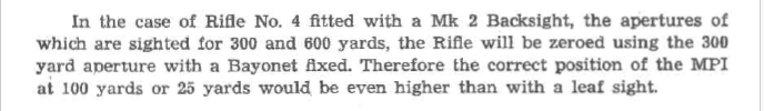

    Quote Originally Posted by Rick View Post
    (How could anyone NOT have a proper bayonet for their No. 4 rifle? How else could you zero!)
    Reading thru the "Techincal Training School REME" Document "Zeroing of Rifles" I note that the use of the bayonet for zeroing is limited the the No4 rifle with the Mk2 rear sight.
    No mention of bayonet use for the other Mks of rear sight.
Name:	Screenshot (2877).png‎
    Thanks Alan; I'm pretty restricted on a loaner laptop, with my computer undergoing triage and hopefully repair since it thundered in about four days ago.
    Without access to all my files and saved data, I think all the Brit pams from the war years i.e. the 1940's only specified bayonet fixed for the No. 4 rifle, but also did not specify any differences to what Mk of rear sight might be on the rifles i.e. the other models with an adjustable slide versus that two position sight.
    I do know from memory that the second volume of the 1950 Armourers Wing Precis contains the table you see multiple times in related REME documents, where there are two fields for the No. 4 rifle; one with the Mk 2 back sight and another field for when it is one of the other backsights mounted on the rifle.
    The zeroing data anomaly aside concerning the Canadianicon pam, I'm equally as intrigued that the wartime Higher Niner Puzzle Palace decided the best conditions for zeroing the new No. 4 infantryman's weapon would be with bayonet fixed at 300 yards.
