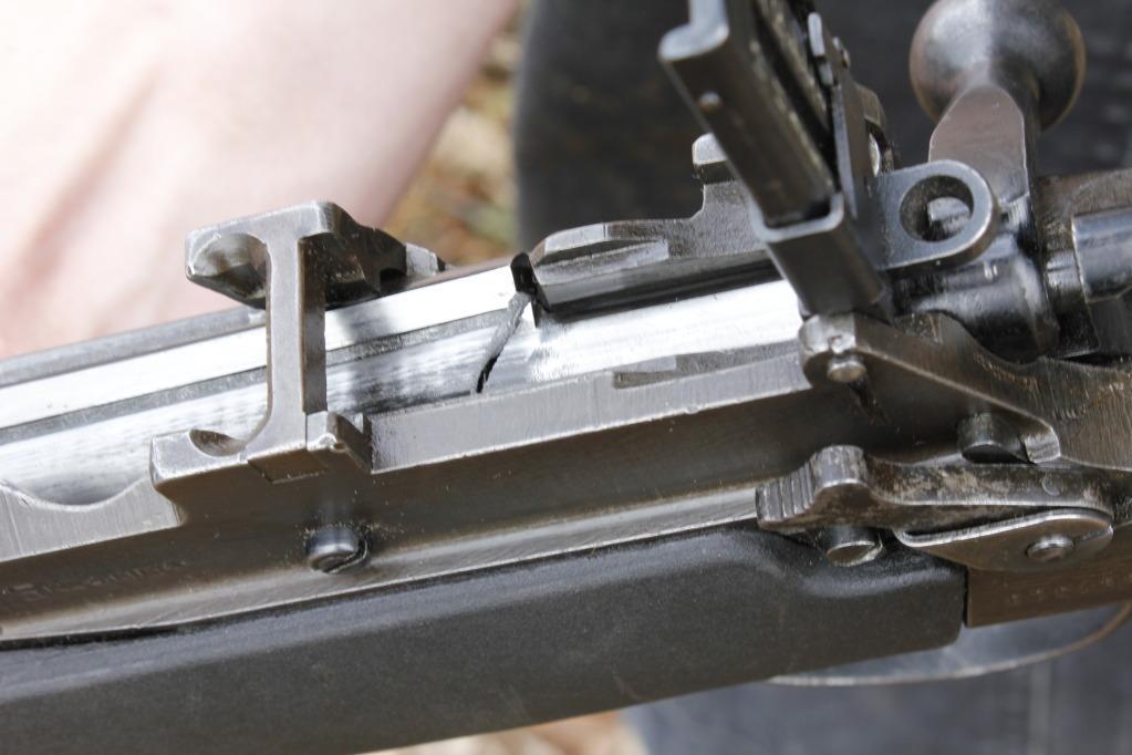

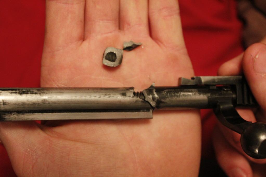

    No, I don't think so - In the past I have read reports of SMLE sidewalls fracturing.
    I think the examples of fractured bolts has generally been found to be poorly cast (granulated) steel in the bolt body.

    A couple of pics of fractured No4 rifles

    A d E
    that photo is a good reminder of why Lithgowicon would not convert N1 Mk3s to 7.62.

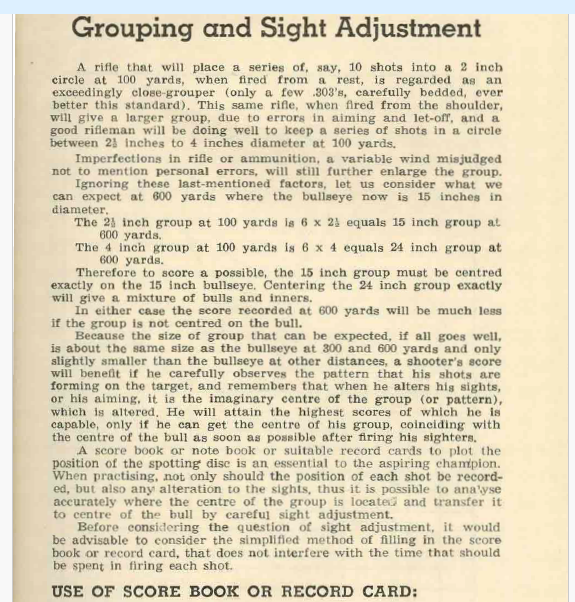

    Rick - there is a lot of 'good stuff' on 303 accuracy and sighting in this book 13Mb and 100+ pages (do you have it ?)
