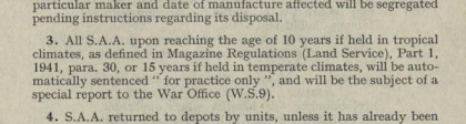

    Quote Originally Posted by Bindi2 View Post
    The Military moved the ammo on after a set time if not used. You don't know how well it was stored after leaving the Military.
    Indeed, the Britishicon military withdrew all ammunition from 'front line use' once it reached 10 years old. After 10 years (stored on the tropics) or 15 years (stored in temperate climates) it could / did become inconsistent - particularly the primers - and it was relegated to 'practice use only' on the ranges.
    You (we) are now using 50+ year old ammunition and wonder why it, smokes a bit, pierces the odd primer, splits the odd case etc etc.
    When using old milsurp ammunition - set yourself up with low expectations and you will not then be dissapointed.
