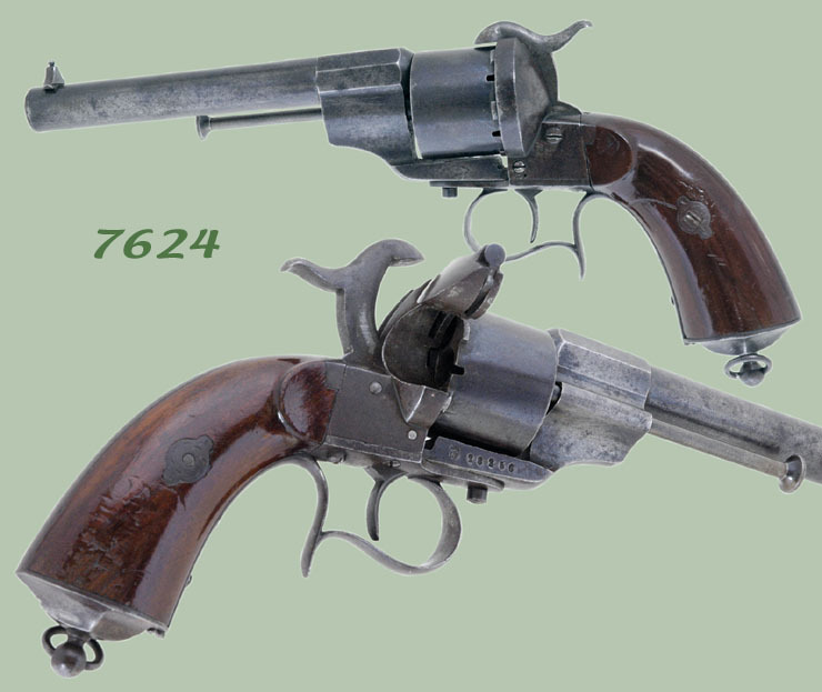

    Thanks for all the info guys. I poked around the net and came up with this. It bears some striking resemblances:
    "Frenchicon Model 1854 LeFaucheux Pinfire Revolver
    Antique Arms and Collectable Blades Classified Ads11mm., 6 1/8" barrel. Bluedfinish. Spur trigger guard.Rosewood grips. Lanyard ring. Retainstraces of blue finish on cylinder, the remaining areas with gray-brownaged patina. Grips retainapproximately 85-90% varnish. Actiontight and crisp. TheseEuropean pinfire revolvers were often imported and used by Unionofficers during the Civil War. Afine condition large pinfire revolver.Ser. # 28256."
    Today @ 07:52 AM
    Central Ontario
    79
    1,121
    05-24-2025
    08:51 AM
    IF the revolver is a Model 1854 Frenchicon service revolver - I wonder if there is any possibility that it got to Mexico when the French tried to occupy the country.
    (Founding Partner)
    Site Founder
    Claven2's Avatar
    Yesterday @ 02:53 PM
    Scandaltown, Ontario
    3,288
    Ronald
    05-24-2025
    08:51 AM
    Hard to tell from the small pic, but they certainly look the same. My money is that you've nailed the model - though it might just be a Spanish Belgian or Mexican knock-off of the Frenchicon weapon.
