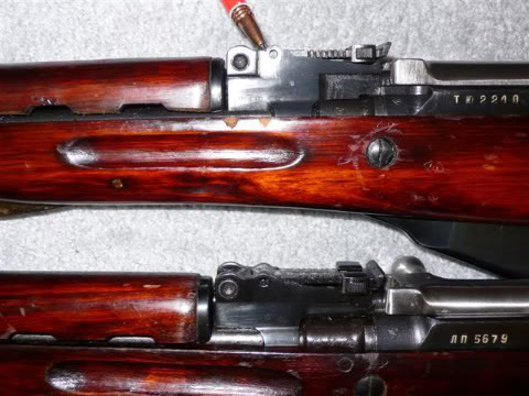

    a. Production classification-Receiver. The quickest way to identify the two types of receivers is to look at where the receiver meets the barrel, just below the extension rod tunnel. The early production has a small milled step. There are other differences but they are covered by the wood stock.
    -Early production. 1949 - part1952. (below pic, top).
    -Late production. Part1952 - early1956. Has no mill step (below pic, bottom), see where the pen is pointing.

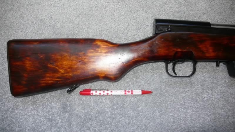

    o. Wood stock. SKS45 came in two types of stock, solid arctic birch hardwood and laminated.
    -Arctic birch. 1949 - late1955 (below pic, top).
    The original stock was made of solid arctic birch hardwood coated in oil, subsequently changed to shellac, the appearance is reddish/dark brown/lighter brown blotchy looking. This type of wood had a tendency to split at the grip, they solved the problem by replacing the arctic birch with laminated on the assembly line towards the end of production.

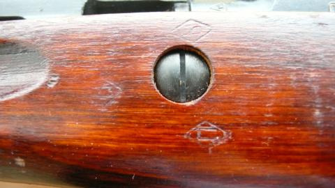

    The markings are located on the left side of the stock, similar to the top cover, there is a factory mark, a production date and serial numbers.
    It appears back in the 50s, large pieces of solid birch were not plentiful, this would explain why some of the buttstock had pieces attached to the toe, although it looks like a refurb (see below) but in fact its not. Its just the frugal Russian has found a way not to waste short pieces of solid birch.
    Here is the proof, on the above right pic. The middle and right stocks are the standard solid birch and laminated stocks, you will notice they have lightening holes drilled into them, just below the cleaning kit hole. The left stock has the added piece glued to the toe but it doesn't have the lightening drill hole, indicating the stock were never used before.
    -Laminated. Late1955 - early1956. Also used during refurbishing work (below pic, bottom).
    There are many advantages to switching to laminated, from a manufacturing point of view, changing the process rather than changing the material allowed them to continue using the arctic birch wood they had in inventory plus they could use pieces that were not perfect, simply by cutting out the defects and using the remaining portion therefore less waste.
    The laminated woods were made from thin layers of birch, each alternating sheet was glued and pressed at 90* resulting in a stronger and heavier stock, able to withstand the pressure of the recoil without splitting. For aesthetic reasons, they also used two shades of wood that gave it that striking zebra pattern, these stripes are awesome looking . However a collector may prefer the original birch for rifles made in early 1955 and prior.
    Unlike the birch wood, the laminated has only the serial numbers stamped on the left side.

    p. Markings on wood.
    Forestock, left side, inspection markings.
    Buttstock, left side.
    Buttstock, right side, inspection marking.
