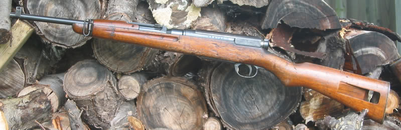

    Just for reference, here's mine. The only other one I've heard of in Canadaicon.
    Officially, a Royal Thai Police Type 91 Carbine (Thailand is post-war Siam). THis particular one is the lowest existing serial number on record:
