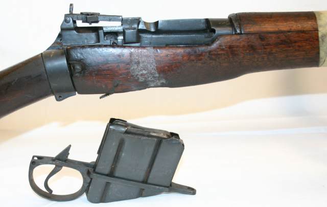

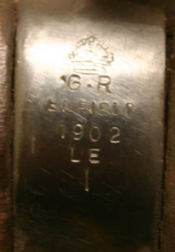

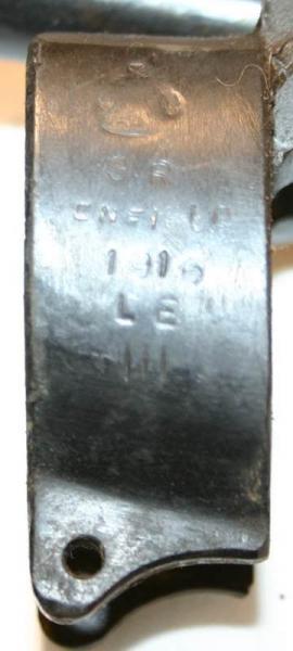

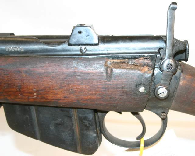

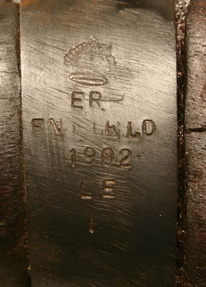

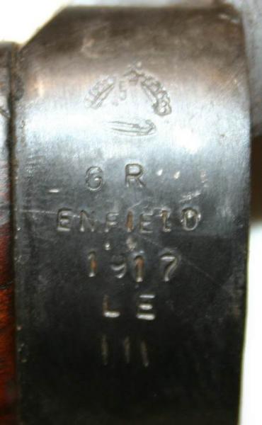

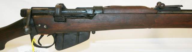

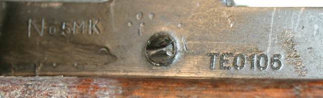

    There has been a multitude of suspicious Enfields on GunBroker recently, as we hear / see / read about the unwary being caught out here is a montage of pictures showing examples :
    If I'm mistaken and anyone believes them to be originals I'll delete the relevant picture.
    There are No1s, No4s and No5s - all very poor copies.

    I see what appears to be some original minor parts, but look well worn. I actually wouldn't mind one of these as a curio, some look quite reasonable for hand made, others are an absoloute abortion. Do you think some one has imported these as originals, only to realise they are bad copies, and then tried to flog them on to avoid making a loss?

    What does the TEO number stand for?

    Since 1968 US regulations say that every imported firearm must be marked by the importer with a name and a serial number.
    The seller is TG International & I'm guessing that he has marked up each of them with his own unique serial number for traceability.

    I have noticed that some sellers on GB will state that the item is a "Khyber Pass" copy, but others will not mention the fact, and appear to be selling the item as a functional firearm. I wonder if they know that, even if you got the thing to fire, it would be more dangerous to the person holding it than to the person in front of it...
    What does amaze me is the amount of money people want for these things. Heck, if I'd known there was a market in these items, I'd have got into the "slap a bit of pipe on a piece of wood and hope for the best" business - I'm not far from my local home improvement store (only joking). Who knows, these copies one day may become collector's items, and will cost more than the originals - that thought makes me shudder, but weirder things have happened.
