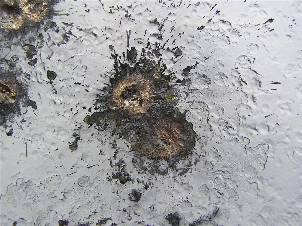

    I've posted this on the CMP forum.......
    The other day I tested some of my M2 AP (AYR 28) against an old 3/8” AR500 steel target. The target was hung at 200 and 100 yards with the back of the target against a wire fence. The target could not swing freely but it did have some give. Rifle used was a M1903 Springfield. The results surprised me. With the exception of one round, the AP did less damage than I expected although the damage to the steel plate was significant compared to non AP ammo. This plate was originally placed at a private shooting range and has withstood thousands of rounds without damage.

    Hit at 100 yards
    Multiple hits at center
    Hit at 200 yards center of target
    100 and 200 yard splash together center of target (100 yd at 11:00)

    You're right! I'm surprised too! I used to shoot that stuff at the new gongs on our range to break them in and they would always leave holes like the one you indicate. The rest of the holes look like ball. The plates were as thick as yours and hardened too. The AP would put holes in transport truck brake drums shot through the thickest part! Nothing else would do that kind of damage for months. Who makes that cartridge?
