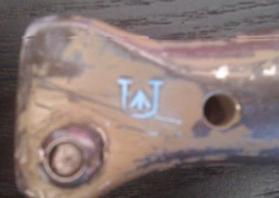

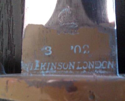

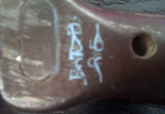

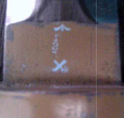

    The bayonet was made by Wilkinson and is dated March of 1902. Here are some pics of the markings. Sorry for the poor pics, but they're all I have. It's curious that the hilt and scabbard fittings are painted in a tan or sand color.

    Definitely has a strange appearance to it. Paint could be a desert cam for WW2 - I believe the SA's were still using these bayonets at that time (not sure on which rifle though.?)
    The rack number does not have a point between the numbers, that is part of the cancel out stamp - it is shaped like a "propellor" with a centre "hub", or in this case "dot".
    The markings do look strange to me, probably because they are more modern than we would be expecting to find on one of these bayonets. Cheers.

    Anything re issued would normally have a straight line or two across the original regt etc, the marks on this remind me of marks on a Nepal Martini Henry I have. Any ideas Old Smithy ?

    Never seen pommel marks like these or a painted 88 for that matter, although a lot of their 07's were painted this sand color. The South Africans actually made 88's in WWII so its use is documented
    The above picture is a WWII made 88 made by the South African Railways, probably therefore for their police forces
