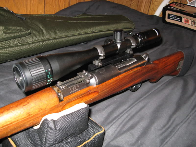

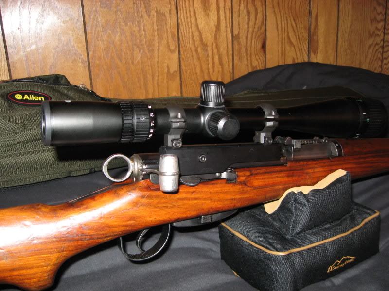

    Here it is for its "dress rehersal." In these pics, nothing is tightened down or aligned, but just demonstrating. I also got an Allen rifle case. This things is VERY thickly padded and is roomy enough for a scope.

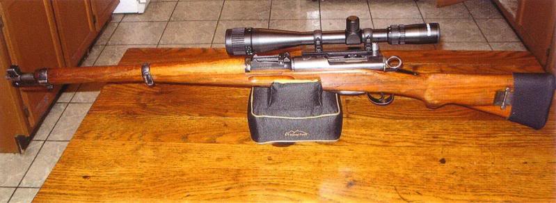

    Here she is with everything securely mounted and ready to go. Just waiting for good weather and time.
