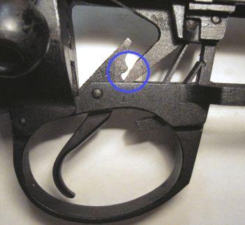

    I have a Savage No. 4 Mk1*.
    I bought it used and it acts as a single stage trigger. I decided to see what I could do about it and read Peter's articles...
    When the bolt is open and back the trigger is two stage. When the bolt is closed the sear is pushed away from the first bump and only acts against the second stage yet, when I measure the weight of the trigger pull it averages 4 lbs 4 oz with an electronic gage.
    The trigger assy. fits flush against the wood, the wood isn't crushed, the sear is clear of the small locking lug, the sear on the bent isn't half way up but about 40% up and it is mostly even judging by the removal of the grease.
    When I close the bolt, I can see it moving the sear away from the first bump. With the trigger assy screws removed and the bolt closed, if I lift up (with the rifle upside down) on the back of the trigger guard to the point where the sear moves back against the first bump then the whole for the small screw is way too far up for it to fit.
    I never realized how precise this is and I'm a bit at a loss.
    Any suggestions?

    Does the rifle have its bedding screw collar? That is supposed to keep the front end solid between the trigger guard and the receiver, and then the trigger can be tested as issued. I suspect you need to swap in a few parts to find what's not working. Ypur problem is the back end. Have you considered that the trigger guard itself is bent? Maybe you should experiment with that.

    Hey, you're right Maple Leaf......... a slight bend of the trigger WAS the way to adjust the gun timing of the old M1919 Browning - and successfull it was too! But that was the ONLY gun where you bent anything to adjust it. And while others might disagree, bending the trigger guard to get the correct two stage pull-off is a bubba bodge. The trigger guard MUST be flat.
    The sequence of events is all simply explained in the article limazulu. Make sure that your trigger guard is FLAT along the bottom and sits into the magazine well of the fore-end, That's the first bit. Now make sure that the collar is present and to the correct length and the front trigger guard screw JUST nips up the fore-enjd nice and tightly as it clamps the trigger guard onto the collar.
    Now follow the instructions. Read it, now read it again and slowly set about it...........................

    It does. I considered bending but what, which way and how much is one of the problems. I tried shimming one end or the other as a temporary bend effect but that took up all the slack in the trigger and still was single stage.
    I forgot to mention that its headspace is fine.
    When I pull up on the back of the trigger to the point where it is two stage with the bolt closed, I can see part of the hole the small screw should go thru. There is a very slight crusing of the wood at the back end but its nothing like the picture Peter showed in one of his pictures of wood crushed in the front end.
    I'm just hoping someone has encountered this problem before so I don't have to re-invent the wheel.

    Remove the forestock and reassemble the mechanism, including the front screw bushing. You can then observe the action of the trigger and sear and correct any problem with the metal bits. If there's no problem with the wood removed, then you know that the forestock is the source of the the trouble and can work on fitting it appropriately.

    I've read all of that and I'm either getting confused by the terminolgy or confusion over our common language. The inspection shows the trigger lays flat. The wood is nice and smooth with no marks on the front. The only thing I noticed is the back part of the fore end does stick up a bit from the metal. If it was down further then the trigger would sit up higher and perhaps that would solve my problem. I remember a picture of Peter's adjustment for it with a block of wood but I can't seem to locate the picture and I'd like to see it before I attempt it myself. Does anyone have a link to that picture?
