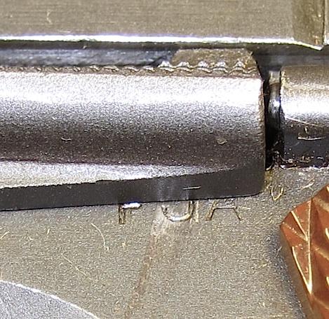

    Most here have already seen this one, but was ask for pictures of early RR and figured I might as well post them for those that haven't seen it.
    This one shows the typical smooth Du-Lite blue finish, as well as a 1911 style slide stop. Remington Rand purchased unfinished 1911 style slide stops from Springfield Armory early in production. The barrel is a COLT .45 AUTO with large G. This is the 983rd Remington Rand.

    John,
    I know that I have seen photos of that pistol before, but is it missing it's FJA? Maybe my eyes are blurry from all of this southern pollen. Anyway, I see good enough to recognize a fine early production Remington Rand.

    I think a lot of early Rem Rands have their FJA struck up high, and are somewhat covered by the slide stop. I don't recall about the specific position of the FJA on Johnny's pistol, but have seen others that way.

    As Scott mentioned, the early ones tended to be struck higher, plus they were considerably smaller. The photo shows that almost half the FJA is under the slide stop.

    The position of the acceptance initials also brings up the question of the acceptance procedure. It would seem logical that the markings would be applied to a pistol that had been through all the proofing, function firing, and then cleaned up for final acceptance. The pistol shown appears to have been disassembled when the final acceptance was done.

    Does this inspector use the slide stop as a guide to align the letters better?
    Maybe even struck after the pistol is locked back knowing this would mess with collectors latter?
