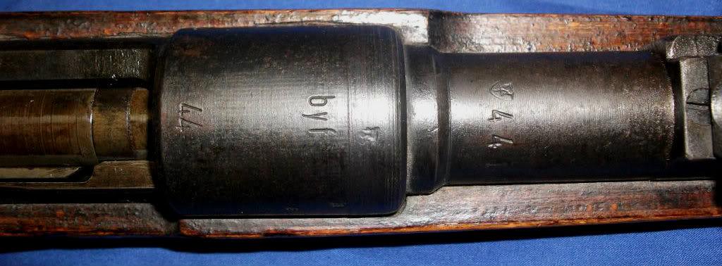

    If you want to call a ZF41 variant a "sniper rifle" the numbers above make some sort of sense. In which case, they can be had for not too much, and be "real"...
    This one was coated with ancient oil that had turned to varnish. A little corrosion, but not bad, a great bore, but a mismatched bolt. Hardly something faked up!
