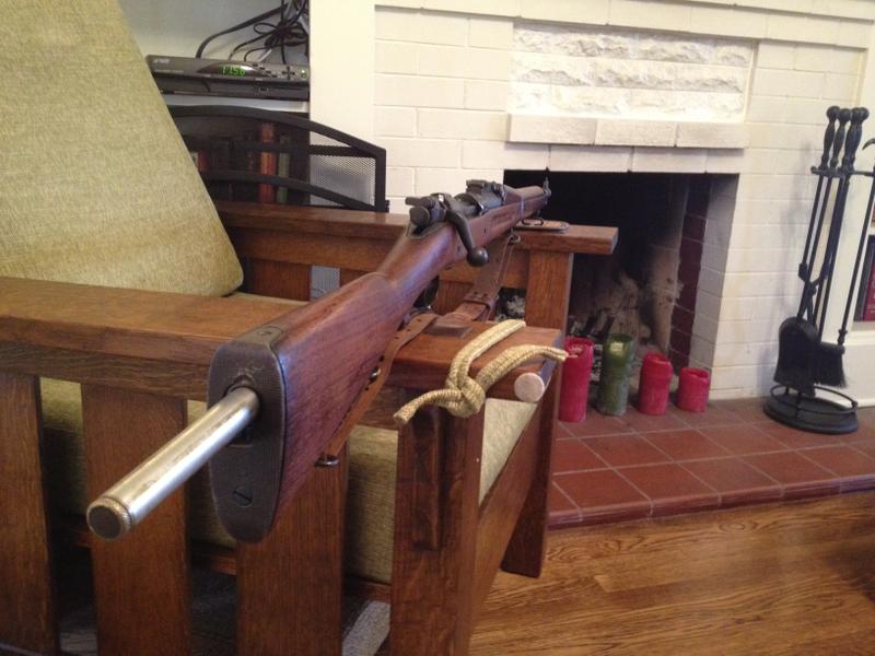

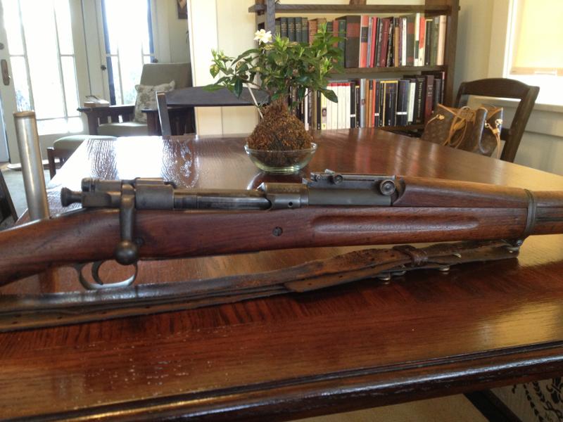

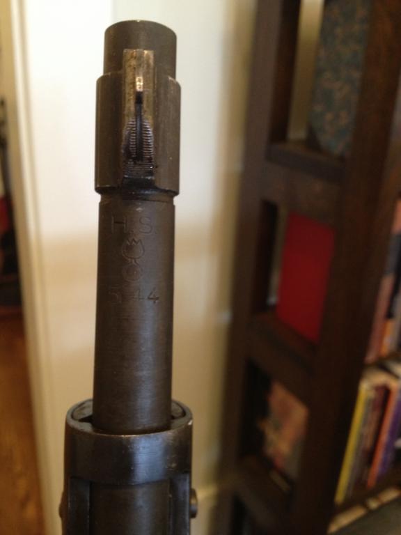

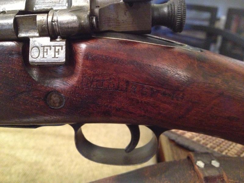

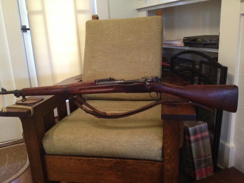

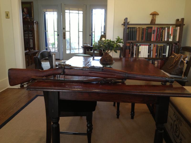

    Here are some pics of the entire rifle in which I inquired about inspector WJS inspector stamp on stock. I was able to carefully remove the very heavy, old coating of shellac leaving every scratch and ding intact as well as stamps and proofs, and apply some much needed BLOicon. The rifle came with the cleaning kit, manual, and a very old but still usable (for shooting not parade) sling. It has a replacement High Standard 5-44 barrel which gauges .5 at muzzle and is in brilliant shape. I was able to tighten up the wobbly rear sight with some brass shims that I frequently use to true up my woodworking equipment and I think it will be a fine shooter. Receiver is in the 3106xx serial range. I plan on taking it out tomorrow if winds are not up. Thanks for looking and input on previous thread.

    Nice lookin rifle, I see its in a mk.1 stock as well.

    I agree - nice example of a rebuilt M1903. I didn't notice the Mark I stock, but there it is. Does the handguard have a "D28179" stamp on the top?

    On another track, the first picture, the chair the rifle
    is on. Is there a button on the arm to adjust the back?
    It looks like a chair that was made in Grand Rapids
    many years ago. I had one like it, and it had a slide
    out foot rest. I miss that chair, it was comfortable.

    Thank you, receiver is somewhere in late 1918 range, and I've taken it out twice now and I am very pleased
    As for the chair, I built it to Stickley specs and it has removable pegs on chair arms which can be moved back or forward to recline. No lazy boy foot pop out but I did make a matching ottoman that, if I'm lucky my dog will let me use.
