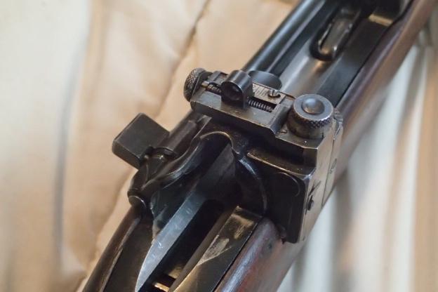

    Here is a shot of the bolt from another angle I don't think I got the locking lug, that is the part that rotates down, it is flat maybe wider at the top than the bottom by a smidge.

    Ben, I can see enough of the bolt to tell that it has the soft metal plug covering the head of the screw that adjusts headspace when the rifle is being assembled. The soft metal plug is to keep "bubba" from changing the headspace adjustment.
