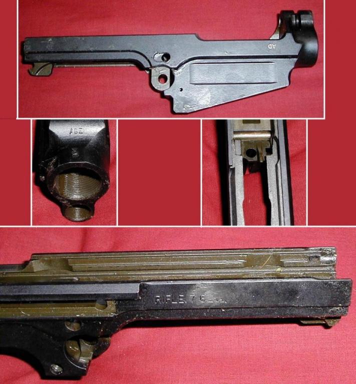

The body was never made as a spare part per-se as this was what we called the 'master component'. This part was in fact 'the rifle' and was never available via Ordnance. So that puts that theory out. 1983 just seems impossible to me. At that time we could have just purchased directly from Australia

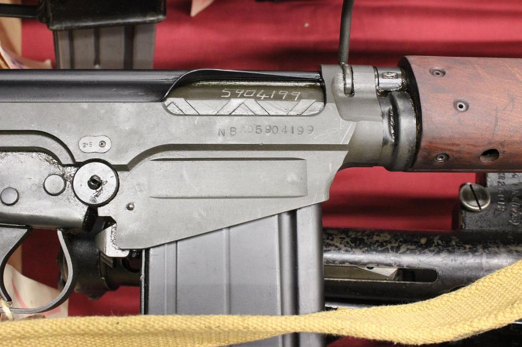

Hmmm, just looked more carefully at the serial number picture, you can clearly see machining marks below the serial number, that indicates a Lithgow
to me, Enfield and BSA made rifles are better finished cosmetically, with these markings smoothed off (not starting a Antipodean quality argument here guys), its just these markings are always evident on Lithgows I have seen and they are not typically present on UK
manufacture rifles.
The mystery deepens, don't know what it is about that rifle, but it just doesn't look quite right to me, just cant put my finger on it.
I wonder if its a civilian US made 922r compliant receiver, (minus Auto sear) L1A1, that somehow arrived over here and was deactivated, these have faux UK military type serials applied sometimes ??
Got me stumped.

Im not 'Happy' with the engraving on this one either!..............Check it against a REAL L1A1!.....................
Just MY, thought's about this particular 'Rifle'.........

My thought too...shouldn't those markings be filled with the finish paint from the factory, instead of looking like they were pantograph-engraved on after the paint was applied?

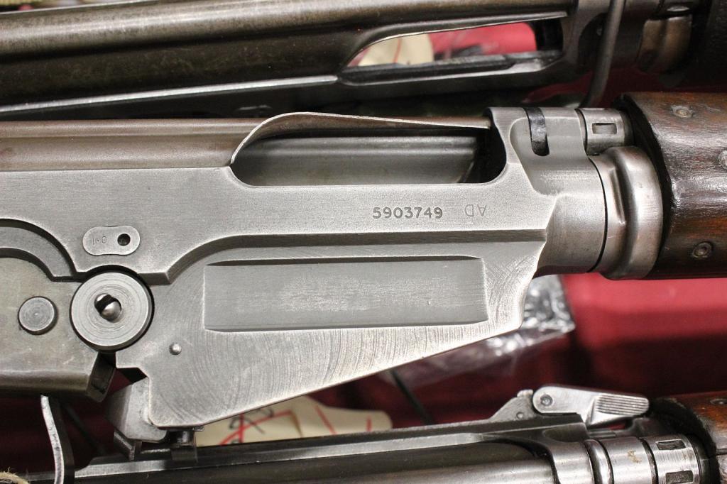

That receiver was manufactured by Lithgow, you can tell by the contour of the lightening cut through the magazine well and the contour following lightening cuts where the lower and upper receivers join.

Certainly the Body is Australian
as Lee Enfield said.
What peeks my interest is a marking that you can't see very well and one that might answer the question as to whats going on. if you look closely there is a stamping on the left hand side just below the cocking handle on the magazine well.
I think its possible this is a replacement body, sourced from Australia and used to rebuild rifle A20xxx in 1983
I think you will find whoever did it engraved the typical British
markings on the lefthand side including the original Serial number. If we can get some decent close up photos of the left and right hand sides of the Body and of the markings in front of the magazine well I might be able to give a better explanation.
