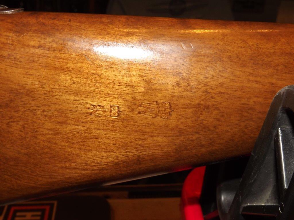

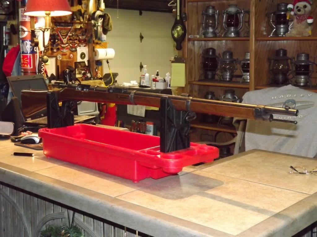

    I've been offered an M71/84 which I don't know a lot about. The metal and bore look good but the stock looks too nice and the cartouches don't look quite right. $700 is the asking price. Photos below are what I have on it now. I will be able to inspect in person.
    I don't know enough about the cartouches on these to know what these are but they do not match any known examples I've been able to compare them too.
    What can the experts tell me?

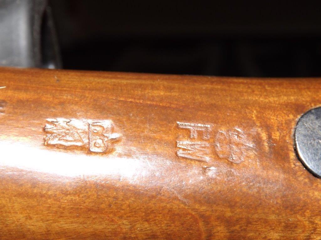

    Thanks Doug, that one looks better than this one. My main concern is the stock markings. They don't look real to me but that may simply be because I've never seen any just like them before.

    "They don't look real to me but that may simply be because I've never seen any just like them before."

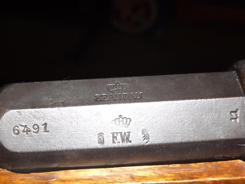

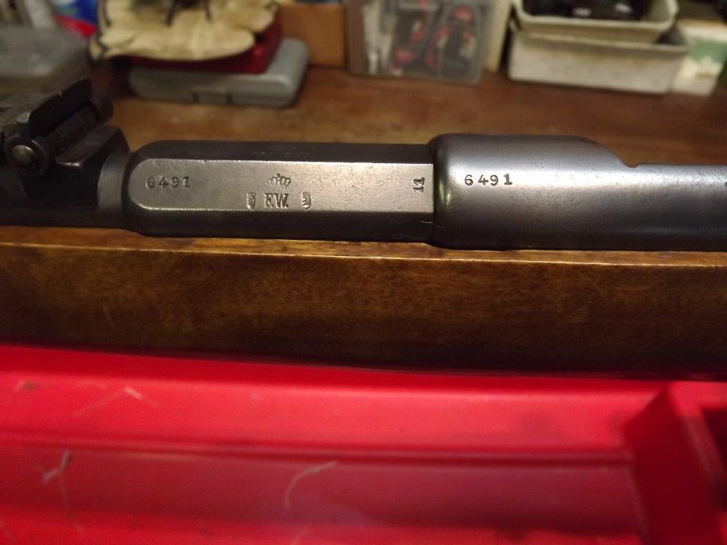

    Your feeling is quite correct. IMHO, the stock is a replacement ( the wood looks "too new to be true") and the markings are faked. And not even good fakes. M / 71 and 71/84 inspection stamps (Revisionsstempel) always used Germanicon black-letter ("Gothic") script. As can be seen on the photo of the knoxform (knocksform? nocksform?) left and right of the "FW" stamp that indicated the monarch/state. And the stamp for the monarch did not appear on the stock at all. So the FW on the butt can only be a fake, regardless of styling. In other words, the faker didn't have a clue what he was doing. And thereby spoilt a good-looking (but not original) stock.
    The official marking plan was like this:

    So you think the stock is a modern reproduction or an older replacement? The cartouches just look cartoonish to me, I just didn't want to come out and say that. In any case, I assume this is not worth anywhere near $700 with this new information?

    "So you think the stock is a modern reproduction or an older replacement?"
    A service replacement stock would also have had the correct markings. And that wood does not look 130 years old! More like 13! Or even 3! It is a modern stock. And I do not even think it is the correct species of wood (juglans regia), the typical source being Caucasian walnut. I have never seen an original 19th C. military stock with walnut as pale as that one - if it is even juglans regia.

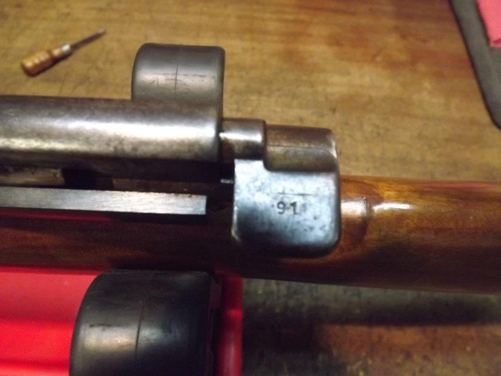

    ... And another thing (or two)

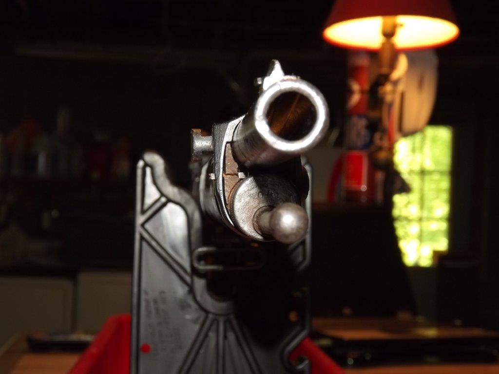

    Take a slow look at the photo of the muzzle and nosecap.
    Note that the nose cap has a different number to the rest of the barrelled system.
    Note that the wood between nosecap and barrel is split, and a piece is missing.
    Conclusion: a replacement nosecap was force-fitted to the replacement stock.
    The only positive aspects that I can observe for this rifle are that the system looks good (for its age) and the rifling is clearly visible right up to the muzzle. It may prove to be a good shooter.
    But from the collector's point of view: forget it.
