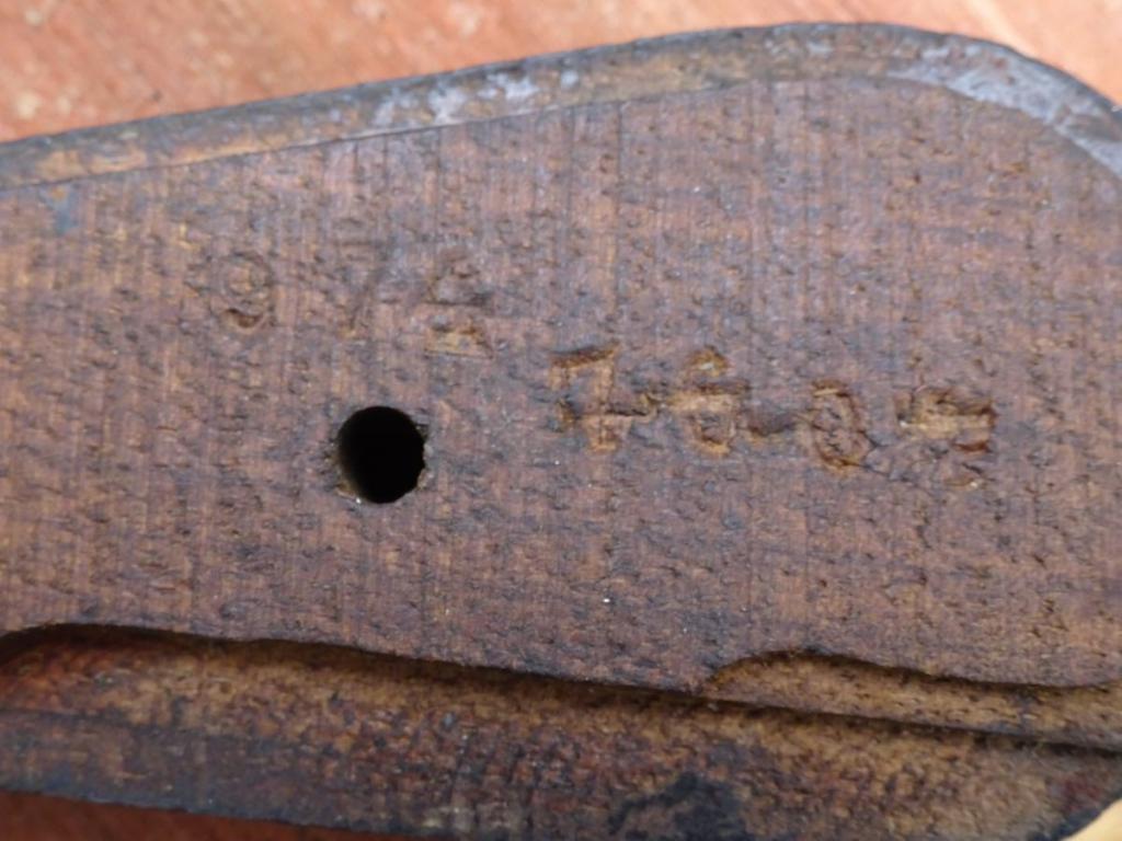

    I am fairly certain that this started life as a "wartime commercial" model in 7.63 and later converted to 9mm (probably by a Brit) since it has the 1000 Meter adjustable sight (900 meter is omitted). The barel has been cut to 4" as well. I have never been a fan of the safeties on the 2nd variant (you have to physically pull the hammer back a bit when cocked and manipulate the safety with your other hand) but it is not like I will carry it in the field anyway.
    A few interesting things about it (at least to me)
    • Grips carry a previous serial number but this has been lines out and the correct numbers stamped inside the panels
    • The barrel appears to have been cut just forward the receiver and a 9mm barrel section fabricated on (see pics with line traveling the diameter of the barrel and difference in finish between barrel and receiver)

    "Jung" and "Haug" are both Germanicon family names.
    Rather a neat barrel graft! I think it might be a 9mm Luger barrel that has been fitted by screwing it into the bored and threaded stub of the old barrel. The front end, of course, turned down and fitted with the C96-style foresight.
    I think maybe...it looks like it anyway and makes sense.

    Thanks guys. You may be right pat, it does look like that is a possibility, I will look at it more closely tomorrow. I wonder if a Germanicon or a brit did the conversion

    British, not German work
    "I wonder if a German or a brit did the conversion"
    Such work requires reproof both in Britain and Germanyicon. As there are Britishicon proof marks on the system, slide assembly and barrel, but no German proof marks on the barrel (which would have been mandatory, together with it being numbered to match the rest of the system) I conclude that it is British work.

    Probably Capture in WW I ( leather style is typical), and then re-done in Britainicon, maybe prior to WW II. Birmingham Proofing, (pre 1950s).
    Germanyicon did a lot of "commercialising" post-1920 of WW I C96 guns, usually fitting a Luger barrel to the Barrel stub ( with Luger front sight.) these will bear German Proof house (commercial) Markings.
    Being "short Barrel", it is probably the original Barrel, cut off, rebored and sleeved back into the stub, and rechambered. The work is very craftsman-like, probably done by a Good Birmingham or London 'smith ( if London, would have gone to the Company of Gunmakers London Proof House, so must be Birmingham or close by.).
    Nice example.
