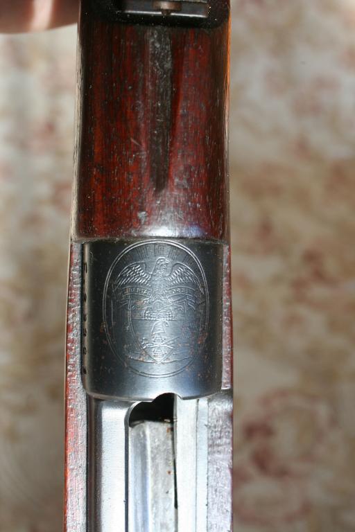

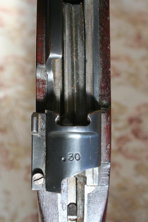

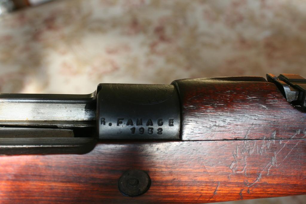

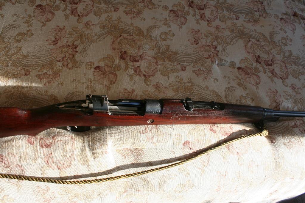

    As a favour to my future son-in-law, I'm trying to find a replacement bolt assembly for this Mauser. A Columbian converted to 30-06. ( and a great shooter, according to him). I know complete bolt assemblies are readily available on-line. What do I need to know, or to measure, in order to get the correct one. The original is not available, due to being thrown away by an angry ex-girlfriend Thanks in advance. Any help greatly appreciated. Dave.

    Assuming this is a 98 action, the new bolt would need to be checked with headspace gauges at least, so this is probably something you want a gunsmith to check for you. Physically the dimensions for 30-06 and 8mm Mauser on the base of the cartridge case are the same, according to a Speer reloading manual I have, so theoretically you should be able to get an 8mm bolt and use it. Once again I stress you should have it checked by a gunsmith before shooting.

    I ran into Mike at the gun show at Oaks and he had an unknown mauser with no bolt for sale. I was carrying a K98icon bolt and slipped it in. Smooth as butter and everything worked. Did some research at home and discovered it was a Columbian mauser, so worn the crest was gone other than the round outline.

    As best as I know the rifles were built by FN as 7mm Mausers. They were converted into .30-'06 in the 1950's. They will take any FN bolt and should take a nice Germanicon bolt, too. You owe that ex-girlfriend a beer. She let you see her true colors before marriage. That is worth beer!
