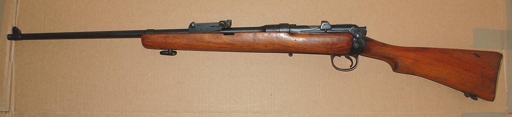

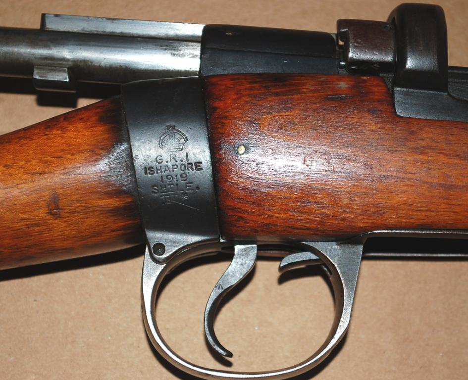

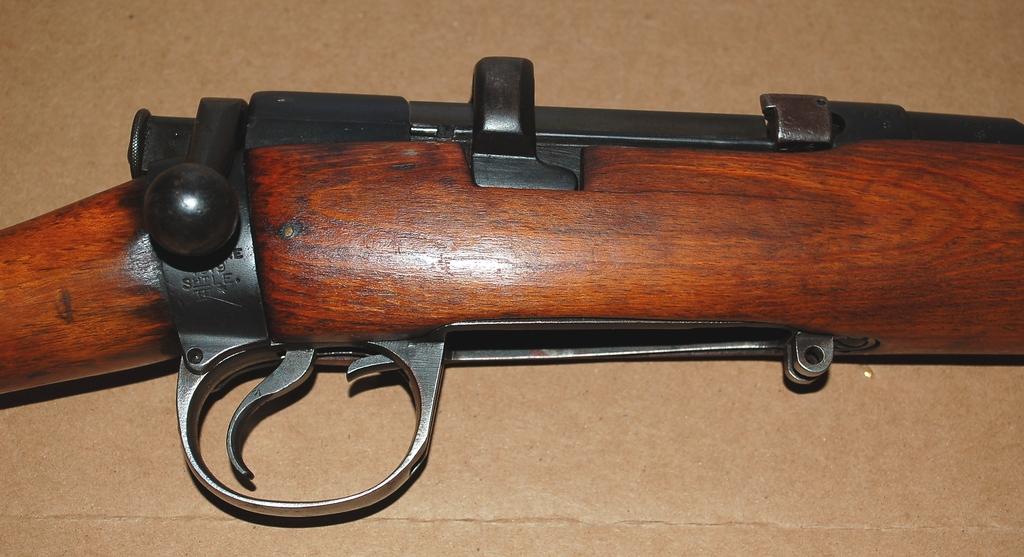

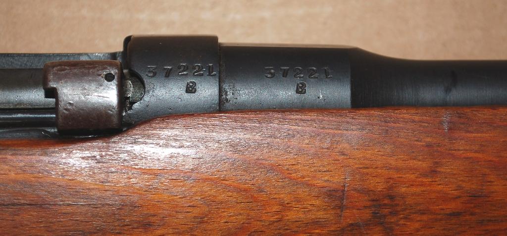

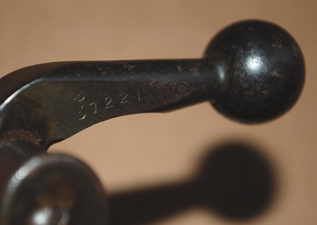

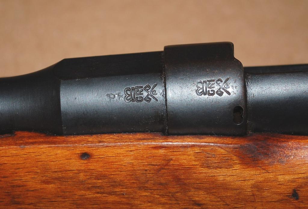

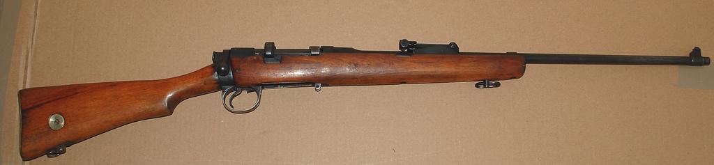

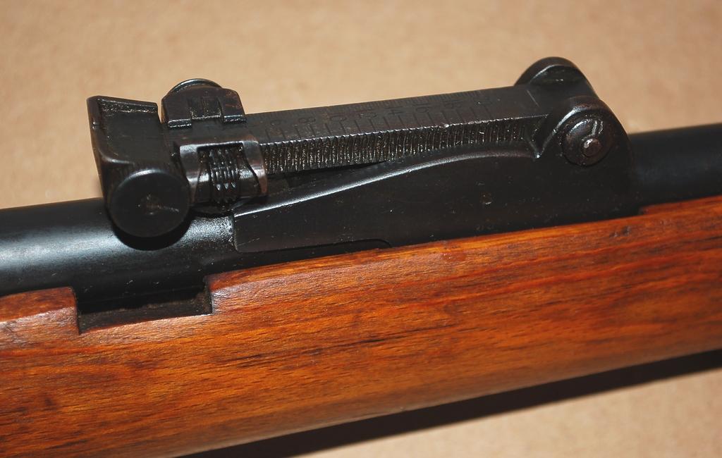

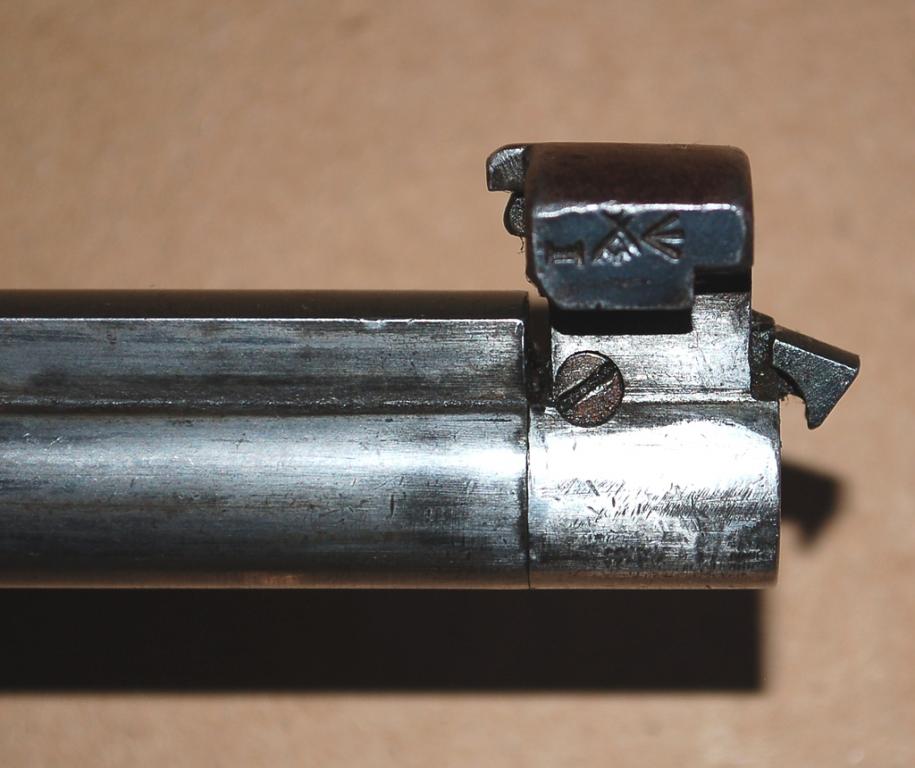

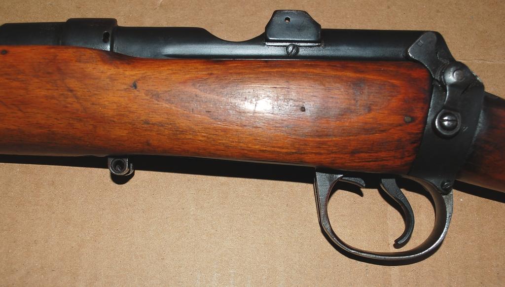

    Here are some pics of the rifles.

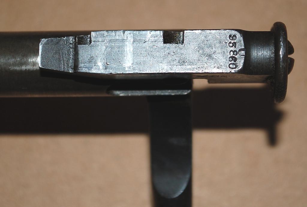

    I've not seen a cocking piece numbered before I think...
    06-06-2025 @ 12:18 PM
    16,667
    12:56 PM
    I noticed that too BAR and given the hardness of the cocking pieces, wondered how the number stamps fared afterwards. Or how the cocking piece didn't fracture or otherwise suffer during the process. Any comments on the structure Bruce in Oz or JM out of interest?
