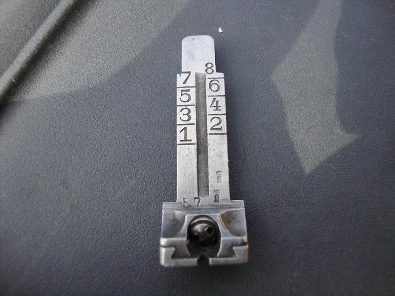

    I have an artillery model Erfurt with the "Fine Tunable" sights which are not wanting to move. Got the screws to turn a bit, but so far no shifting of the rear sight blade nor of the front sight.
    Had the rear sight off recently to repair the notches for the slider and soaked it for a while in PB Blaster. Otherwise, nothing further done until I get more educated!
    Did take out and try it "as is" in a recent IHMSA Big Bore competition. Not a spectacular success as I needed to hold well off target to connect!
    Anybody know the ins and outs of this system?
    ---------- Post added at 04:24 AM ---------- Previous post was at 04:18 AM ----------
    The dovetailed area is quite immovable so far! Same for the front sight blade. Afraid to force the issue as spares don't litter the countryside.
    Had to get the lower notches welded. Then the fun began. This area is now sorted.

    Nice work JM. A pleasure to see. You obviously trusted your friendly tig welder!
    Laser weld, in actual fact! Man specializes in micro-welding. The photo above shows it "as is" after the weld. No discoloration, warping, or undercuts. Beauty.
    The "fun" was generating a cutter smaller than 0.035" thick. I ended up dressing down a tiny grinding wheel to 0.025" so as to have some "wiggle room" whilst bringing the notches back to size in the mill.
    All of which is incidental to the actual purpose of this thread: The dovetailed portions of the front and rear sights are still stuck! And I haven't the least bit of experience with these sights. Trying not to get in a rush and destroy anything, however, I bought it to shoot and it doesn't yet hit where it looks.

    If it was me pondering this JM, I'd be thinking along these lines. But bear in mind I don't know zilch about your particular sights! But the presence of lines indicating a dovetail AND a locking mech tells me that the part was made to a) move and b) be locked afterwards. And together that indicates that there's not a screw thread type adjuster there. I would heat the female part of the dovetail, clamp it and use a brass drift to judiciously start movement of the male part.

    "All of which is incidental to the actual purpose of this thread".
    Not for me! As I have one of these beasts - LP08, that is, not chickens - with a tatty backsight. I am grateful to you for the photo of the welded notches.
    It seems to be a bit of a systematic weakness with these sights that the rearmost notches go "kaputt".
    Now I can show a welder exactly what I need done on my example.
    Coming back to your problem with the frozen sights. It may simply be oil/grease that has become extremely fossilized. I have had foresight parts that needed a brass drift to separate them, as the old grease had turned into something like a resin. A substance upon which penetrating oils had no effect.
    But before applying heat (which is a good suggestion, BTW, but watch out for any bluing) try soaking the part in acetone overnight. If that doesn't soften up any ancient gunge, then use heat - but dry off the acetone beforehand!
