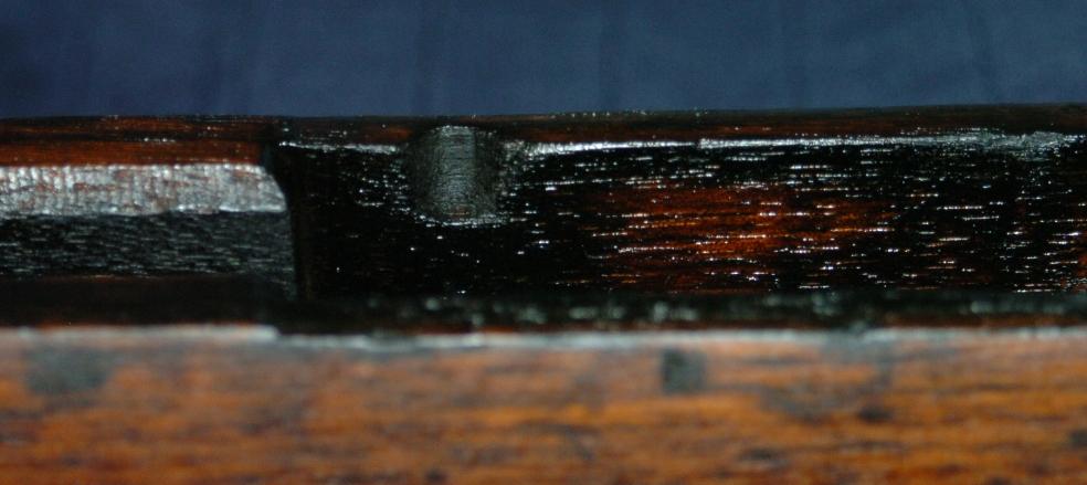

    Looks fake to me. BTW, the GHS stock cartouche is one of the most faked out there. To help, a GHS stock will have a "scalloped" clip latch cut and a number stamped inside the barrel channel.
    Scalloped (tapered) clip latch cut. All GHS stcks have this cut and some very early EMcF stocks as well.
