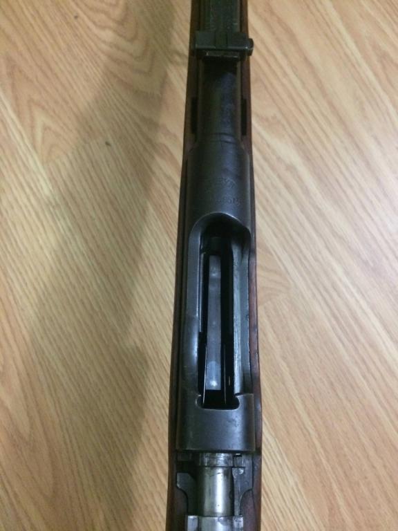

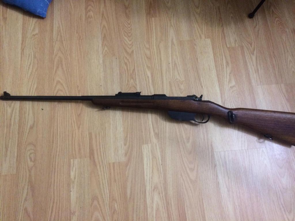

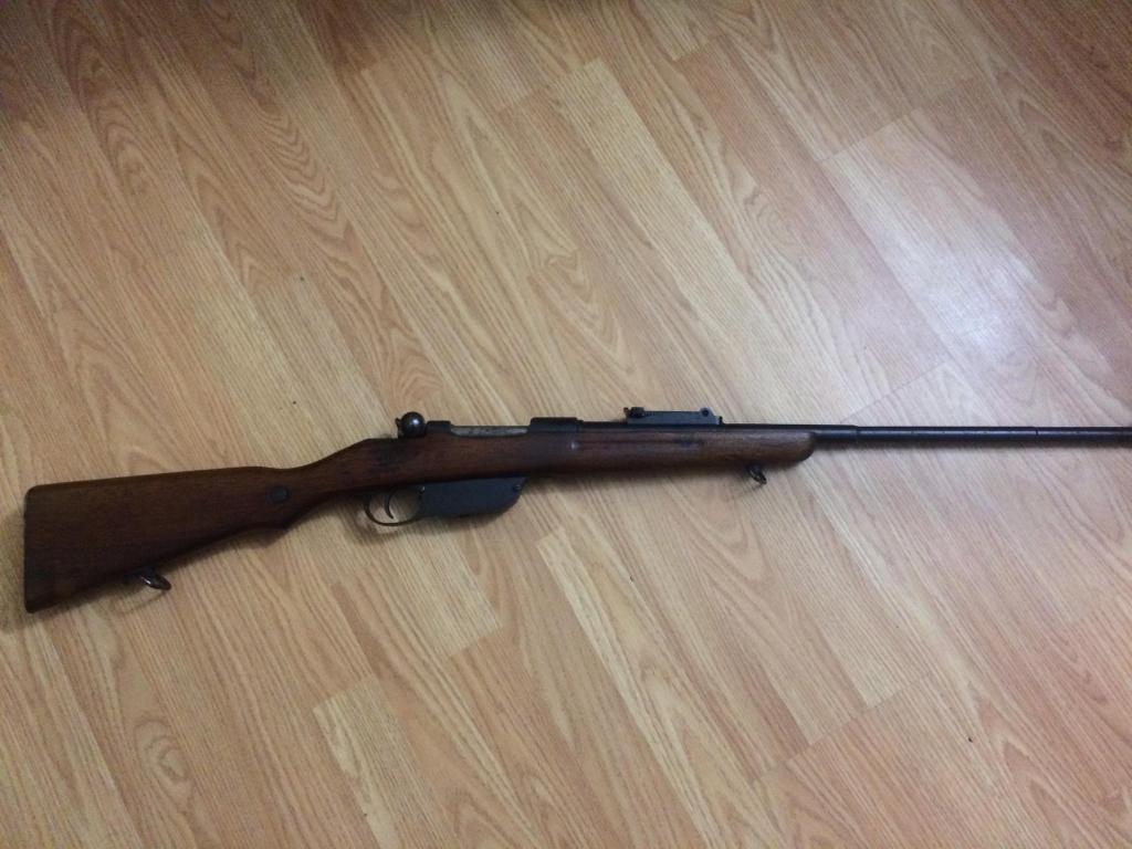

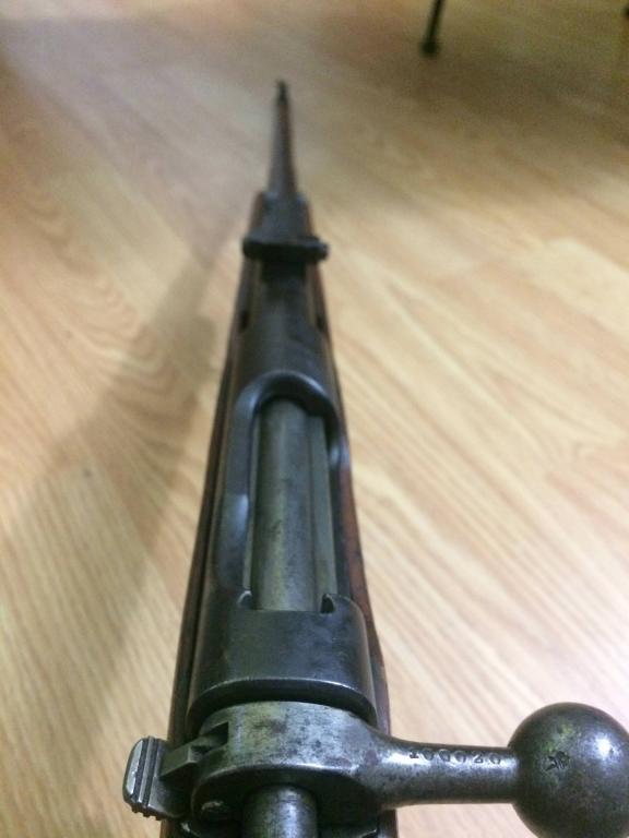

    here are the picture, seems like this project is on the ice until i can find a suitable stock pieces.
