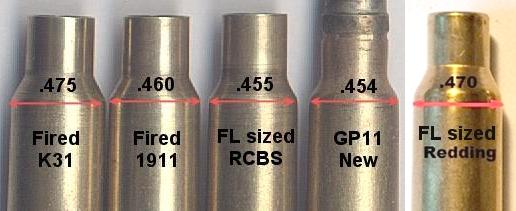

    K31icon and 1911 chambers differ in body taper (and throat length). Dies made specifically for K31 will not FL size cases to fit smaller 1911 chamber. Standard (1911) dies work for both.

    Parashooter's post illustrates a basic rule for all milsurps: even if the rifles have the same nominal caliber, use only neck-sizing dies AND keep the cases separate for each rifle.
    I find that a simple and reliable way to do this is to use cases from different manufacturers for different rifles.
    This prevents the annoyance of getting to the range with the rifle that has the tighter chamber, and finding you have brought the ammo for the rifle with the looser chamber!
    You can, of course, always full-size for the minimum chamber, but case life will be short.

    Unfortunately, neck sizing doesn't work very well for these straight-pulls unless significantly reduced loads are used. At full pressure, cases are often expanded enough that they cannot be easily chambered and extracted via a mechanizm where the bolt's turning force is applied indirectly through a cam arrangement that converts axial to radial motion. This is very different from the usual turnbolt action where all we have to do with a tight case is crank a bit more forcefully on the big handle.
    7.5x55 cases that have been fired will full loads should be FL sized to avoid disappointment at the range. At the very least, sized cases should should checked in the rifle for easy chambering and extraction - before charging. Those wishing to enhance case life can learn to adjust FL sizers to produce minimal cartridge end-play while maintaining an easy fit.
