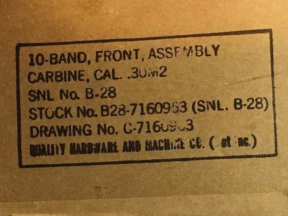

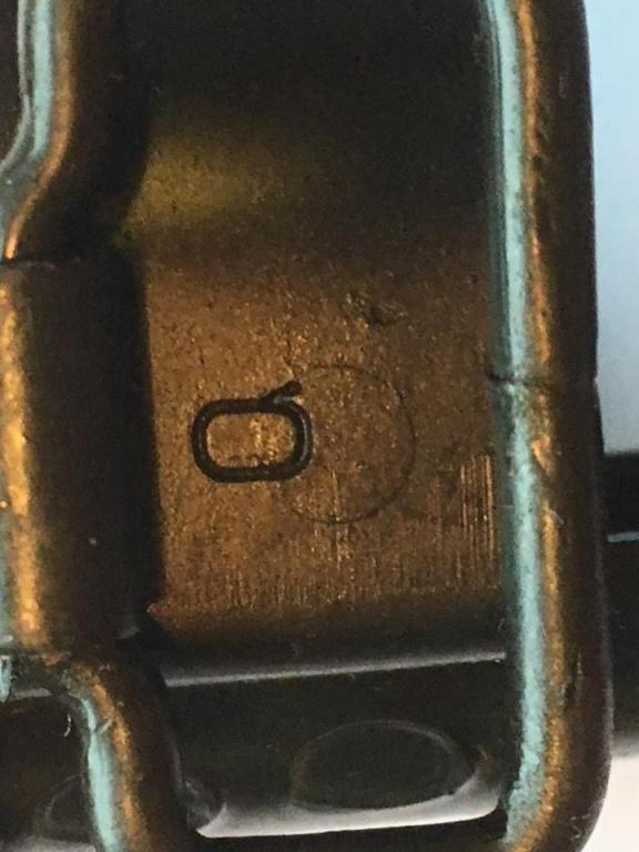

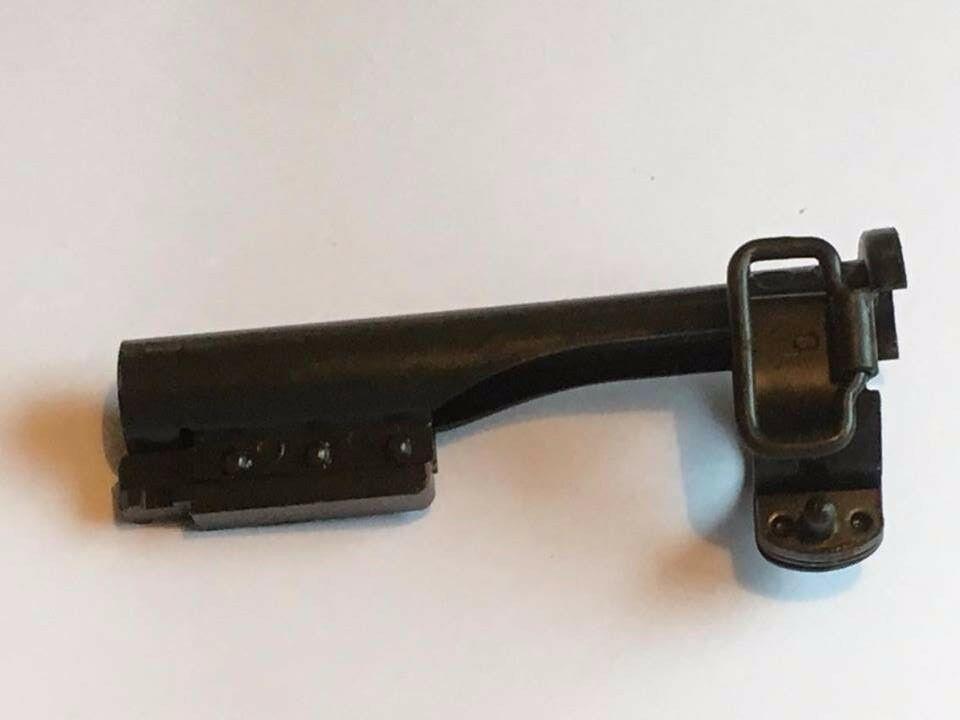

    Does anyone know if QHMC made Post WWII Bayo Bands ?
    Ran across this while searching completed auctions...... Noticed marked for M2.
    Seller stated for the MAP program, he was in Norwayicon. Seen he still has 1 listed for sale.
    I don't know
    Current Auction link......
    #24 WW2 M1 M2 30 US Carbine BARREL BAND type 3 Marked : Q UNUSED NOS | eBay

    Technically yes, but like almost everything else they did the work was contracted out.

    Same seller with SG M2 Slides. Posted for box markings.
    Link:
    #15 US WW 2 . M 1 Carbine Slide Operating Marked : SG NOS.Unused | eBay
    Charlie-Painter777

    From CCNL 356-7 "Marked with the letter Q, Made by Quality Hardware & Machine Corp. of Chicago, Il. as a replacement part. Made under a government contract that ran from June 1944 to June 1945."
    In CCNL 235-6 has a picture of a QHMC band (2 pack) label from Bill Ricca it is not marked M2 rather 2-BAND, FRONT ASSEMBLY FOR CARBINE, U.S. CAL .30, M1 AND M1A1icon.

    Bruce, MWO B28-W5 dtd 7 July 45 was issued after the Ord Department had obtained sufficient quantities of the type 3 bands. Also that is a box of Slides that are numbered D7161843 not barrel bands.

    Wayne your right. I just looked at the numbers and not what was printed on the package. My bad.

    Just read in CCNL 101 that QHMC produced type 3 bands and cast front sights for RIA after 1945.
