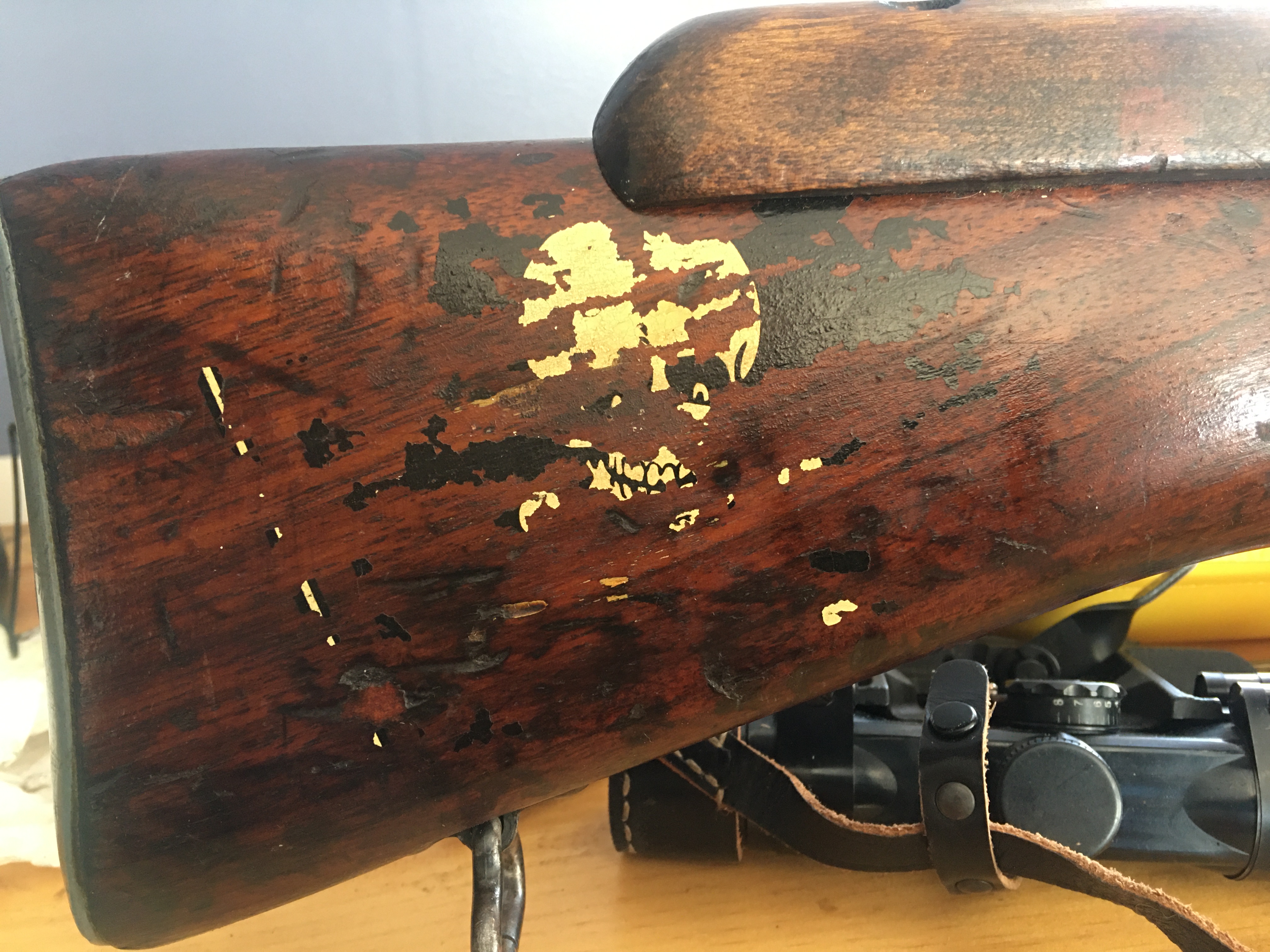

Hello, Long time lurker. I picked up a 1944 BSA No4 T. I started working on cleaning things up before taking a bunch of pictures and found a skull motif on the right side of the butt stock below the check rest. I will try and post a picture. Has anyone ever seen something similar? it does appear to have some age to it.

Are there any other "non-LE" marks on the rifle? The remnants of that mark looks similar to a Nazi "deaths head" symbol. If there are other different marks in the rifle, it would help the true experts on this site to provide you with the info you are seeking. It may be a bad idea to remove that mark.
Thank You to Singer B For This Useful Post:
Death's head was used by many armies including British
. Could be applied by civvie owner in last 60 years.

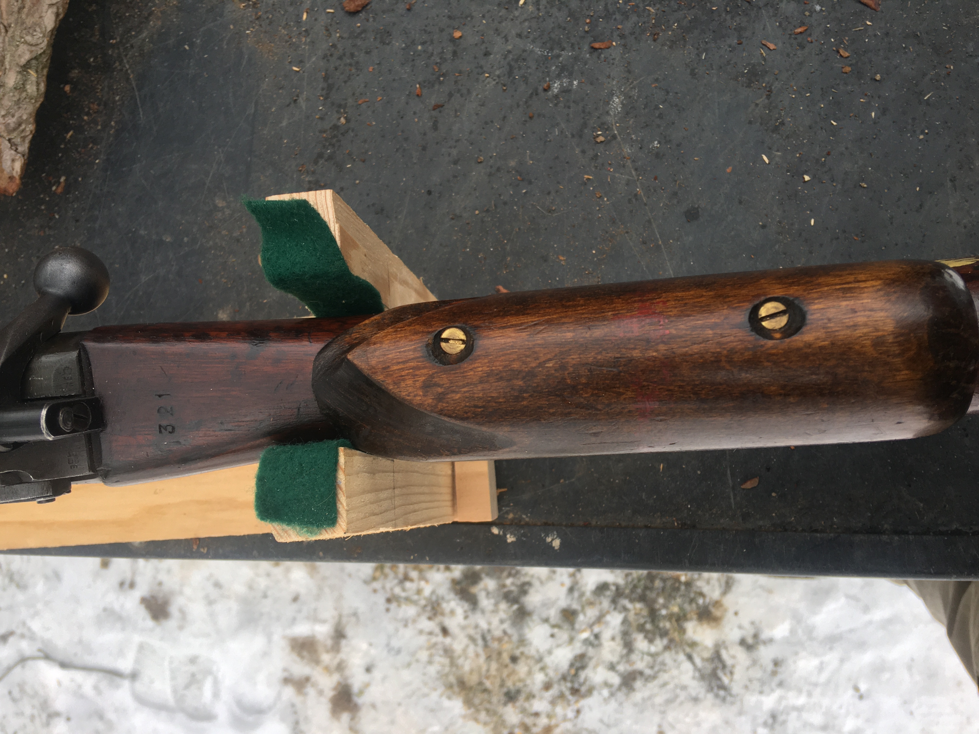

Mark, the skull and crossbones decal appears to go under the cheek piece, is that correct?
If so, it might possibly mean the cheek piece is a later addition.

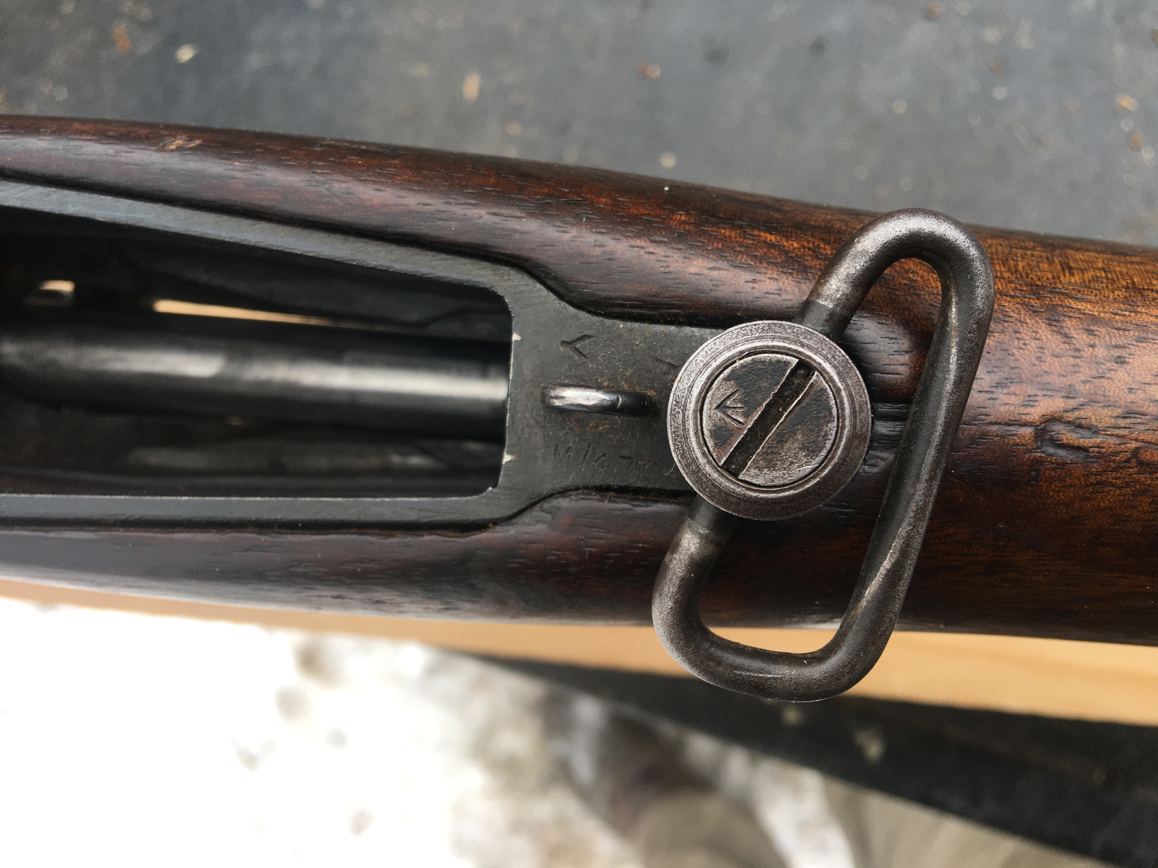

Can you send the usual photos of the action, scope, top and bottom of the wrist, etc to show the T conversion markings?

Thank You for the feedback, I will try and put up some more pic
[ATTACH][ATTACH][ATTACH][ATTACH]

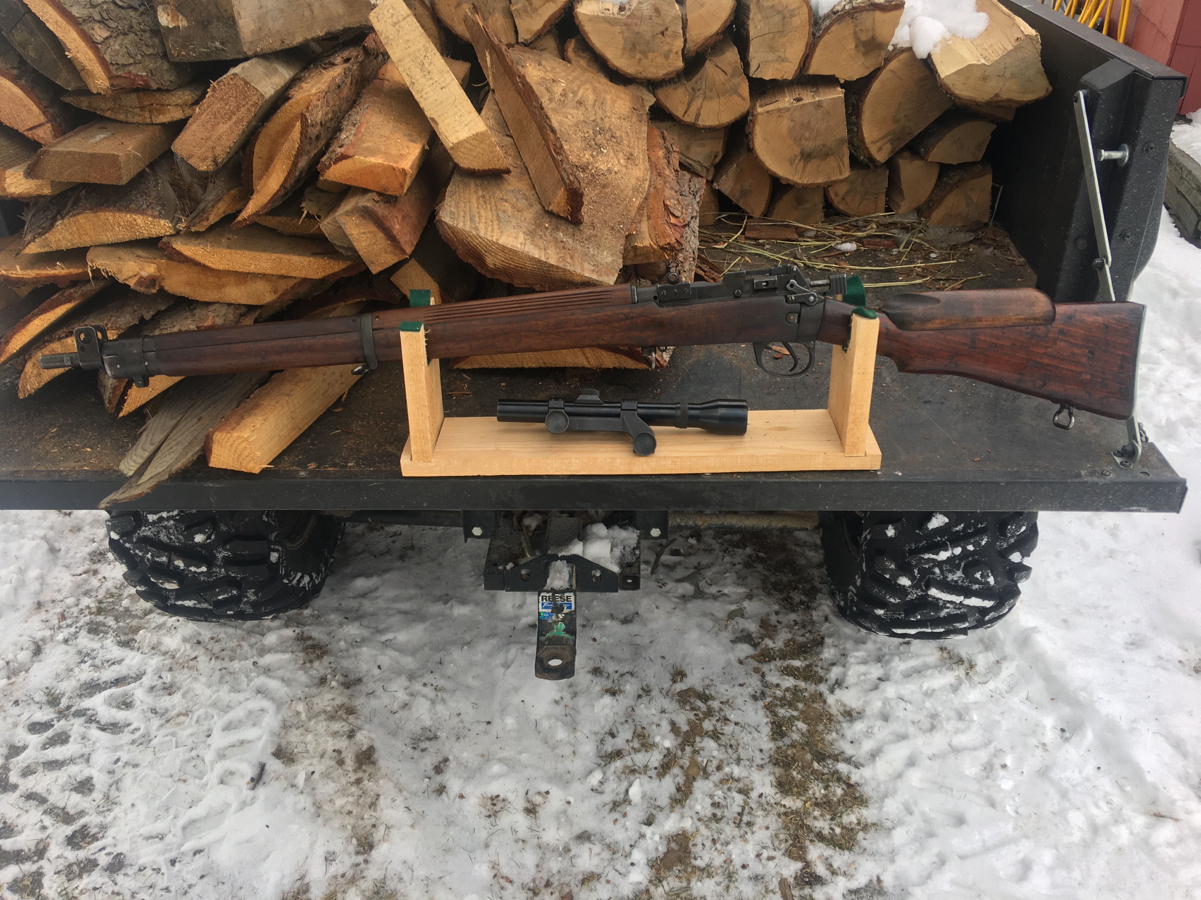

The scope and mount are not original but I would appreciate recommendations on reproduction scopes Thanks again
sorry one more of check rest

Possibly a Lancers Regiment Badge, painted on by its old owner?
Looks a nice Original rifle!
