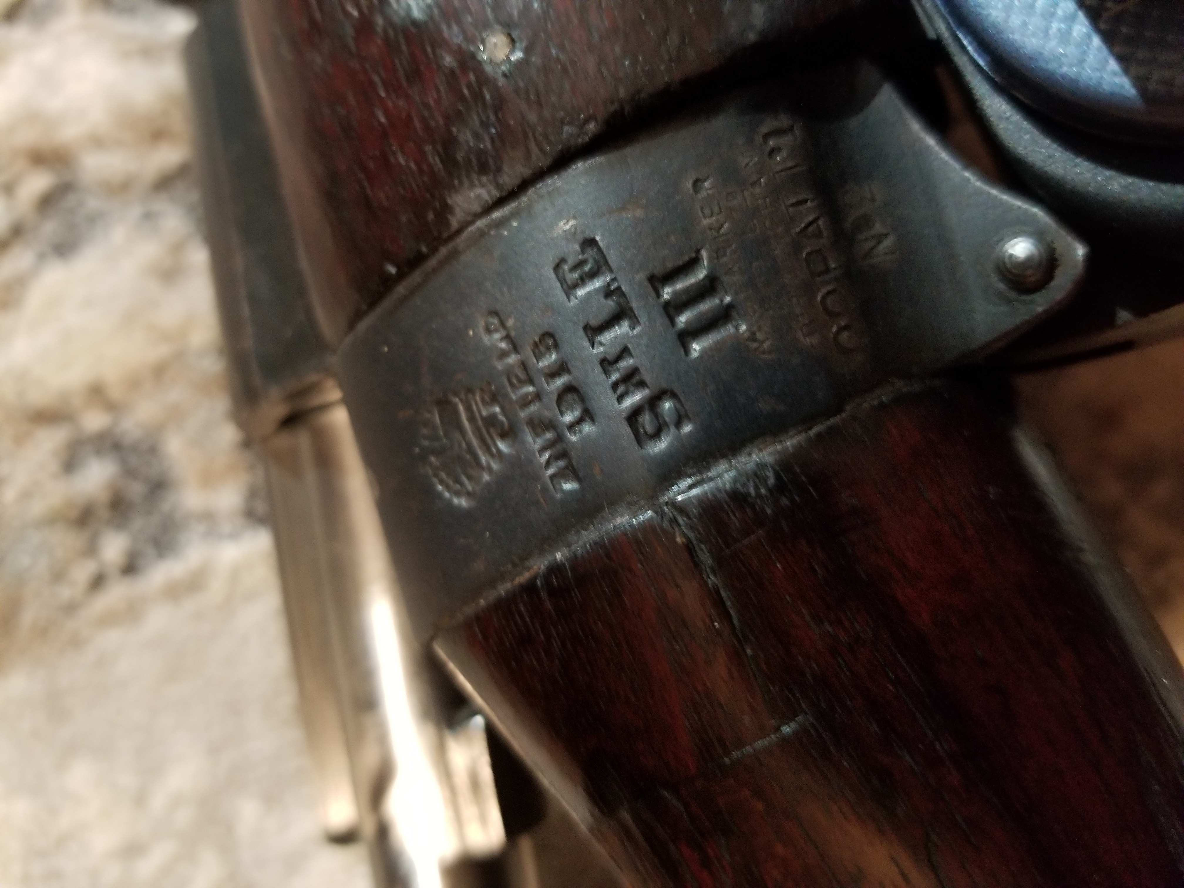

    Oops I read you post too quickly. Mine is a no.2 mkIV with NZicon markings. Far more common than what you are looking for.
    I've attempted to attach a couple pictures regardless.

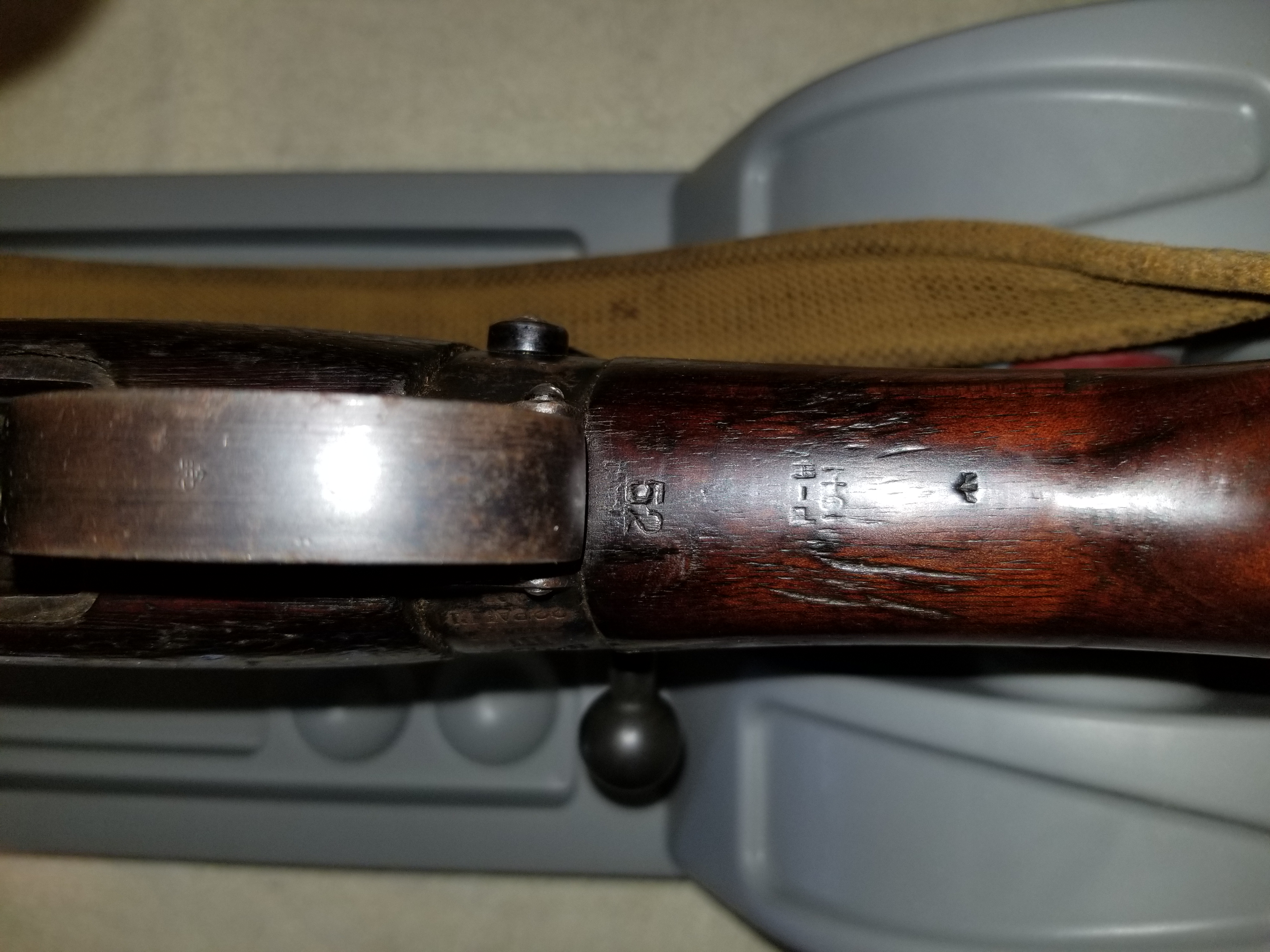

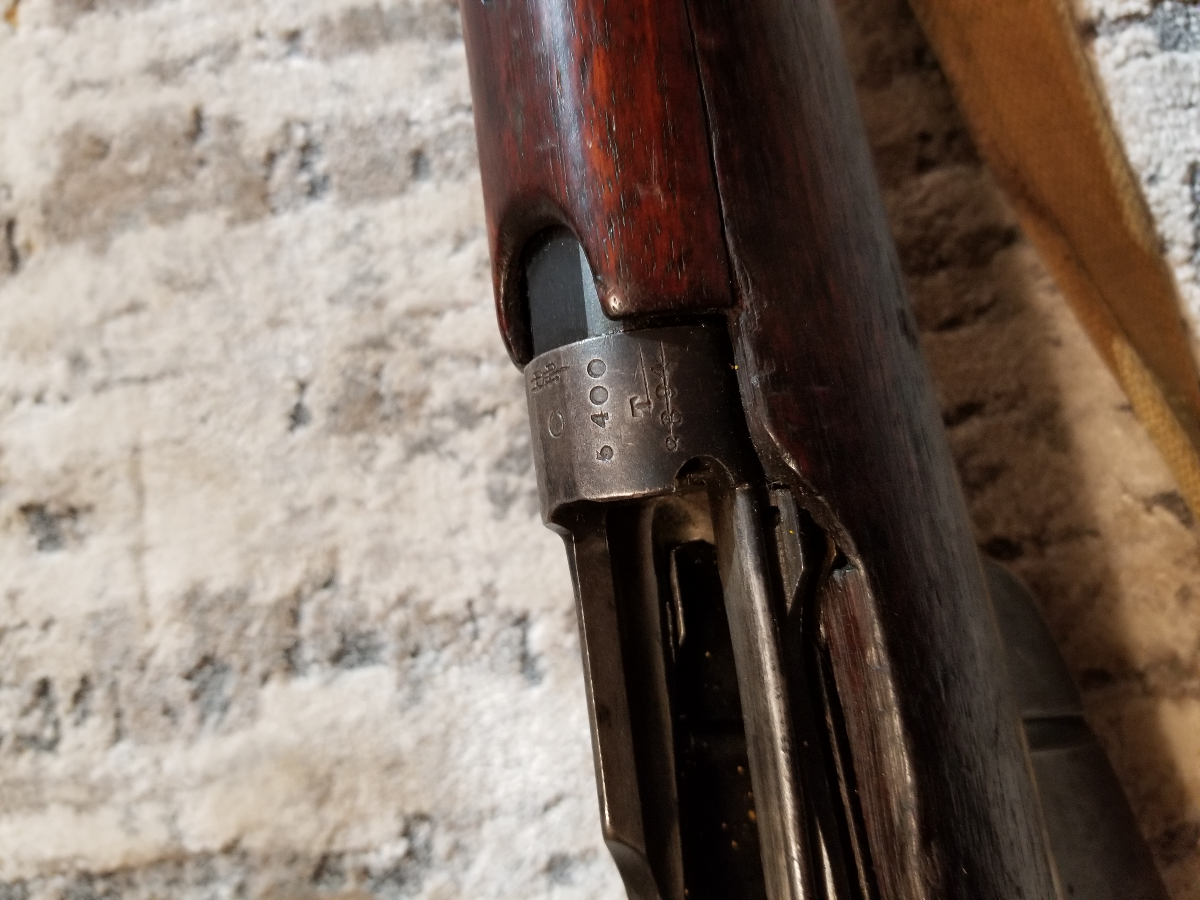

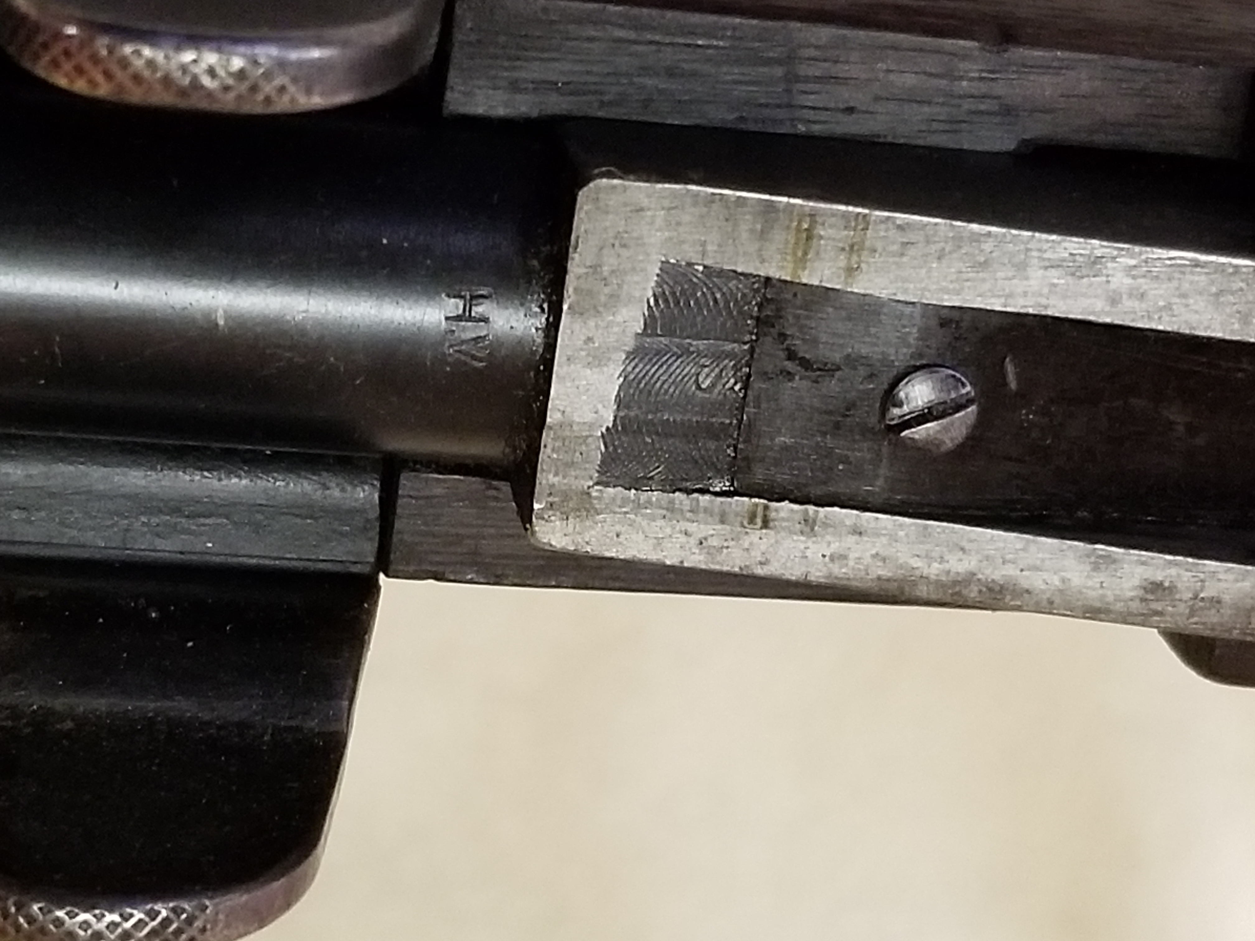

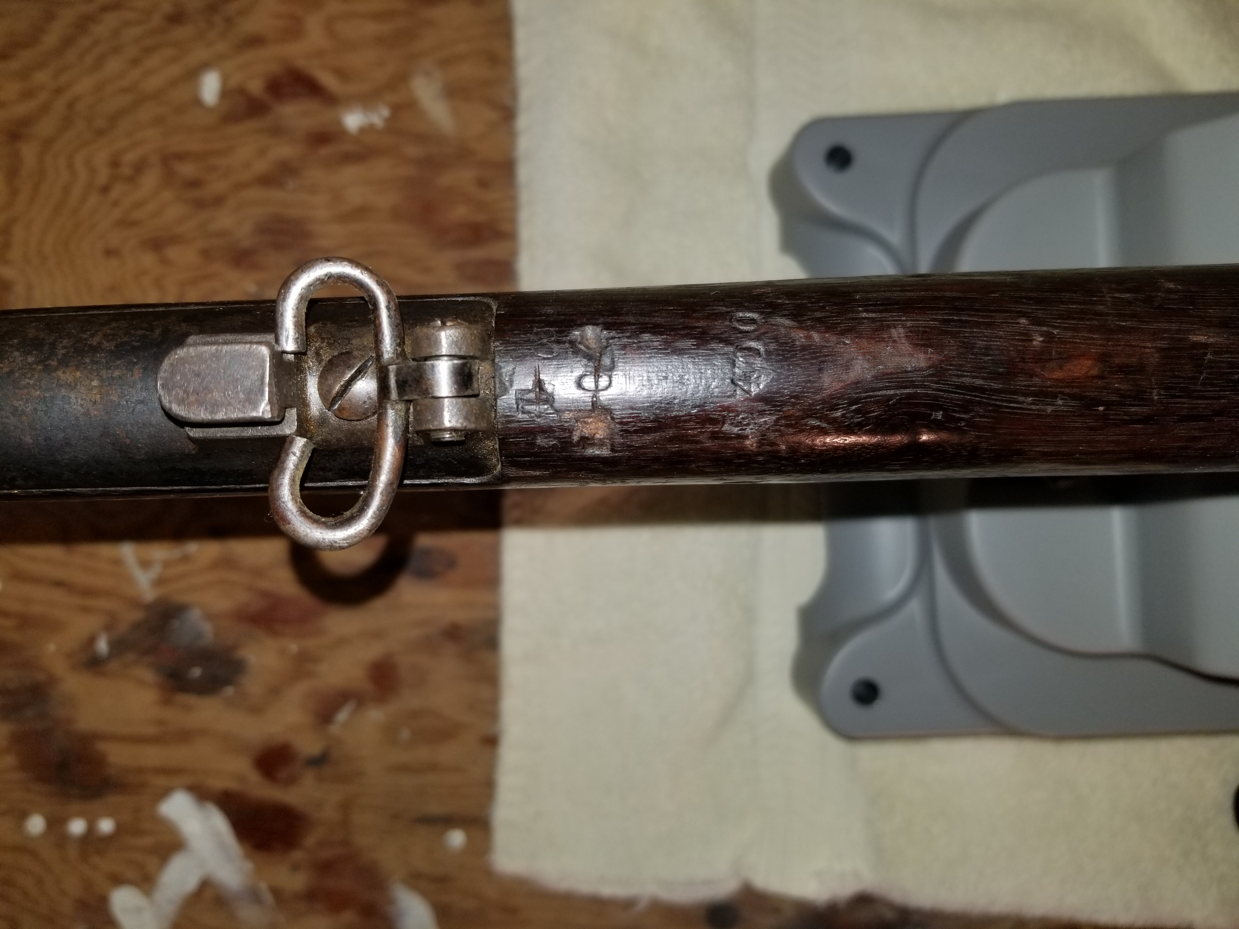

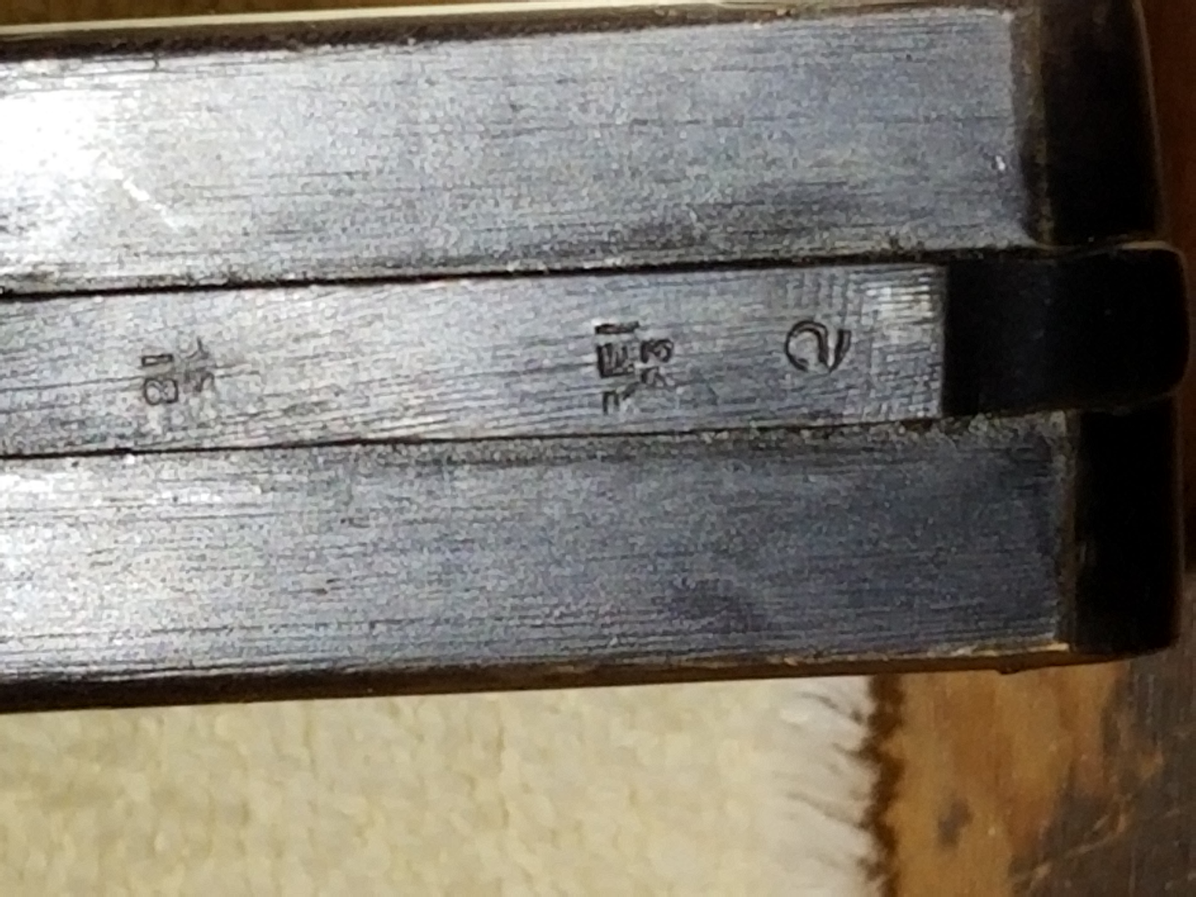

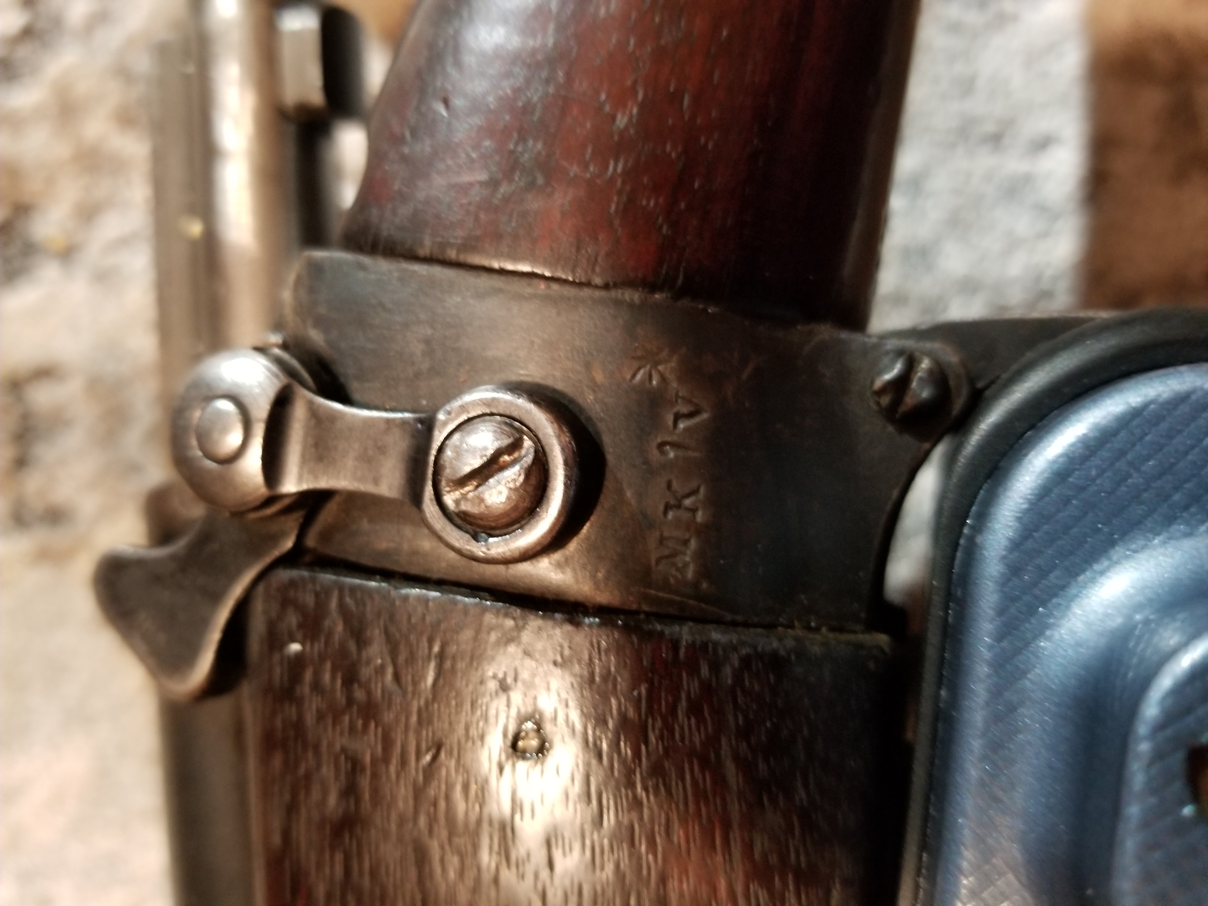

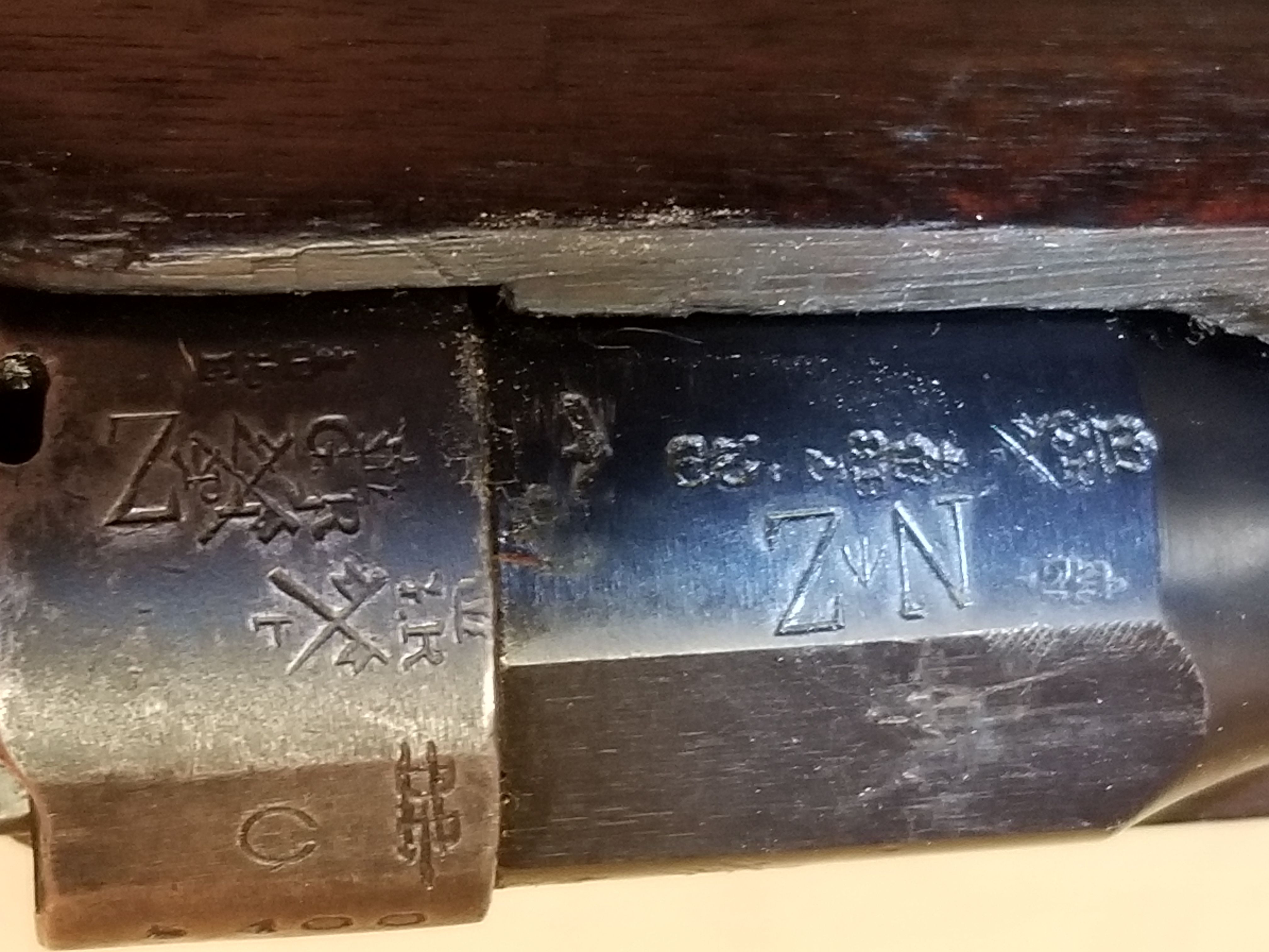

    5 more pics attached. No Australianicon markings that I can discern. The date on the barrel knox is '29. Underside of the wrist is a 52 and, just below,
    P-H
    1941
    Opposite side of the knox has 5400 in line with that same number on the receiver. Same number stamped twice on the top underside of the forend. (The wood split when the number was stamped so it looks like it was simply re-done.)
    The magazine is correct for the rifle with .22 stamped on one side.
