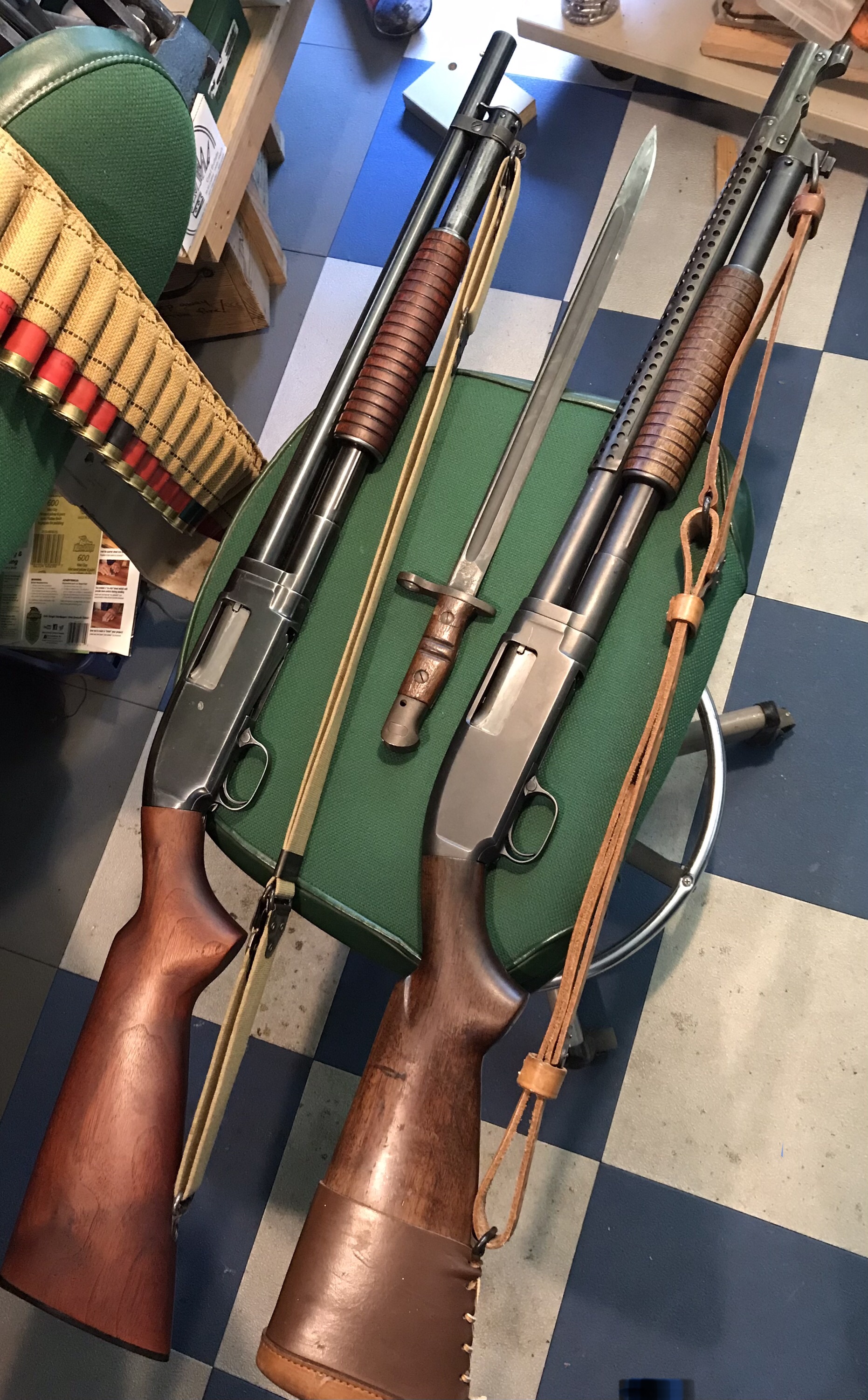

    I used Brownells cold blue on my M12 trenchgun [in the white] heat shield/mount. But Fords gunsmithing is in Florida. I can’t imagine they couldn’t blue it for you. Your pix isn’t very good but they would probably do your whole ‘97. Good luck on your build.
