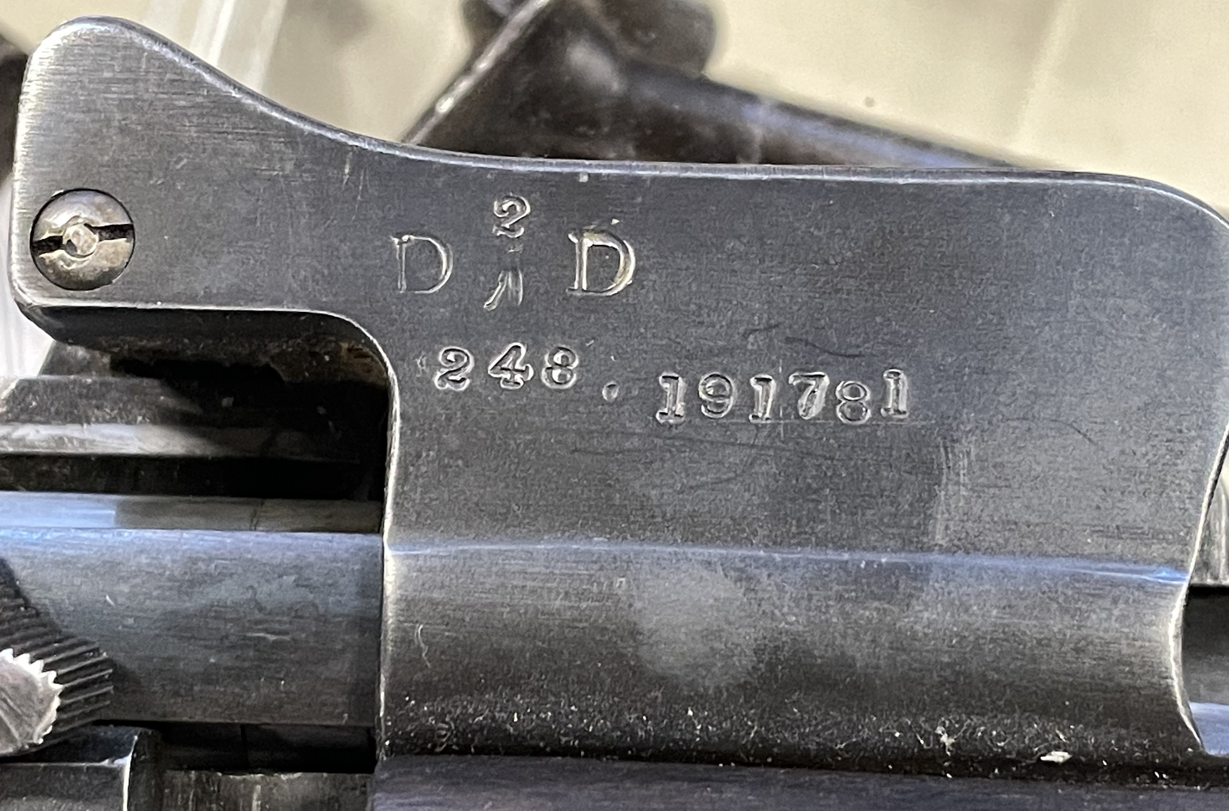

    On the right side of the rear sight housing, the rifle’s serial number was stamped, without the “W” prefix. From what I can see in a research database that I have created of Patt’14 (T) serial numbers, the “W” prefix for the relocated serial number was only added on the Irish Contract rifles. Added in front of the relocated serial number on this example is a three digit number separated from the main serial number by a period. Above this number combination is the 1926 and later “D/|\D” Australian Government property mark. Above that is a “2” indicating 2nd class stores.
    2
    D/|\D
    248.191781
    I believe that this translates as rifle W191781 and assigned Australian number 248.
    Skwan’s Patt’14 Mk.I* (T) has prefix number 260. If I am correct, this suggests that Australia had at least 260 Patt’14 Mk.I* (T) rifles on issue.
    This renumbering would be similar to New Zealand’s adding their own serial numbers to No.4 rifles that they held. It is also similar to the common practice of armies to assign their own numbering system for vehicles, rather than using the manufacturers’ serial numbers (VIN) which can vary drastically in length and composition. Britainicon with its WD number in WWII, Canada with its DND numbers and later CAR and CFR vehicle numbers, Australia with its ARN etc.
    Research is ongoing.

    Colin, would you mind showing how the original F-Sight was modified that you had replaced?
    Small detail I noticed, fine lines where the rifle serial number had been applied. Alignment for when they were originally stamped there. Interesting, had not seen this before. Makes me certain this rifle still has the original finish.
    Additionally, would you mind showing the areas where the bases were installed?
