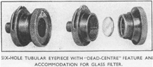

    Anyone have this PH4 rear aperture piece and lenses?
    I am attempting to find the physical measurements of the original filters that could be bought as accessories for this eyepiece:
    Asking because this optician can make lenses to fit that are either simply filters or providing eyesight corrections; just needs the dimensions of the originals and your optometrist's prescription if you want correction or even just a filter.

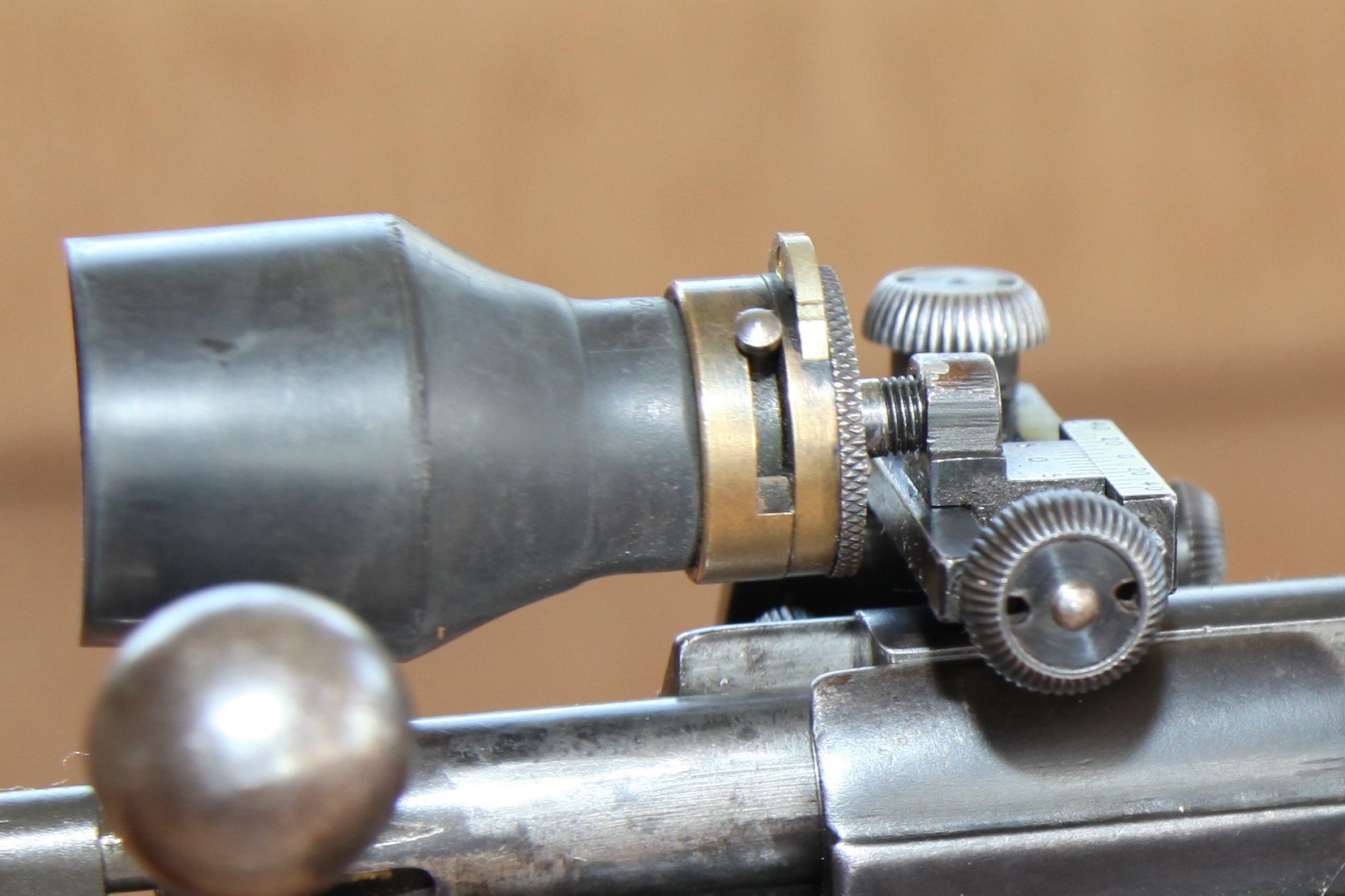

    I understand what you're trying to do. I have a pile of PH sights but have never found any of the inserts.
    However, if your goal is simply to shoot using the PH sight, GEHMANN makes a whole pile of lenses with variable apertures for target shooting. You can buy them with PH threads, too! Most combinations are less than $200 USD.

    I have a 530-PH that fits all of my vintage Parker-Hale sights, has magnification as well as adjustable iris:

    Well, what I'm actually trying to do is try that custom ground lens in that PH eyepiece: total cost $45. But thank you for the links, some of them I've patronized before.
    I am too old, too stiff, and too shaky these days to be a threat in any match. I just amuse myself here out in the sticks of Montana where I often have the range to myself, seeing how well I can do at distance with the No. 4 Long Branch. I do use the aperture adjustments in the flat eyepiece that I usually shoot with, and that definitely helps. But seeing as I have this one intended to accept lenses, we have a superb optician who specializes in competitive shooting whether with rifles, handguns, archery, etc, here just a bit south down in Missoula.
    I have my annual visit with her and the optometrist who works with her coming up, and she's told me to bring my rifle and sights when I come.
    For $45, I'll give it a whirl.

    Rather than rely on someone accurately measuring a lens, why not just give the company you plan to use to make the lens, your prescription and the sight and let them make it to fit ?
    A couple of things. First, the optician and optometrist that work together with competitive shooters (and their sights) to provide the best correction possible prescribe glasses; the archery sights they work with have lenses with a diameter of an inch or more. On the other hand, the business at the link above just wants to know what the dimensions of the lens have to be in order to fit and the prescription you specify be ground into the lens.
    By messing around with assorted shims, verniers, etc I can probably get close. And alternately the company that grinds the lenses might be agreeable to having the eyepiece sent to them and them mucking about to figure out dimensions.
    But easiest of all is if there's a collector out there with some of those filters who can just measure a sample and provide the measurements.

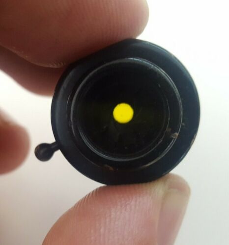

    That's J.H. Steward of Bristol https://jhs-eyewear.com/pages/jh-steward-bisley
    I seldom come across one of these with the lens still in but I've got one of the coloured filters which is about .411"

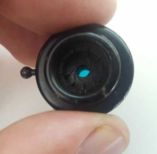

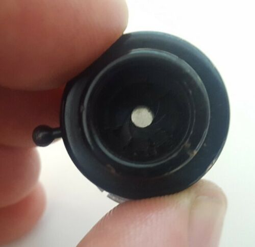

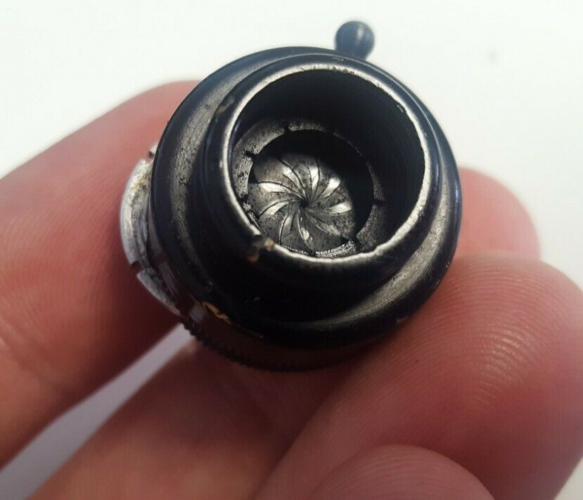

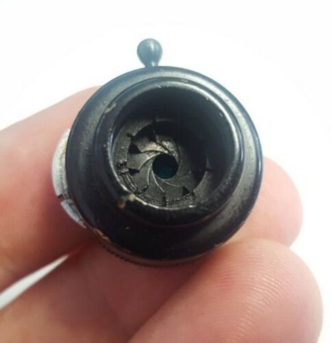

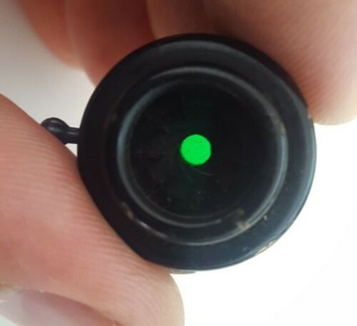

    They manufactured a superb eye-piece that fits into PH target sights.
    The one I have not only has the 'iris' that allows infinite aperture adjustment but has coloured filters to cope with sunrise / sunset, misty/foggy light etc etc.

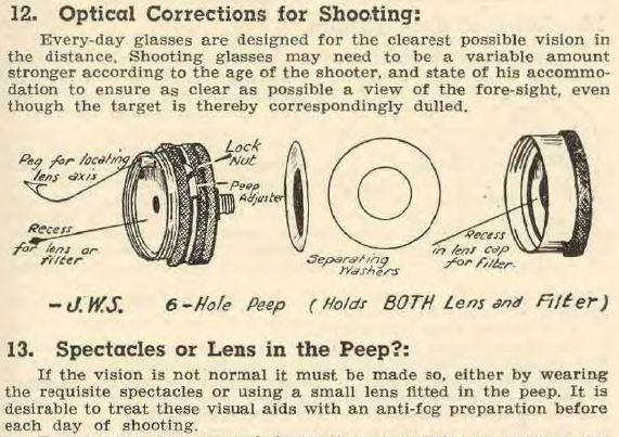

    Quote Originally Posted by Rick View Post
    I would like to get my hands on some edition where his focus switched from the No. 1 to the No. 4, however briefly. Perhaps something in the middle of his editions, something like the 4th edition of that book?
    I have the 3rd edition if thats any help.
    Dated 1948 but seemingly no reference to the No4 rifle.

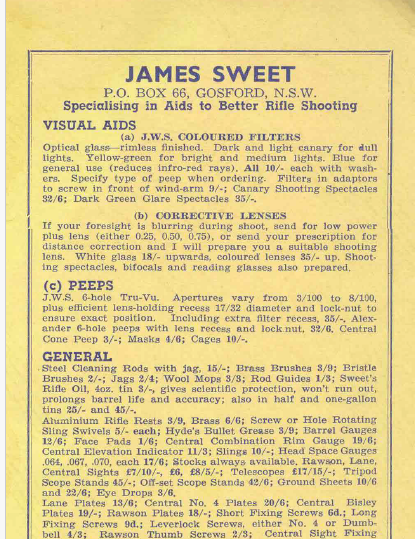

Name:	JH Steward advert.png‎
