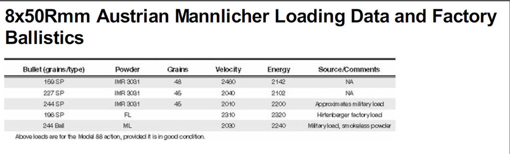

    Here is a copy of the 8x50r data for smokeless powder I have for the original 1888/90 rifles (sorry about the crappy quality of the image). I have not used it (loading 8x50r is one of my next projects) but I will be soon.

    Thank 'ee kindly young sir, I shall have to think about how far back I should reduce the size of load. I am pretty sure these are for a good M1895 rotating head bolt despite the note at the bottom. 35 grains seems not unreasonable at first thinking. IMR 3031 is a match to Tu3000 I am told.

    Well it says 45grns of IMR 3031 for a 227grn bullet, and that it is for a 88 action. I honestly believe most the data which is for the later M90/95 action would also be acceptable for the 1888 action simply because they didn't manufacture a special type of ammo just for the earlier actions (and later on they made the higher pressure 8x56r for the M90/95 action to get its full potential). If it was me, I would try a 40grns of IMR 3031 and work up.
    I have used IMR 3031 for .303 Britishicon with great results. It is a faster burning powder which usually gets used in stuff like .30-40 Krags (actually where I got my .303 recipe), and .30-30 lever actions. My load for .303 British is 32grns of IMR 3031 under a 150grn bullet, which brings me right on at 100m, so that gives a idea where it is at with the lighter and smaller bullet, and smaller case capacity.
