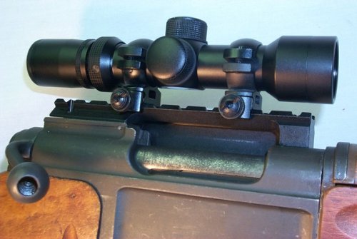

    Can a scope be mounted?
    What kind of accuracy can one expect from the 1936?

    Not so much windage adjustment here. Generally you drift the front.
    Have never seen a scope mounted on a '36, but I reckon it's possible. The FRF-1 has a scope on top, so...

    Amazon has a scope mount for the MAS 1936...
    http://ecx.images-amazon.com/images/I/41UwTlfz8AL.jpg

    If it's a BSquare thing, then you're probably better off using the iron sights.
