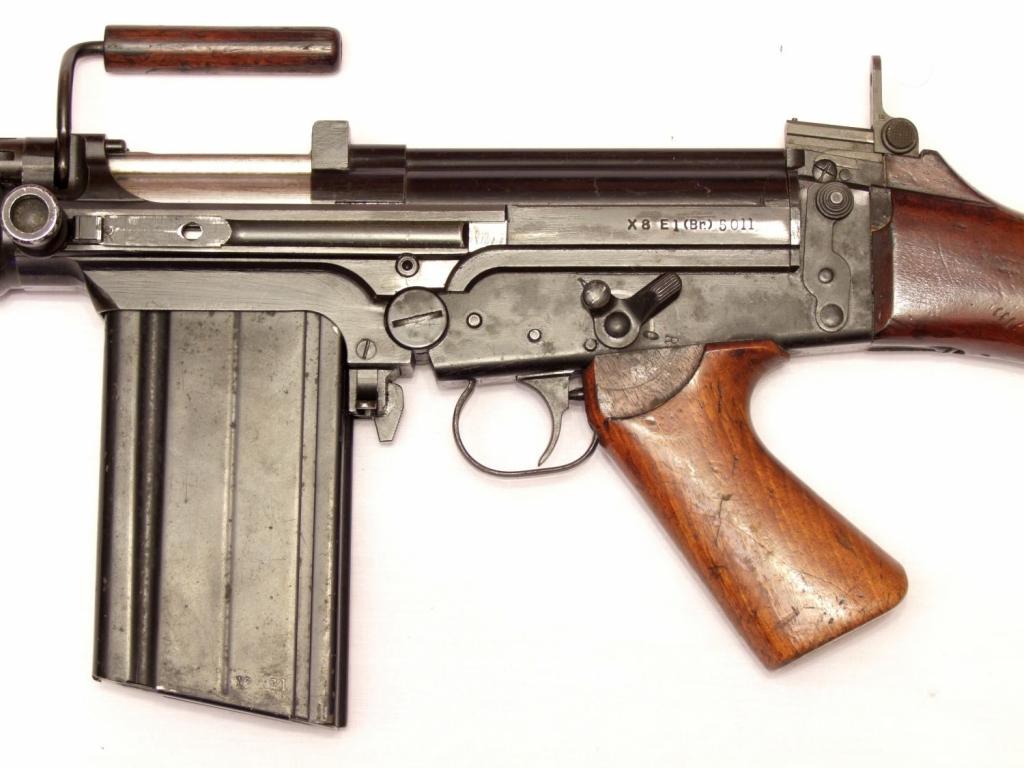

    This rifle was in use for about 18 months (1954 - 1956) and had Its barrel replaced after 10,407 rounds and has fired a total of 17,320 rounds after which it was returned to RSAF Enfield due to the Body (Upper Receiver) cracking through the Locking Shoulder hole.
    I know this as the rifle has its own official report: T.S 56’ 100, RIFLE FN No 5011, Investigation, Fractured Body
    The report details the life and use of the rifle. It was sent to Radway Green and was used for “Ammunition Proof”.
    Although it doesn’t say when the rifle started trials it was withdrawn from service on the 6 November 1956 after it was gauged and failed.
    It’s likely the rifle spent about 18 months in service at Radway Green, which works out at about 509 Working days. This can be further broken down to:
    A total of 866 Magazines (20 round) used.
    Or 48 Magazines / 962 rounds a month.
    Or 34 Rounds each and every work day
    It had a hard life in its short operational career.

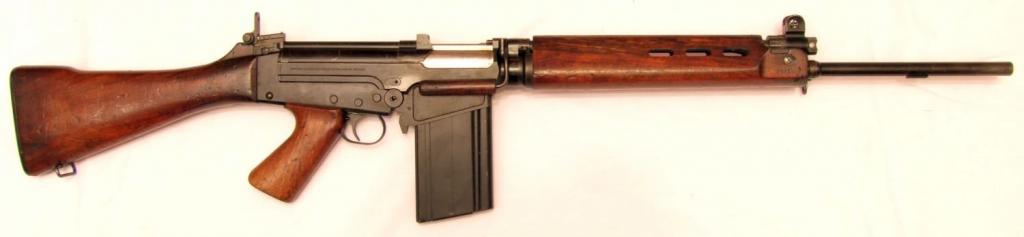

    Many in Britainicon were converted to L38 Drill Purpose and used and Hereford for the country walks during selection,
    the one I have was fitted with a "para" type rear sight when I got it dressed as a deactivated L1A, I believe the rear sight is original to the X8 as it has the same patina of the finish
    . I have since found all of the missing parts, with 2 sets of wood to make it look like an X8 or the L38 DP

    The para sight isn't original, this type of sight didn't come into existence till the early 60's. It would of had the standard TALL backsight, if you tried to use the para sight with the original front sights you wouldn't be able to hit the side of a barn from the inside. I suspect the original TALL sight was damaged and then replaced with a para sight taken from one of the Argentineicon Para FAL's brought back from the Falklands. Also it looks like your rifle has had a coating of Suncorite at some stage.
