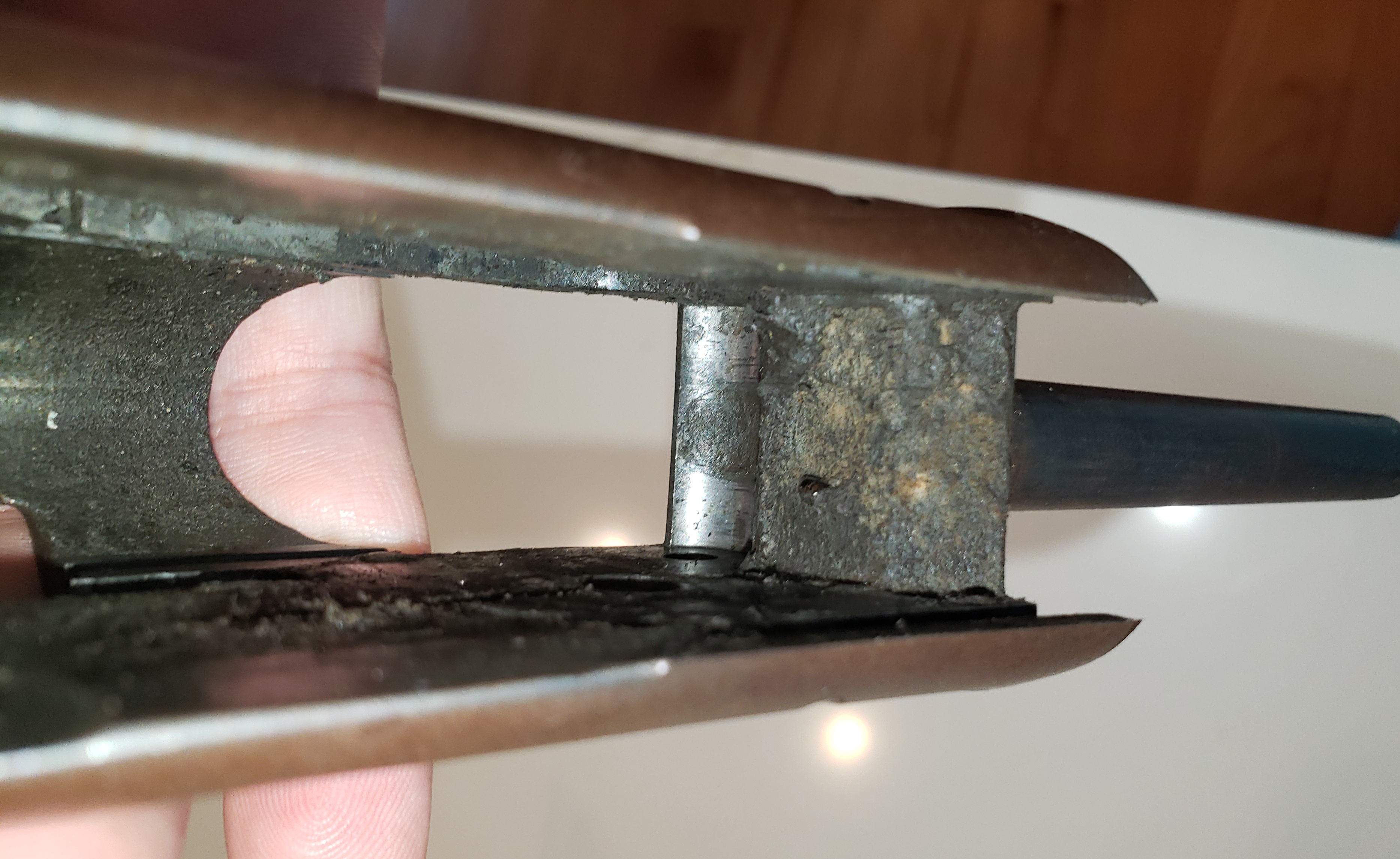

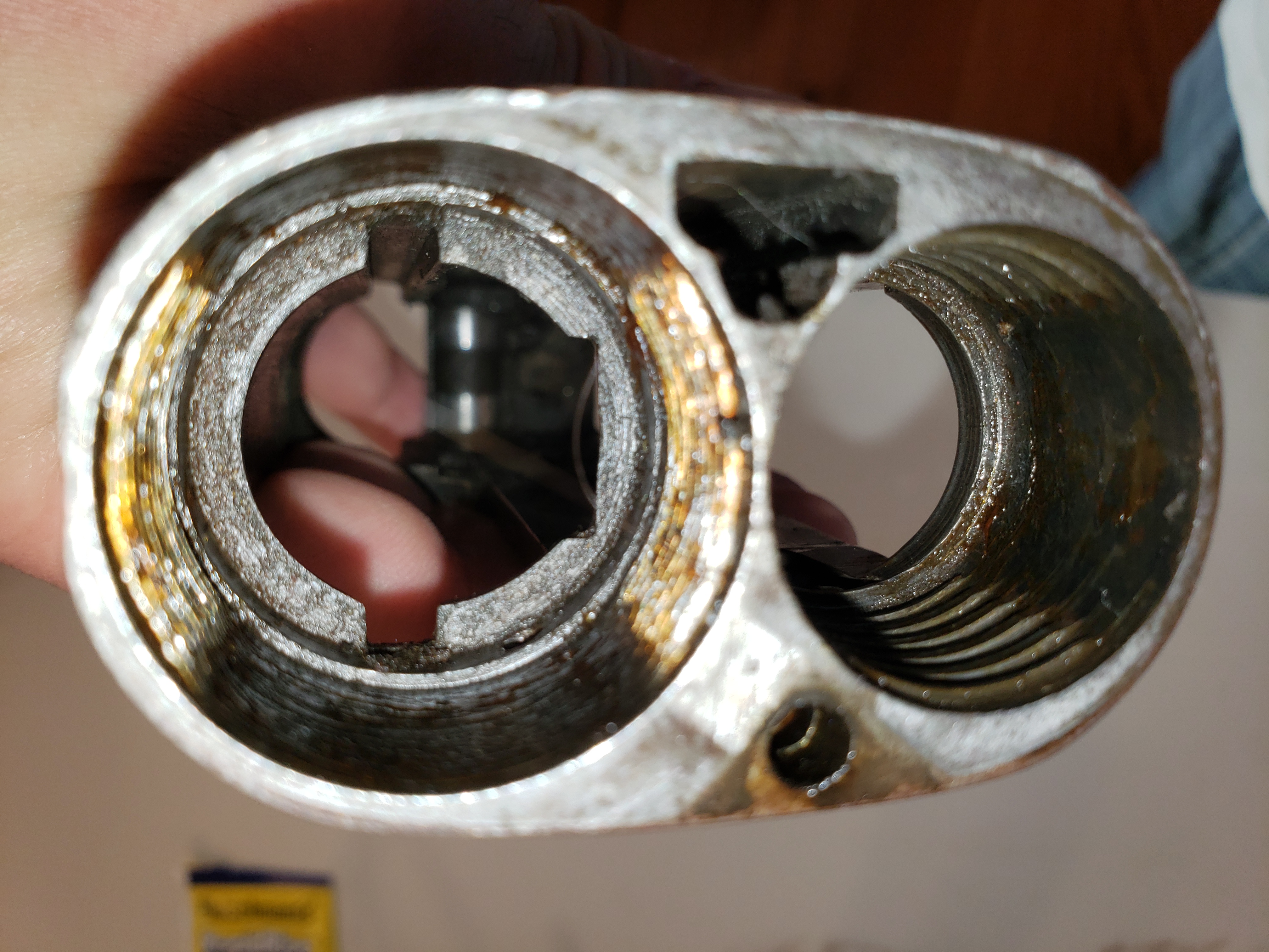

    Here we go! Still has matching serial on the extension and original 30" full choke. 739xxx, early 1924 according to https://www.winchesterguns.com/conte...ture-dates.pdf. Forend was very loose and already on it's last notch. A swap of the adjusting sleeve cured that problem.

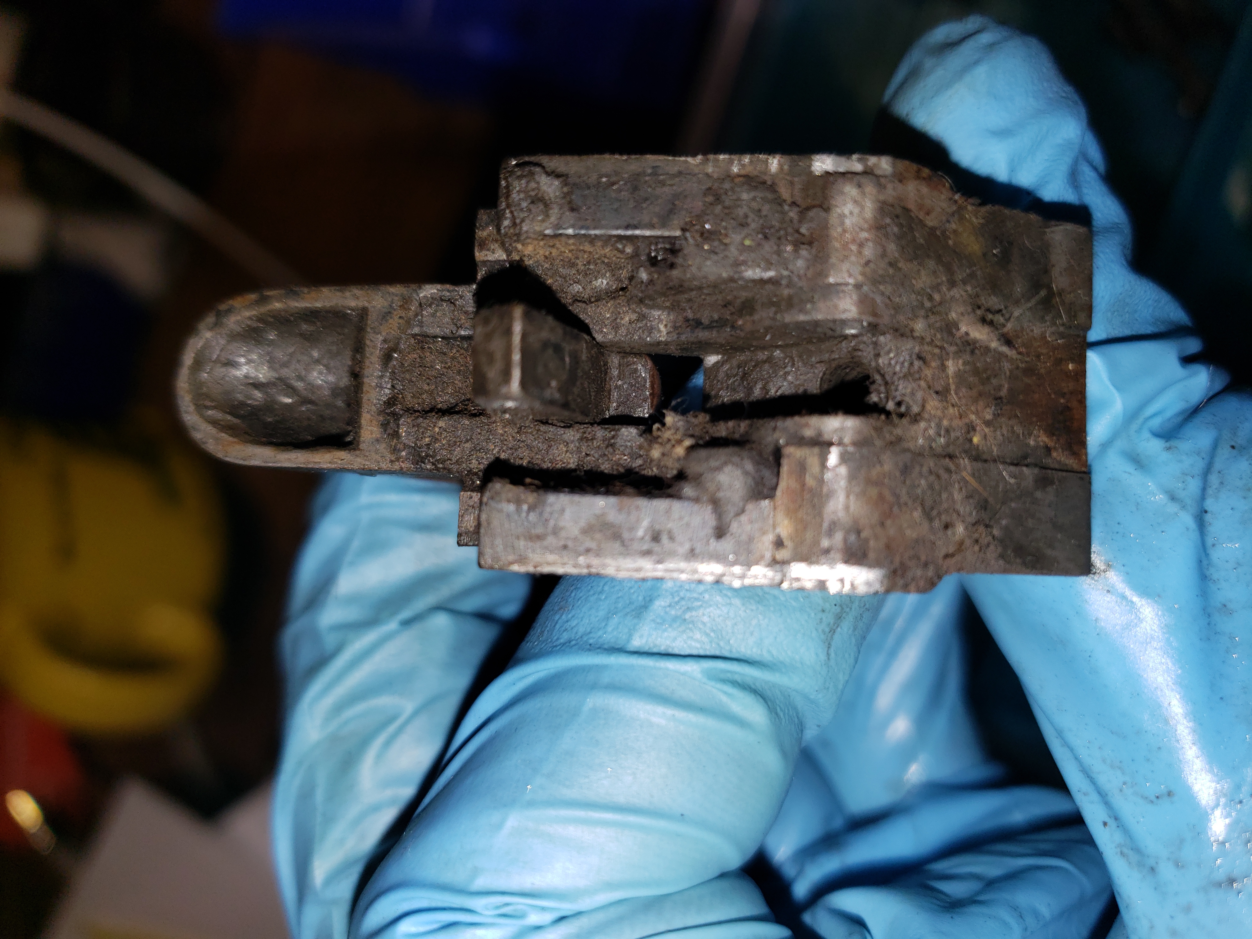

    The last one I just finished was far worse off - bent and dented barrel, broken extension. This one's major defect is that it's just plain filthy. Filthiest firearm I've ever encountered (including the mosin's I've done - one that appeared straight out of the sewer and another still packed in cosmolineicon).
    Lot's of old dried grease/oil mixed with carbon/dirt/dust/sand forming a concrete in every corner, under every spring.

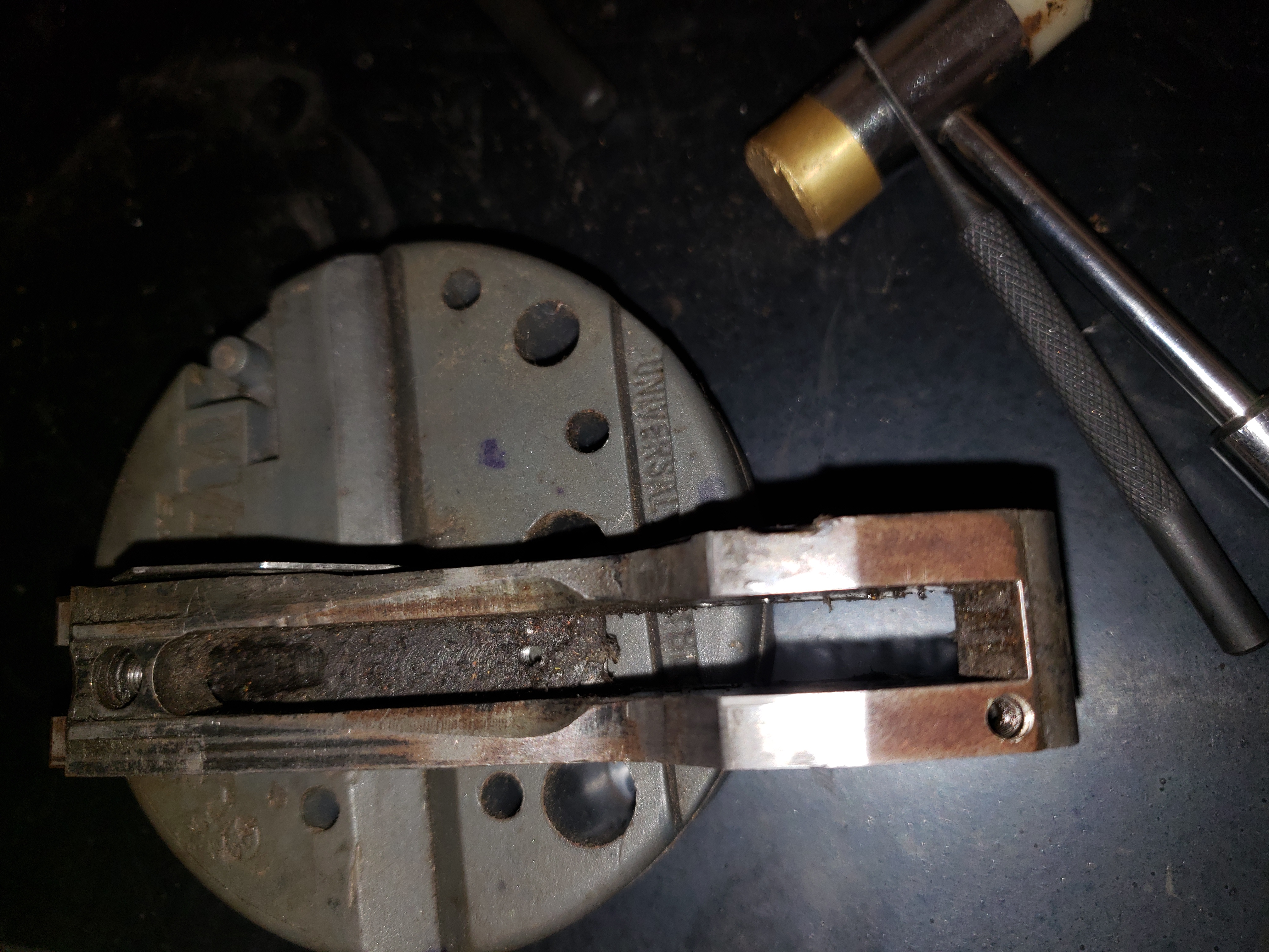

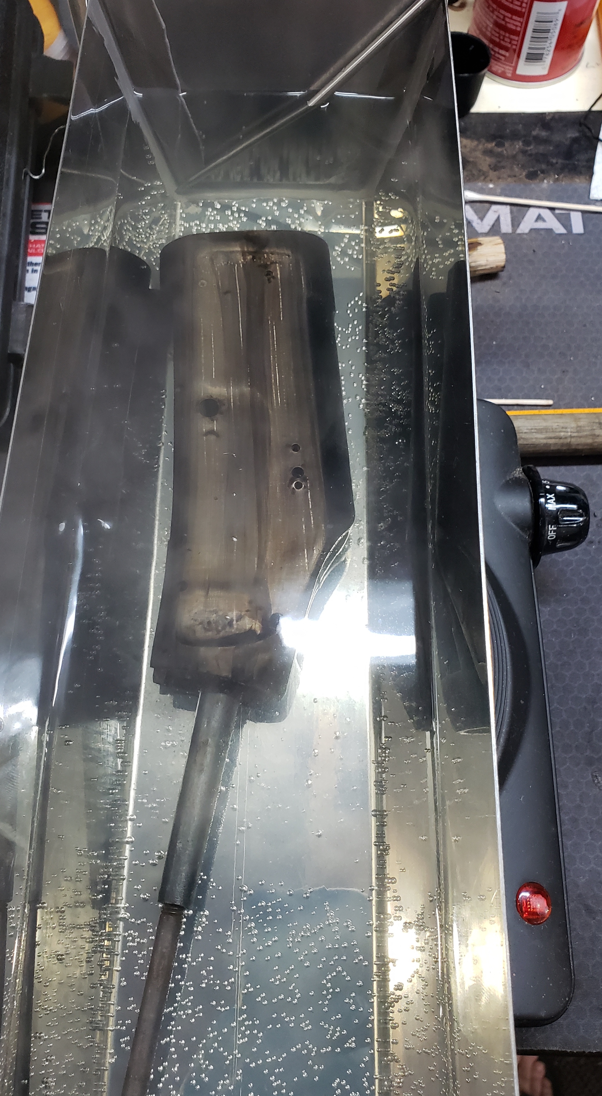

    The consistency of grime changes with likely exposure during storage. Areas around the bolt and front of the carrier are a loose mix of dust and grease, forming almost like a soft packed felt substance. In the rear and along the sides, its rock hard and gritty. Brake cleaner wouldn't touch it. After a soak in wd-40 followed by a brass scraper to chisel out the worst of it, then a brass brush to get the rest of major deposits, I have it all boiling in water to get the remainder - while I prep the receiver for rust bluing.

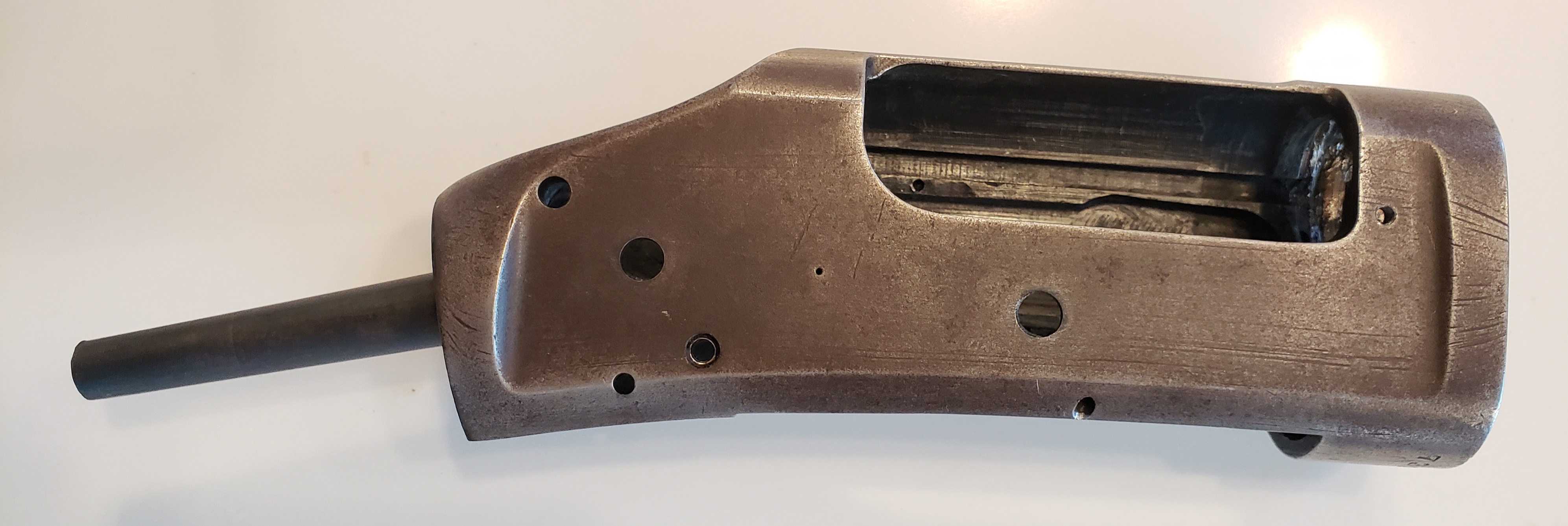

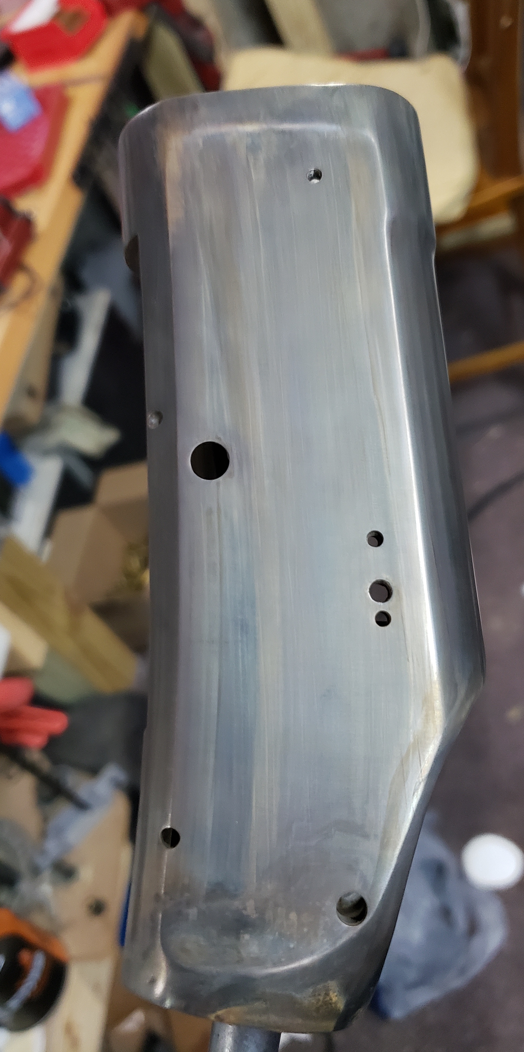

    Note the deep striations in the outside receiver. I saw these in the last 97 project, although they hadn't worn as deep as this one. From my experience there, these are caused by the metallurgy of the receiver. They present a challenge in bluing to get rid of them. I'll capture this in my next post.

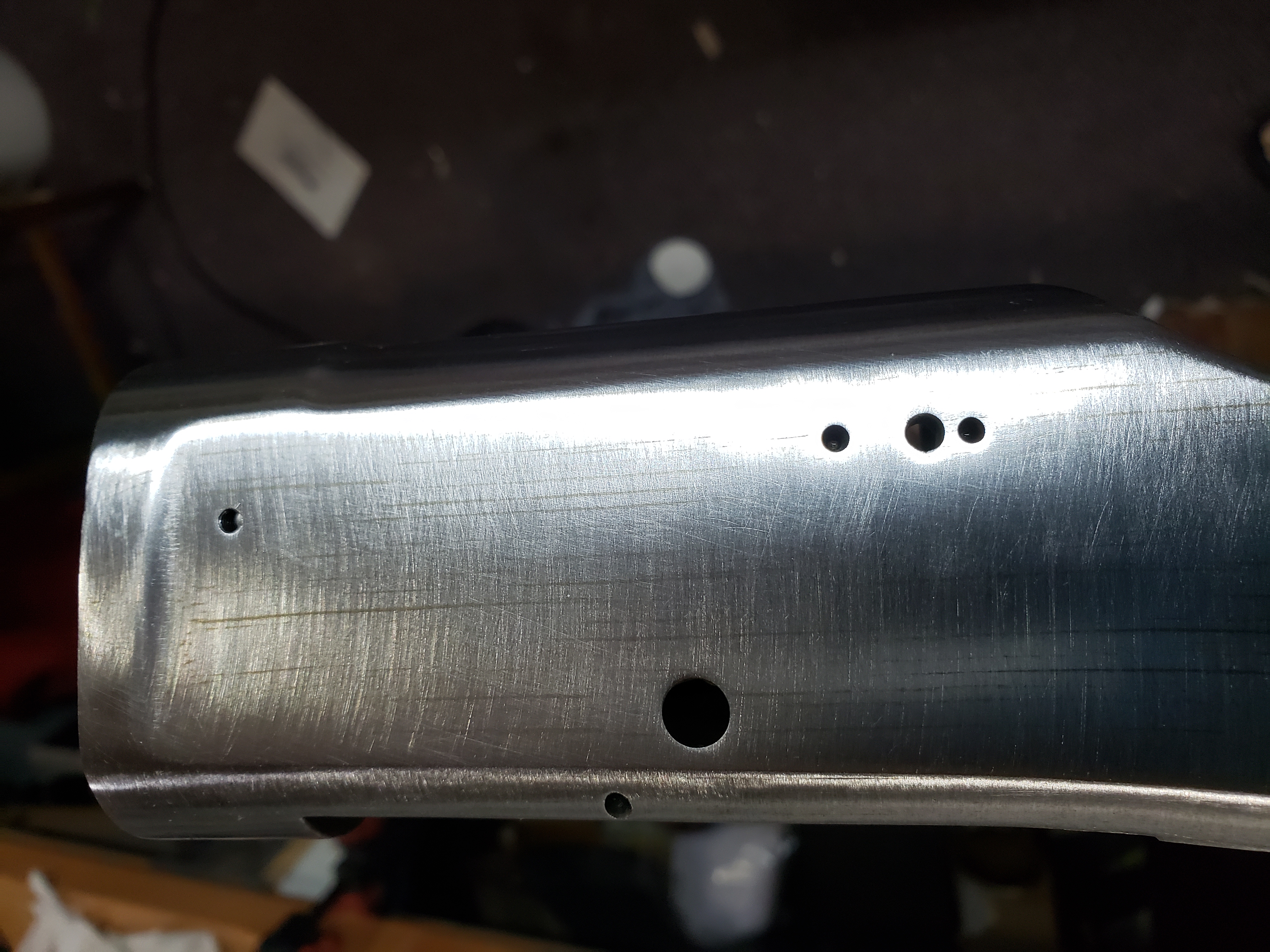

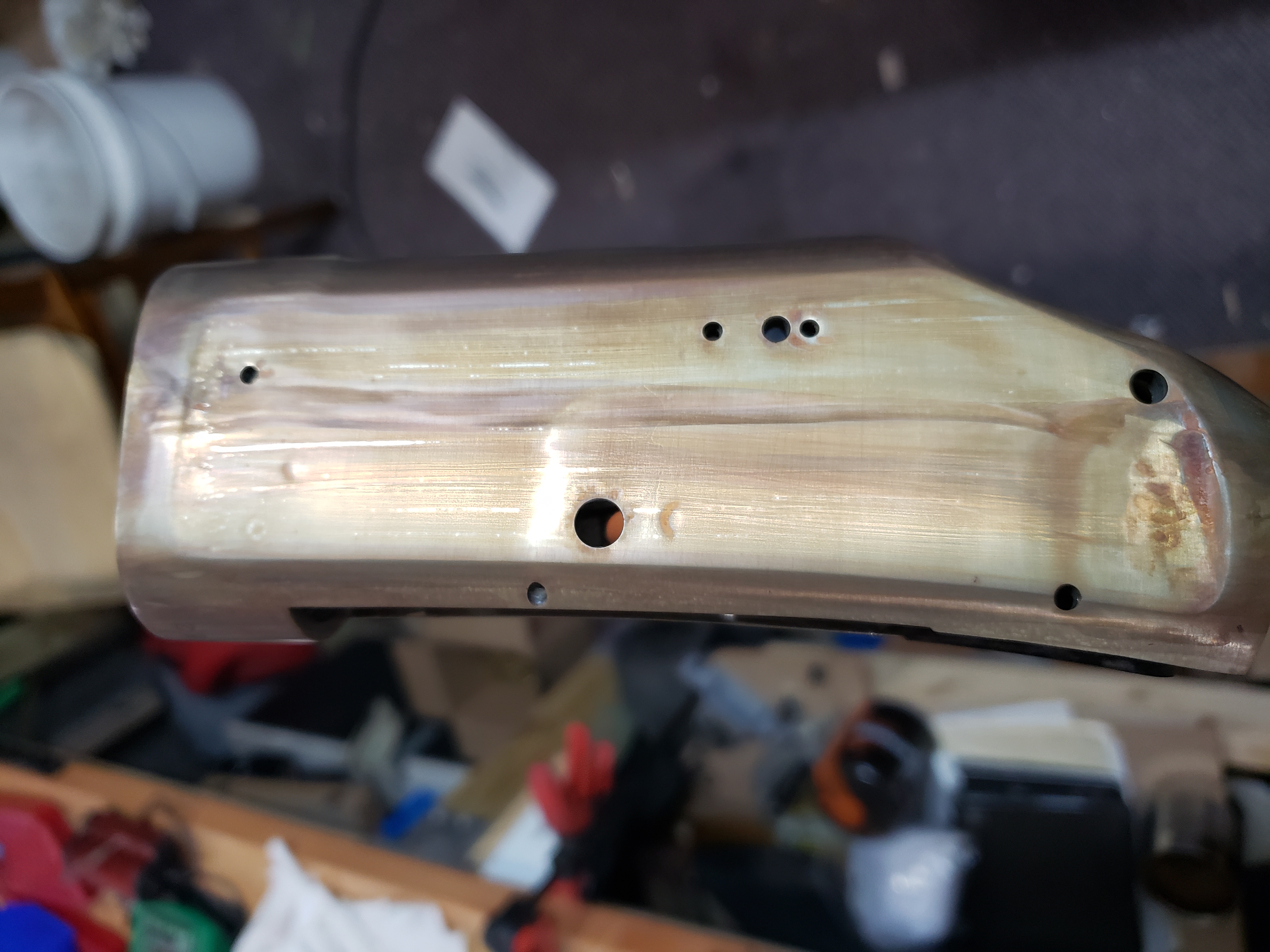

    So the topic I promised was rust bluing with these "flaws" in the metal that was producing the striations which wear faster than the surrounding metal, and then look like long deep scratches after 100yrs. After lots of trial and error with the last 97, this one went along pretty uneventful.
    as soon as you degrease, these lines flash rust, deep and fast. Don't worry. just don't let it sit - go ahead and wipe on your first iteration.
    I'm using mark lee's express blue no. 1. you can see the striations aren't playing nice. Just ignore them and keep going

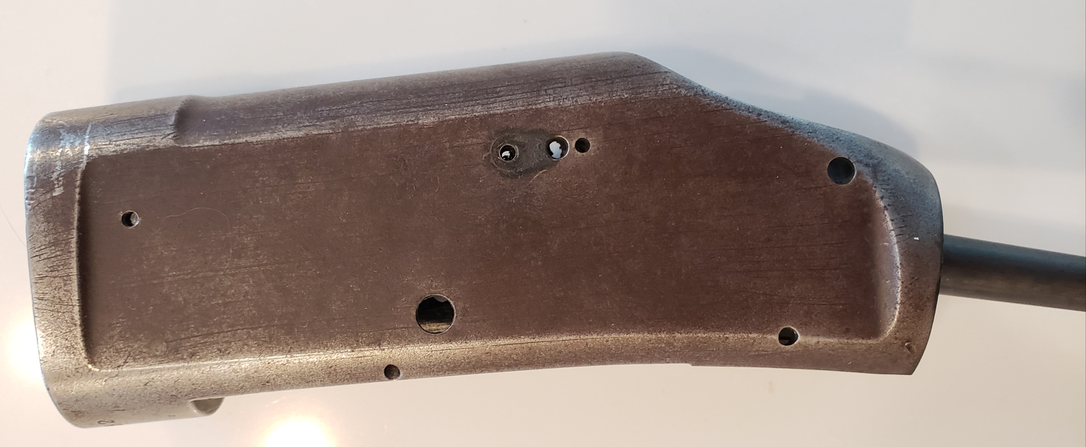

    it gets worse in the boil. now, when it comes out and after carding, grab a square of clean paper, and lightly go over the area until the lines disappear. In my initial prep, I usually finish with a piece of worn paper, so I go one step of finer grit this time so there is nothing that stands out. The etching of the rust process will make any variation irrelevant and unnoticeable in the end, so long as you finished at ~320grit or beyond (depending on manufacturer of the paper. no benefit to going finer than needed. 400 seems to be a good number that works across many brands, even the cheap stuff.) You can't see it, but there is just barely enough magnatite over the striated spot to keep it from flash rusting again, so at the next application the striations catch up.
    here we are after the second application, just before boiling.

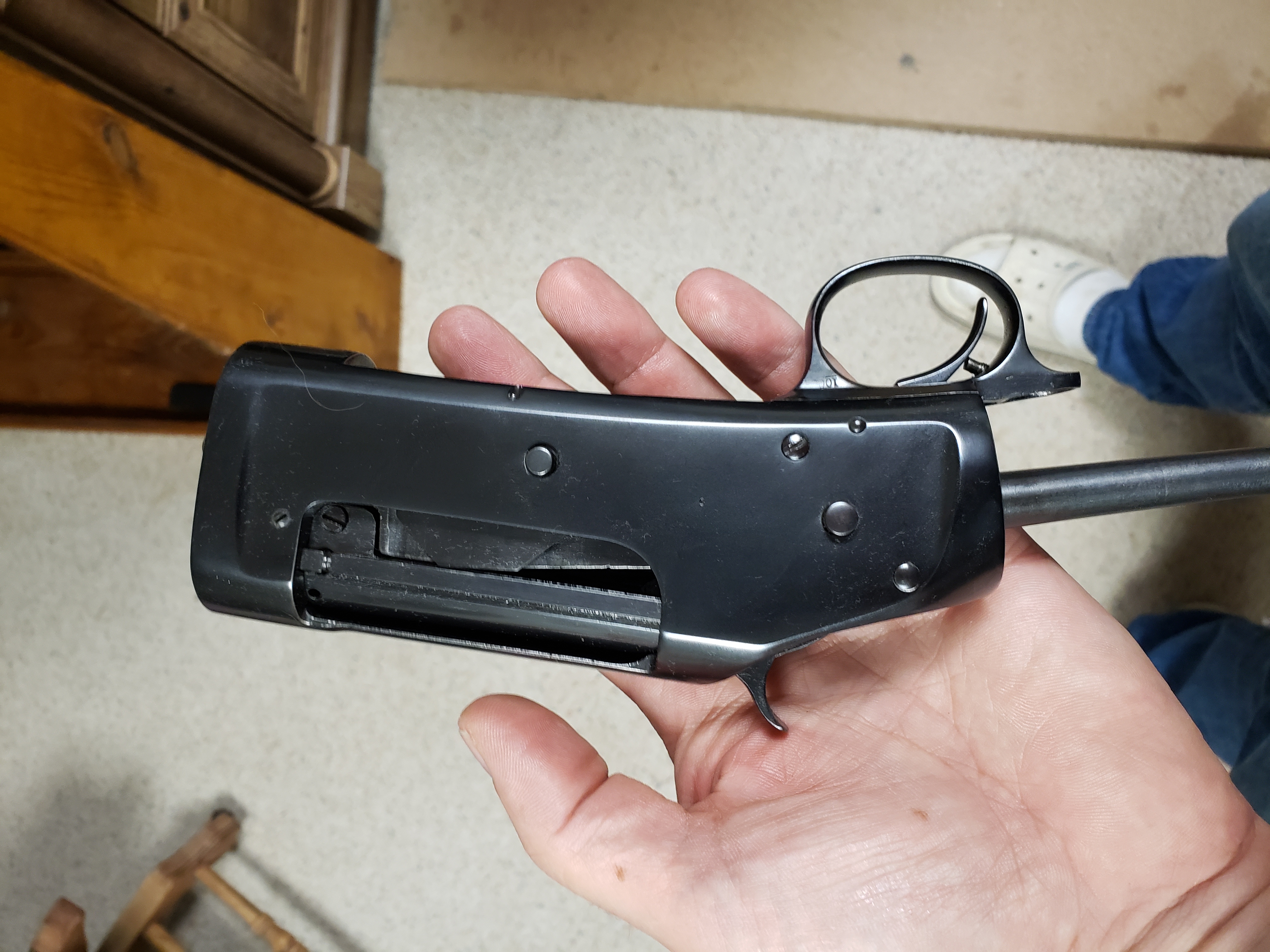

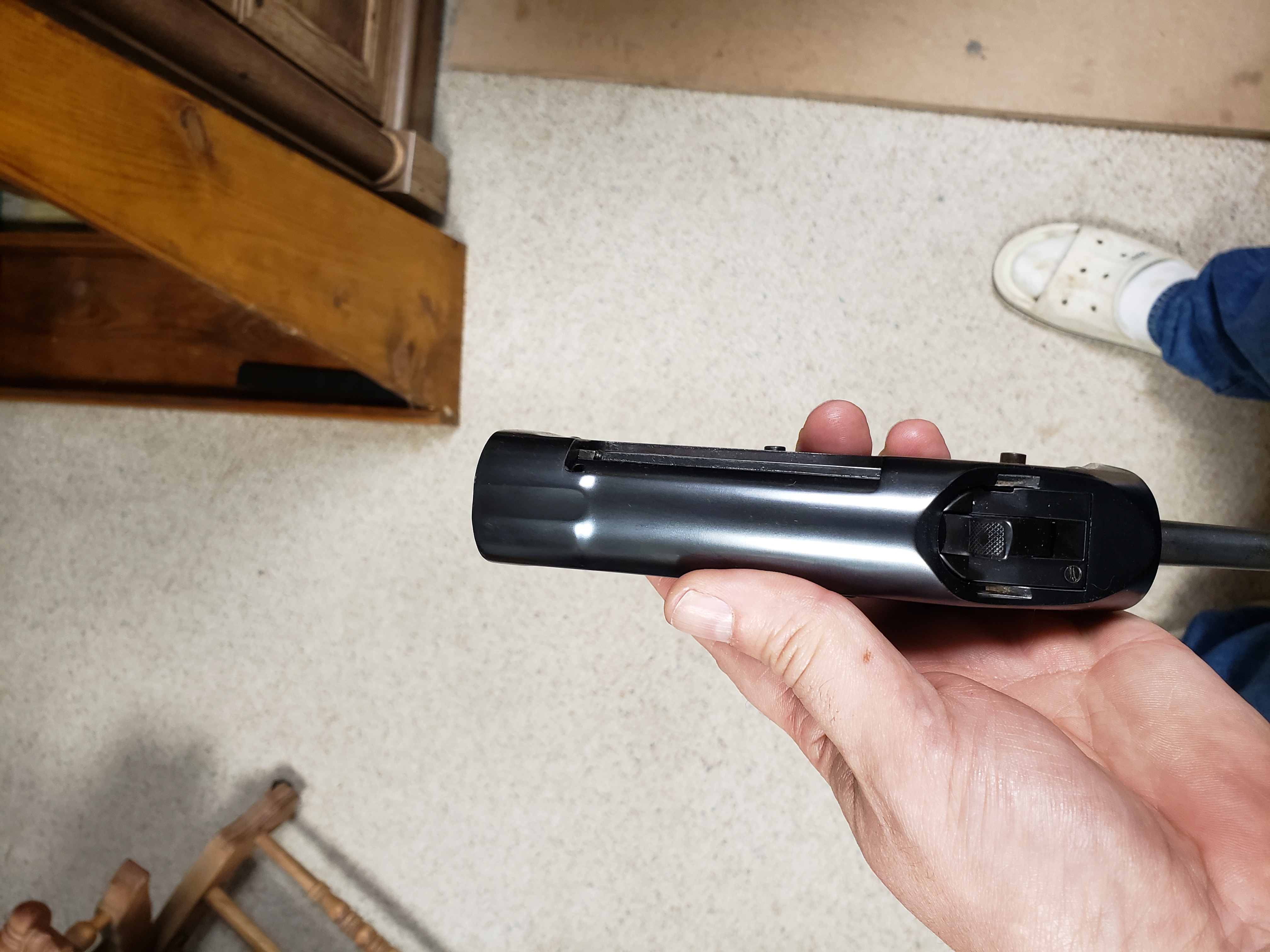

    here it is.
    There was some prior moderate corrosion top front that made the oval-pw stamp pretty faint when it was all done, even though I tried to be as delicate as possible to that area. It's still there, and stands out if you hit the light at just the right angle.
