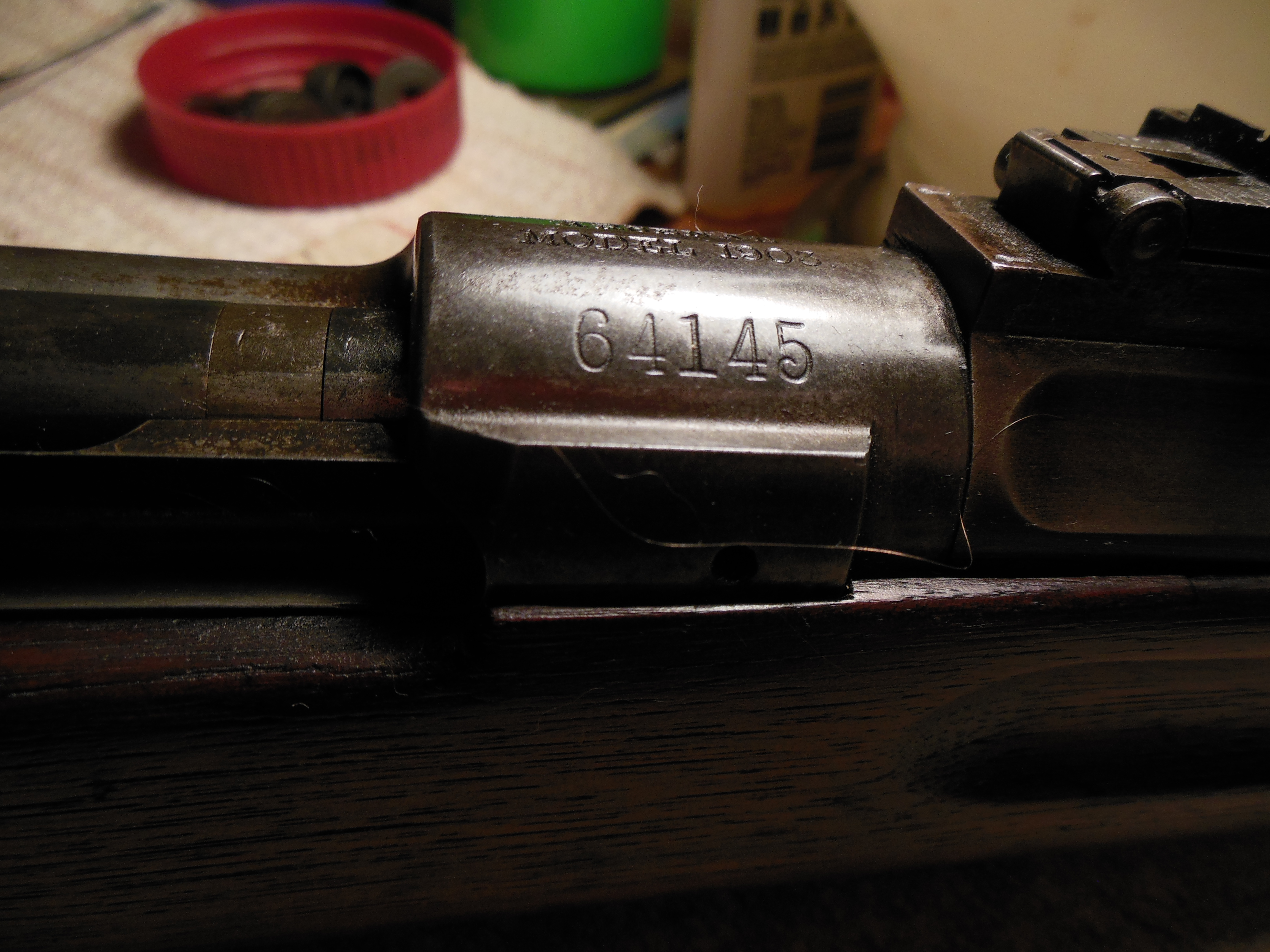

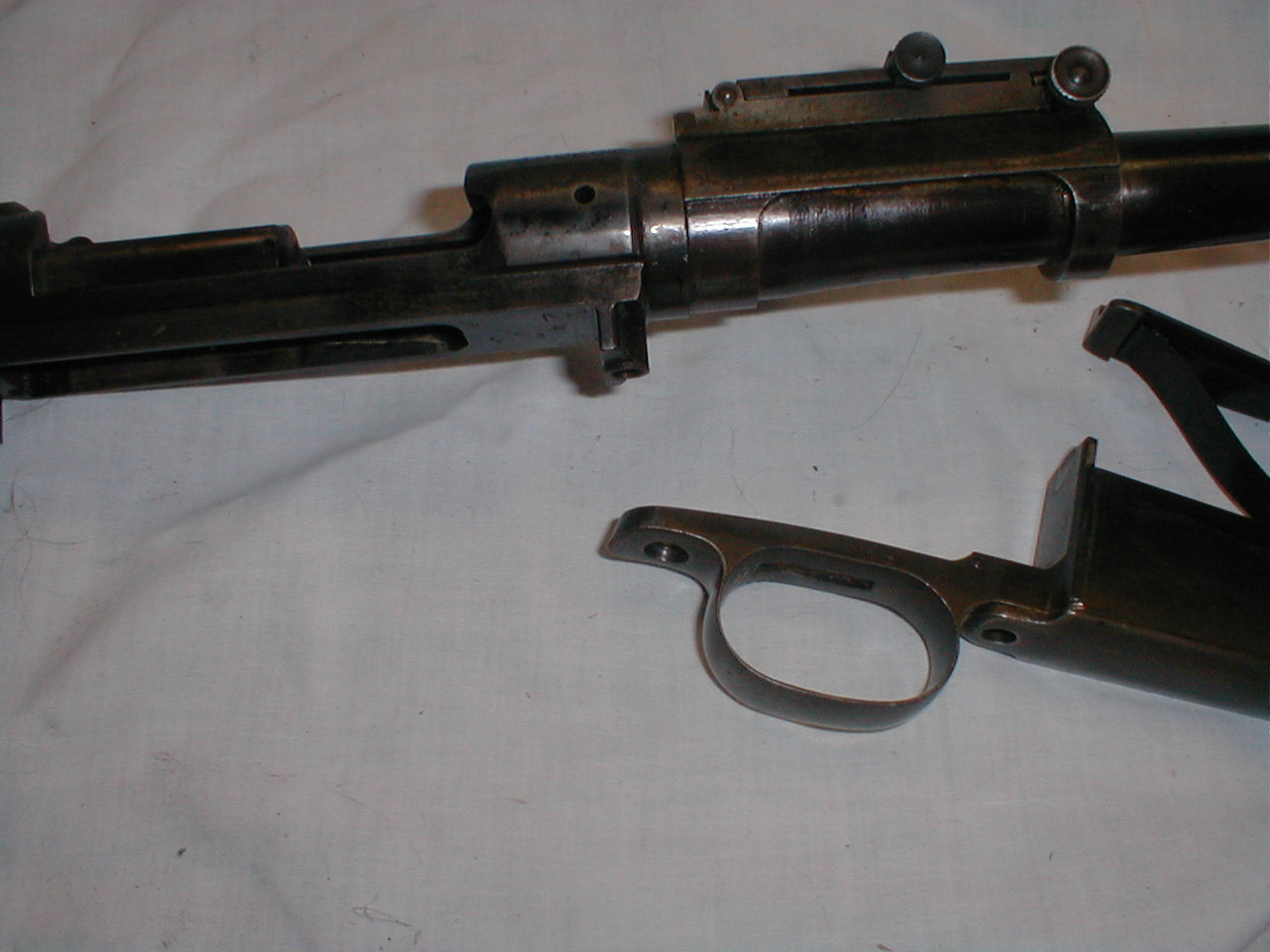

    original finish
    Rock Island serial number 3576 was refinished as outlined in post #2
    here are two more "blotchy" originals

    They are beautiful rifles — RCS, is the previous upper band hole from its original rod bayonet configuration? I believe the blotchy appearance is due to faded case hardening and oiled rust/patina— same as the Kragicon. When the rifles were rearsenaled/updated prior to WWI the process may have included “browning”/rust bluing some of the case hardened parts and sometime in 1918 the process was changed to parkerization.
